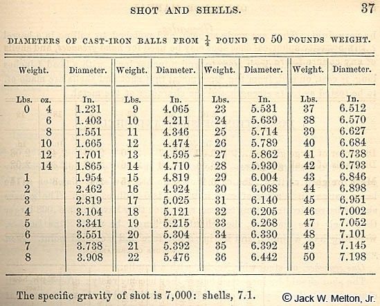

I found the table I was searching for!!
I thought the table included a Size Number. This gives a comparison of Weight vs. Diameter.

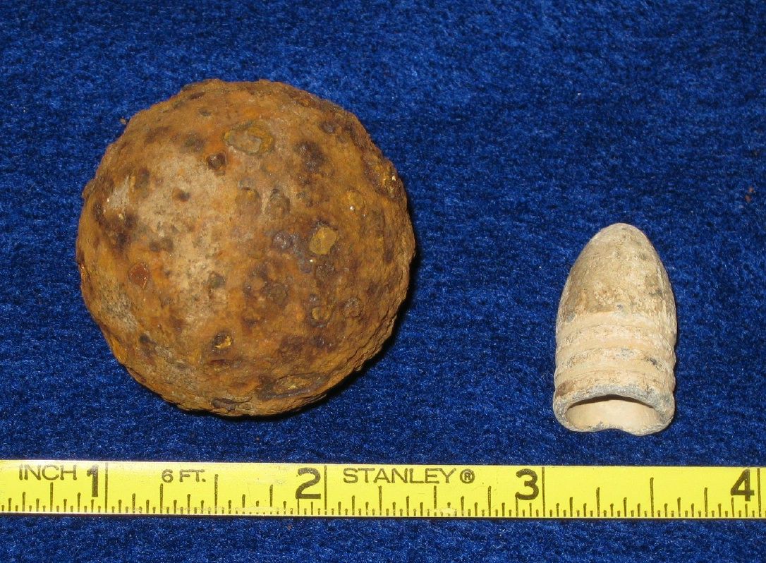

Here is one of the crusty cannon balls found here.
Rusty cannon/grape/canister balls are my favorites...
