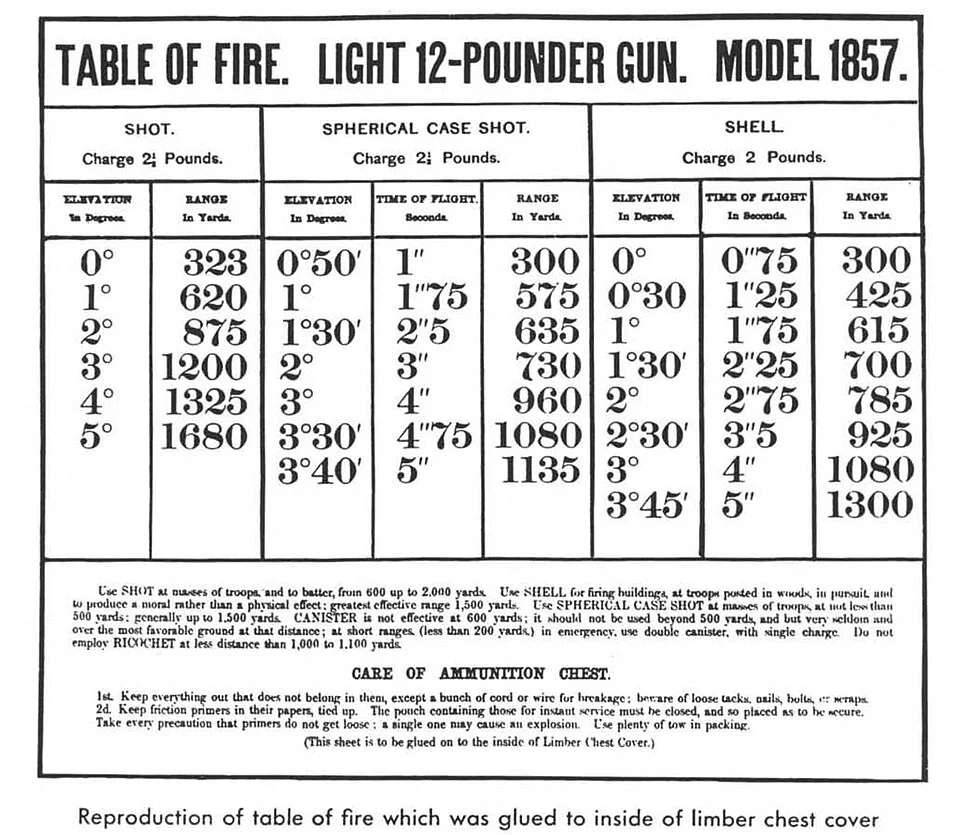

I had meant to include this citation because it clearly indicates the cone or dimple shaped breech of a howitzer. The powder bag was attached to the wooden sabot. A cannon's breech is the same diameter as the bore.
