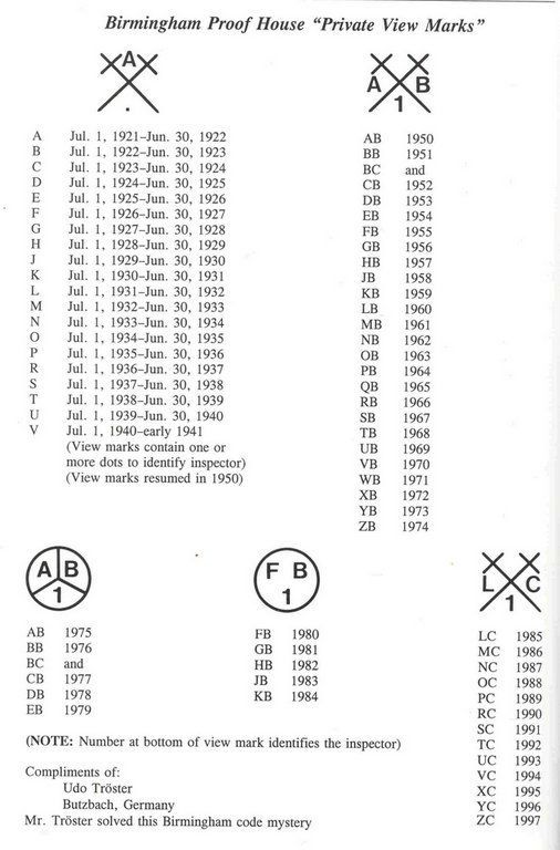

I also recently picked up an early Parker Hale Enfield. It, too, was/is in great shape. There are some dings and scratches that indicate it had been handled. I don't think that it was ever fired, though, so I fixed that. ;-) I have hoped someone here could help me date it. The serial number is 2825. The proof mark on the underside of the barrel is circled A\4/B. Any thoughts?
To date your PH, contact Dave at researchpress.co.uk with the stamps on the underside of the barrel
The meaning of the various British Birmingham proof marks, which varied in form somewhat from time to time, can be found here
