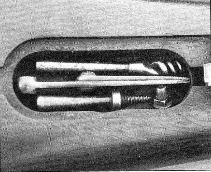

I have the 1859 Sharps carbine and diligently searching for an original stock with patch box. I have one rusted but soaking 1841/42 Springfield tool. Would this tool plus the brass cleaning brush be all that would be stored in the patch box? Anyone have a pic with contents?

I remember the Mississippi rifle had a spare nipple in the box. There was a hole drilled for it. I would put the stuck ball remover and other cleaning stuff in there.
For the Mississippi rifle the patchbox was intended mainly to hold cloth patches, necessary when shooting round ball. It may have contained other small items as well, I don't know. The Sharps, being a breech-loader, would not be loaded with a patch unless you found a rammer somewhere. Maybe it held cleaning patches? I don't know.
The typical issue cleaning kit for most military small arms consisted of a combination tool, worm, and patches or tow. A cone pick was carried in the cap pouch. I don't know what tools were issued with the sharps in particular, but a wire brush is unnecessary for cleaning black powder firearms.

The M1841 patch box was designed to hold a spare nipple, M1841 musket tool, worm and ball puller.
The Sharps patch box will hold a small oiler or the carbine brush which was a brush on a string. Designed to be used like a modern bore snake.
The M1841 tool will not fit in a Sharps patch box. The musket tool for the Sharps would be stored within the implement pouch of the carbine box worn on the troopers hip.

I received my $20 tool (best deal so far), and could have provided a pic of it being too big for the Sharps, but I still don't have a stock. Dennis Brooks in WA said he'd send pics of the stock (plus other parts I need).
I did have to drop the block to use the tool to loosen the nipple.
