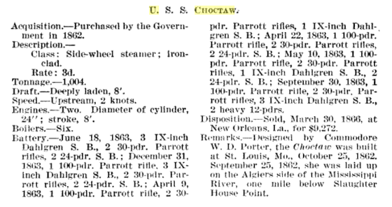

I would like to know more about the USS Choctaw's guns. Did her armament change over the course of the war? Where were her guns placed and what ports could they pivot to?

From the official records of the navies:
