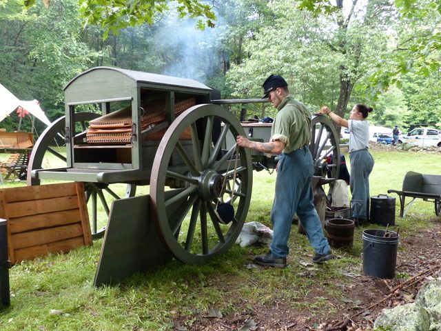

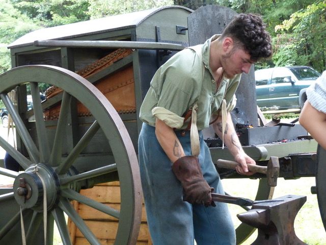

Here are three photos of a traveling forge I took at a reenactment last year in Hillsborough, NH. I've been going there for a number of years but I've never seen this before. They had an actual fire going and were bending horseshoes. But they would have been called up to fix anything - especially the iron rims of the wagon wheels.
Blacksmiths were issued Bituminous Coal. If you check any of the ordnance manuals, they list 250 lbs of bituminous coal as carried in the coal box of a Traveling Forge (search on the word "Forge" if you are looking for specifics in the online Official Records of the...) . Charcoal burns up quickly, so a great deal more would be needed if charcoal was/is used by a blacksmith. That would be a lot more bulk to carry around. Traveling Forges were equipped and assigned in two ways, Artillery and Field Park. Since I have not found references to Forges specifically put aside for Cavalry, most likely they were serviced by smiths servicing Field Park for use of everyone other than artillery.
