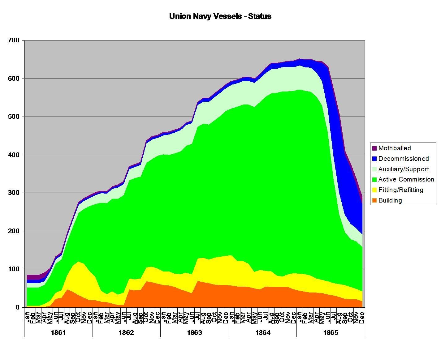

I posted a graph some time ago that gives an idea... I'll see if I can locate it.
A substantial portion of the U.S. Navy's growth was consciously temporary-- many of the 'converted' gunboats and contracted transports returned to civilian use after the war. There were indeed a lot of scrapped and mothballed vessels, though.
Found it!
Two things to point out here: you'll see that in late 1861, the proportion and number of ships in "fitting/refitting" status balloons, but not because of building-- this was the period where the principal growth in the navy was in civilian vessels being acquired and converted for wartime use. You will also notice that in the "nosedive" in 1865, a lot of ships are disappearing from "active commission" but the "decommissioned" and "mothballed" categories are not growing proportionately-- much of that is civilian conversions being sold back out of the navy, some to resume civilian careers, others for scrapping.*
