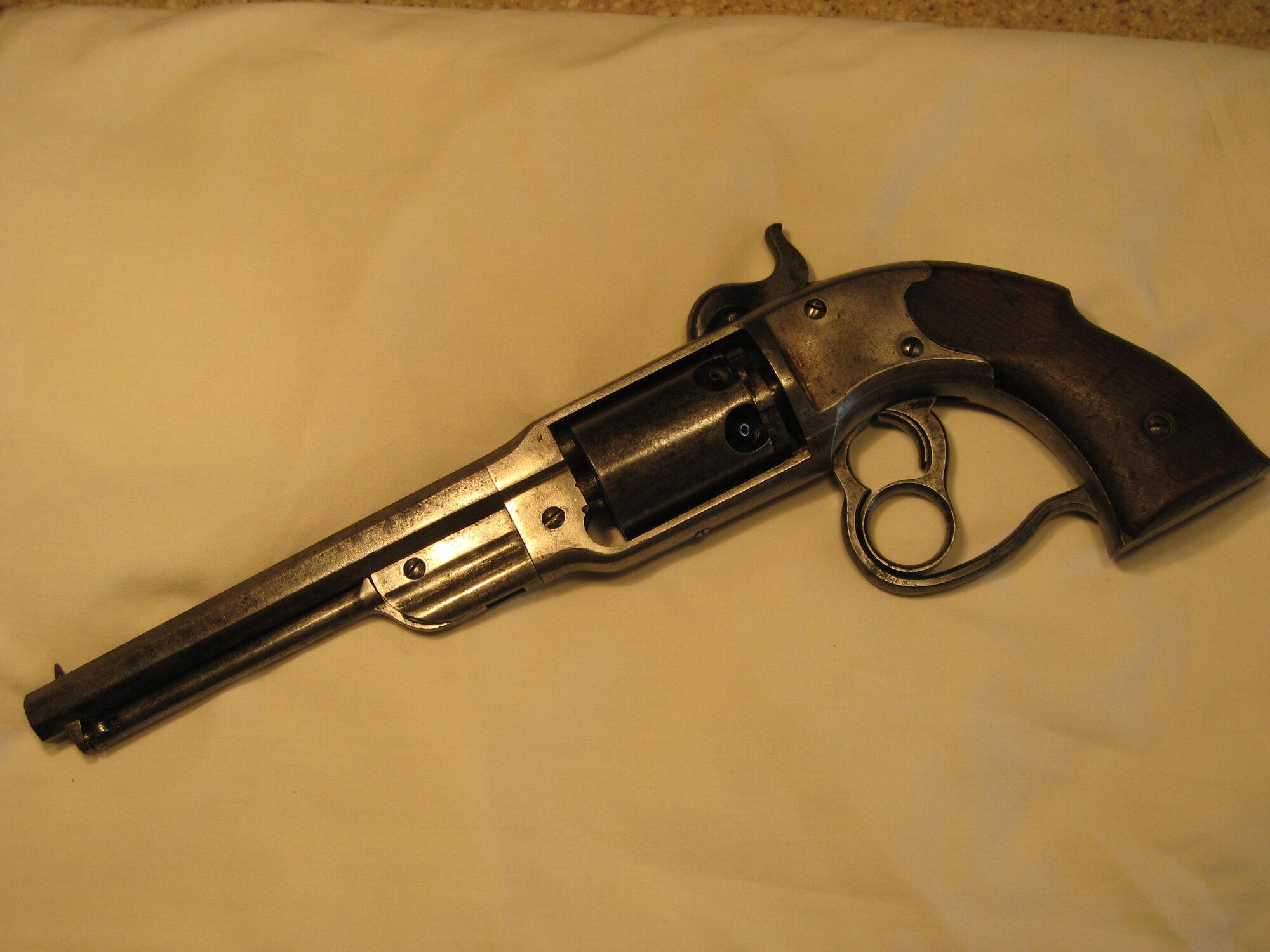

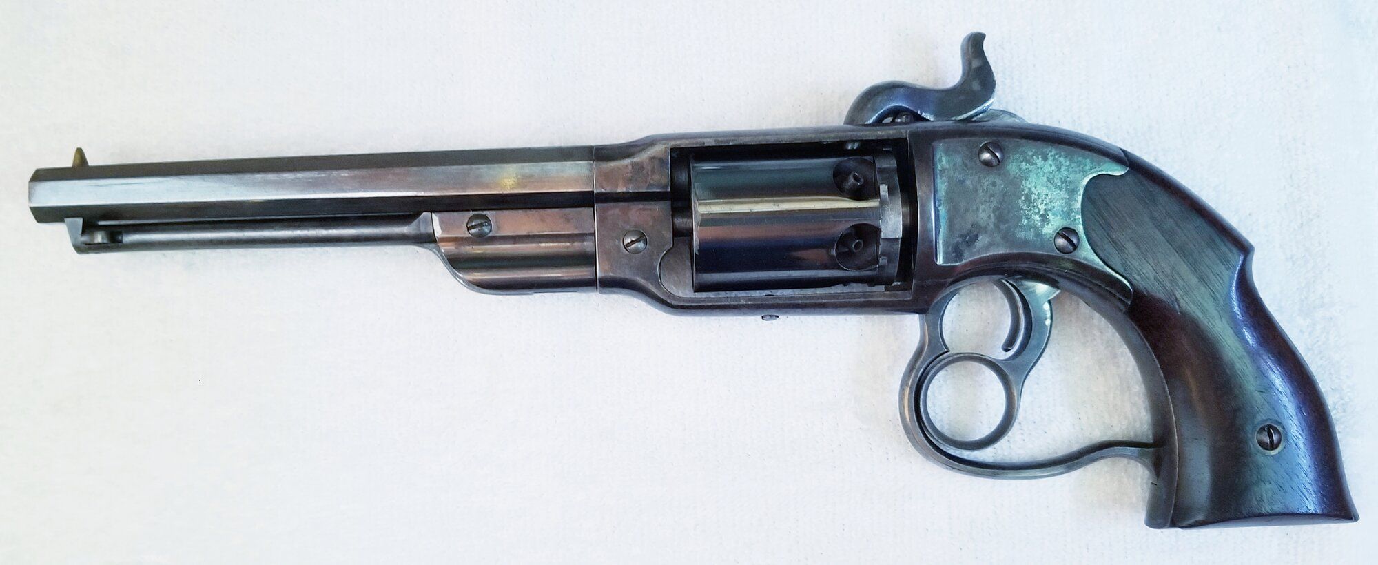

Savage Navy
Thanks for reminding me that the Savage Navy had the same feature. On the Savage Navy, could you cock the hammer with either the thumb or the grip mechanism?
Mine is buried in the safe. Even though the hammer had a thumb piece unlike the Tranter I believe it would be difficult to reach the thumb piece as your hand is much lower on the piece. I don't see from a quick look on line as a definite answer to your question. Here is an excellent write up by Tim Prince describing one he had for sale. https://collegehillarsenal.com/fine-martially-marked-savage-navy

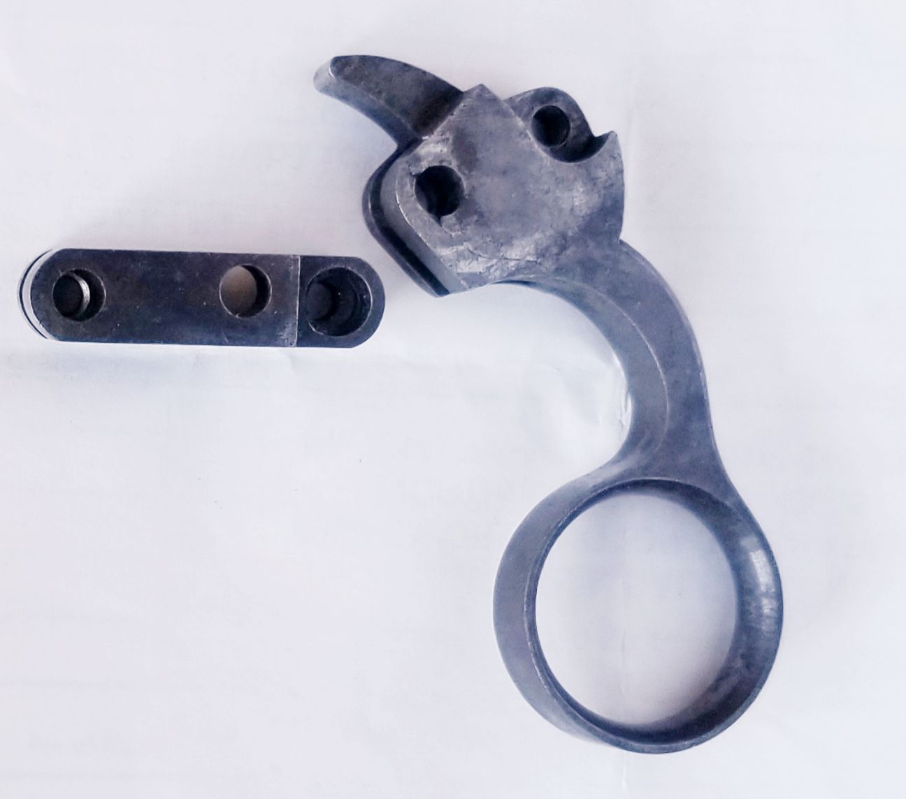

Hi nc native. To answer your question, no, thumb cocking the hammer on the Savage RFA revolver simply places the hammer on half or full cock. The cylinder does not rotate/index unless the cocking ring is pulled as a lift or lifting toggle/lever has to act to rotate the cylinder. The cocking mechanism draws the cylinder back away from the barrel breech, rotates the cylinder, cocks the hammer and by releasing the cocking ring allows the cylinder to move forward creating a gas seal between the barrel and each individual cylinder chamber.
Very nice. Now I don't have to dig to find mine, thanks
