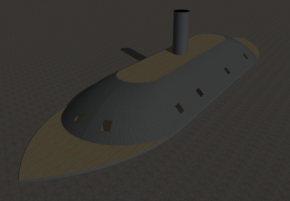

Ladies and Gents I need your help please.
Despite having a very good description of this proposal, the plans referred to have not survived - unless one of you kind and knowledgeable souls knows otherwise.
2. The Diamond & Bisby Ironclad.
Proposed by two citizens of New Orleans, with plans drawn by naval Architect W.T. Smith, this vessel was approved by Commodore Hollins on 10th August 1861 .
Described as 220ft x 56ft, flat bottomed with elliptical sides, nearly the same fore and aft with a single screw 2.5ft below the waterline. It had an elliptical "roof" and mounted 6 heavy guns mounted so as to fire two ahead or four each side. The bow and stern were solid "for many feet, and it was to be covered with railroad iron so as to resist any shot.
Haven't seen any depictions of this vessel, much less plans, but the C.S.S. Manassas lineage seems clear.
Gents,
Here we are, my take on the Diamond & Bixby vessel

Rebel, I do not understand the description of the placement of the guns. How many total?
6 guns, 2 firing forward and to either side, 3 pivots firing to either side and one firing aft only. The alternative is 2 fring ahead, and four pivots firing to each side with none astern.

Hi Rebel, the date you cite above makes this proposal essentially contemporary with the Manassas conversion. The staggered time frame makes you wonder if this project was actually a "copycat" proposal addressing what the average naval officer would have found lacking in the Manassas - firepower. I've never seen any documentation reflecting "approval" of the Manassas by Hollins or anyone in Richmond. Hollins shanghied Stevenson's ram out of necessity and lack of alternatives. Certainly, no one repeated the Manassas layout. Is their any evidence that the D & B ironclad was actually started? Was W.T. Smith's name associated with any of the dock yards at Algiers? The ability to actually build this vessel if funded would make it much more credible.
Hello Georgew, Manassas was a private conversion I believe, and you are right about the seizure for the CSN.
Andy Hall suggested the connection between her and the D&B vessel. I don't know who W.T Smith was or if he was connected to any of the yards. Hollins authorised the construction, but there appears to be no source of funding identified so I have assumed no work was done on it.
