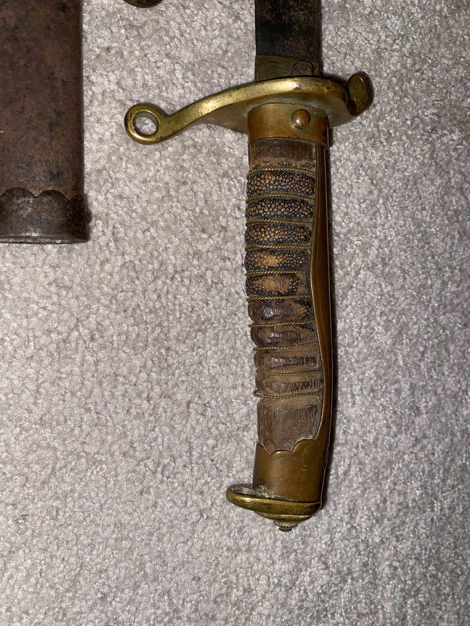

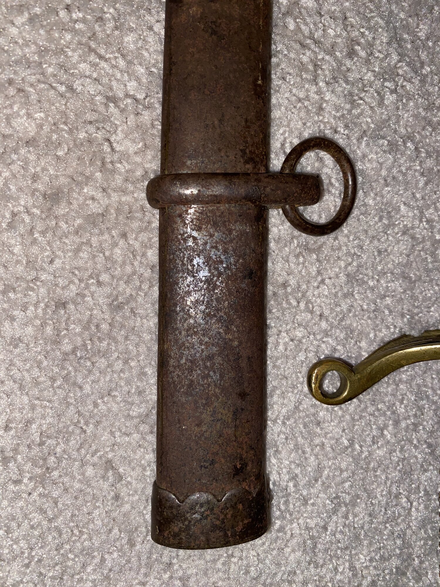

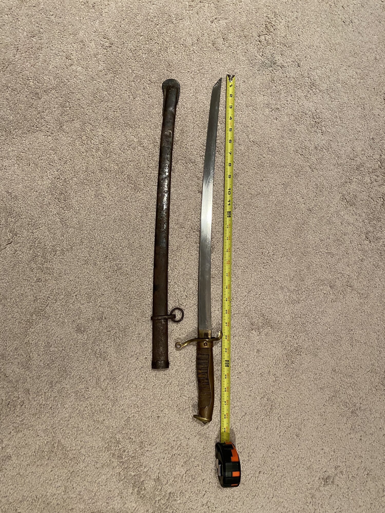

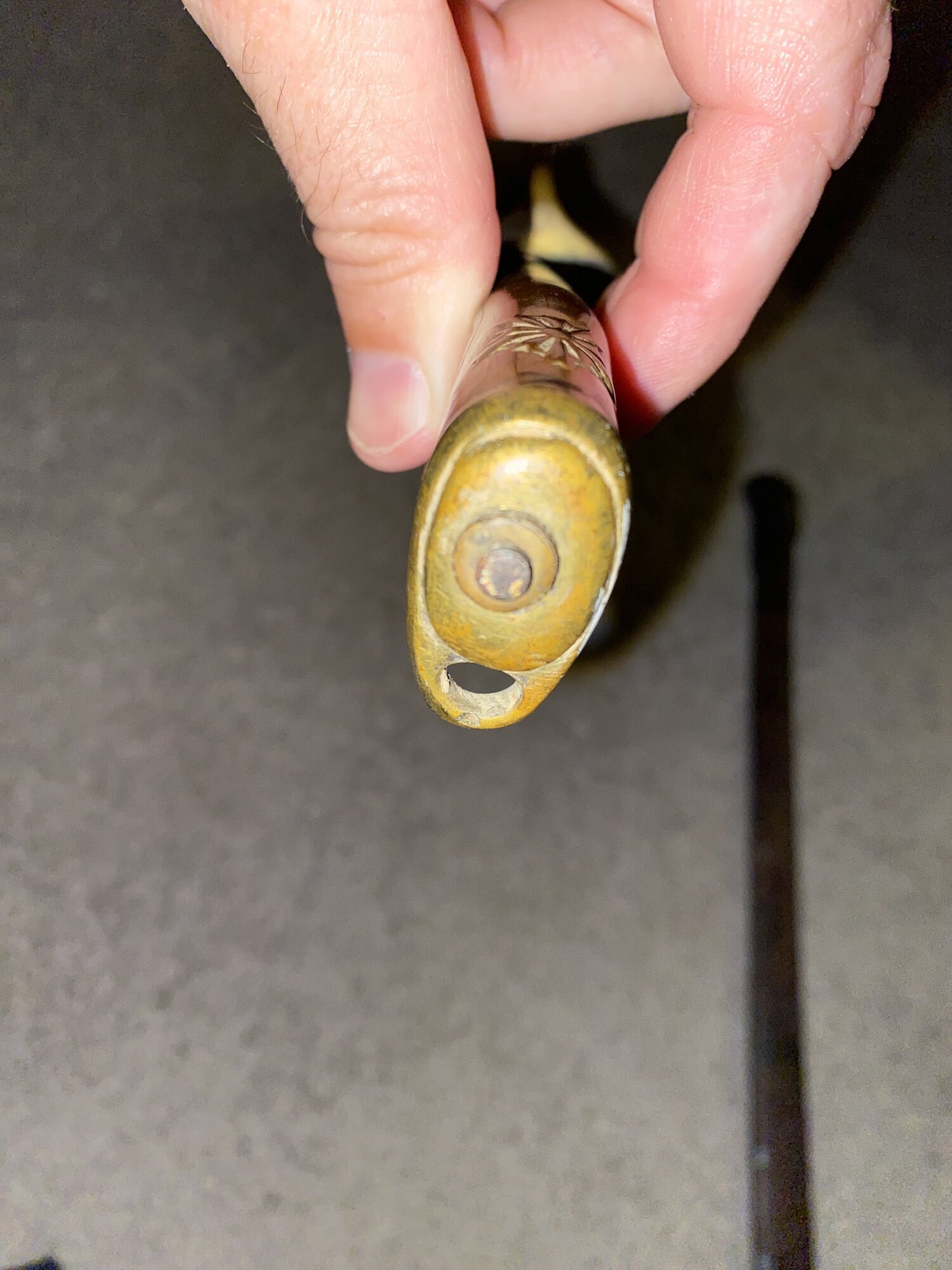

Hello all,
Looking for some help here. Trying to identify a light sword or sabre. The scabbard and hadke appear to be period. But I typically see a hand guard. I have been searching but have yet to discover any other examples. I am sure I am looking in the wrong places.
I hope the pictures are clear enough to help with identifying this item. I have carefully looked and see no names, letters, numbers or any other identifying makers mark.
Thank you in advance for all the groups help !

Interesting sword. Its not US or CW and with the grip and tip of blade I'm leaning Asian especially Japanese.
This is a Japanese police sword, model 1906?, for patrolmen and sergeants. Since it was used by patrolmen on their beat, it has a tempered blade (swords for high level police officials were not tempered and were plated. The shape and the lack of ears on the back strap along with a lack of five-petal cherry blossoms tips you off that it is police. Army swords had a knuckle bow and cherry blossoms with 10 petals. The police badge on the back strap next to the pommel only appears on swords for patrolmen and sergeants. Another tip-off that it is Japanese is the shape of the blade tip which is similar to a samurai sword. A sword knot was threaded through the hole attached to the pommel and the hole at the end of the quillon. This probably represents a veteran's bring-back after World War 2 or the Korean War.
