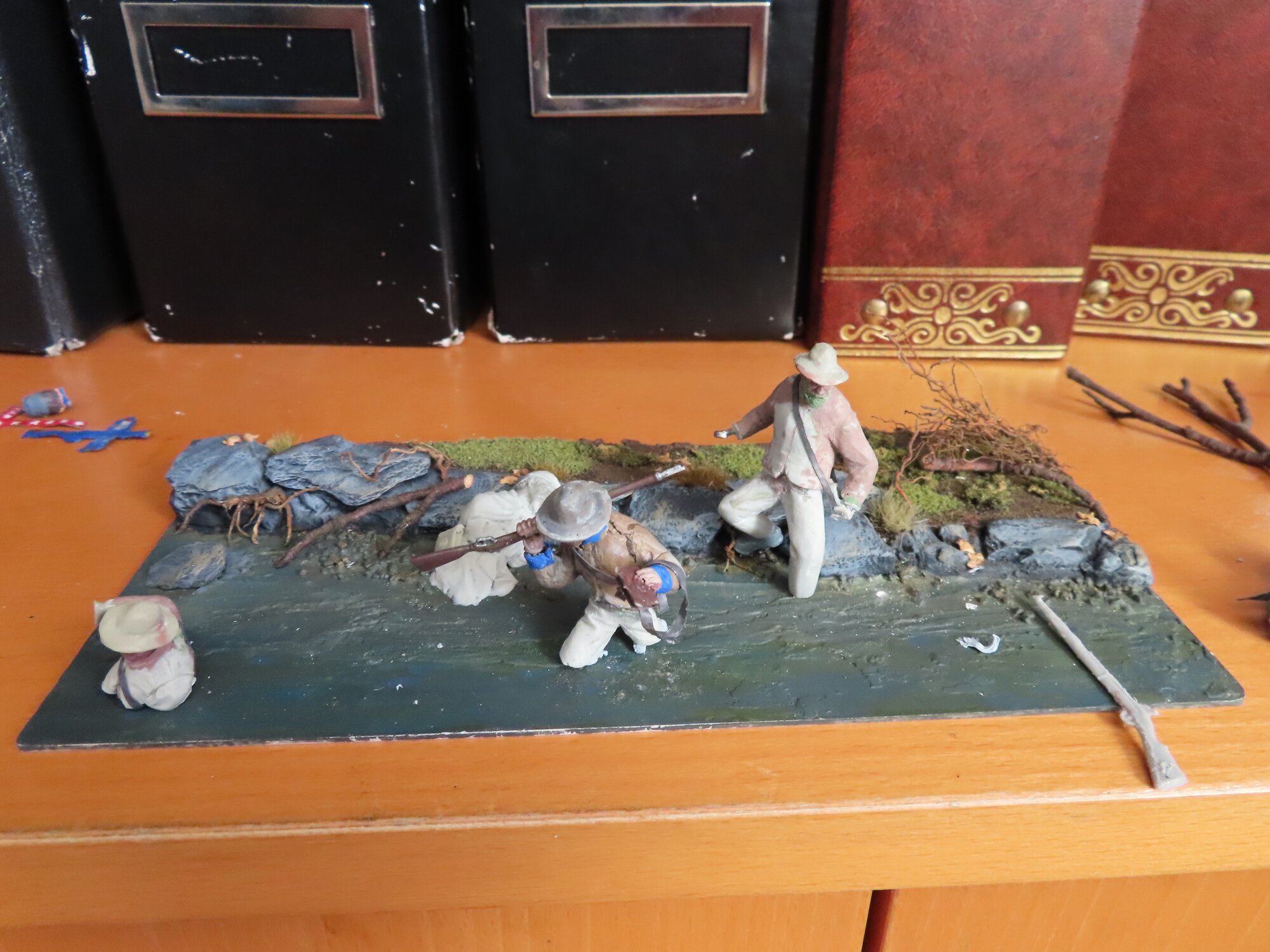

I started with the groundwork using stones which I painted dark grey and then dry brushed white to bring out the details. For the grass and soil I used materials bought from Woodland Scenics and added the twigs found in the garden.
The wounded Union figure I sculpted using Magic-Sculpt.

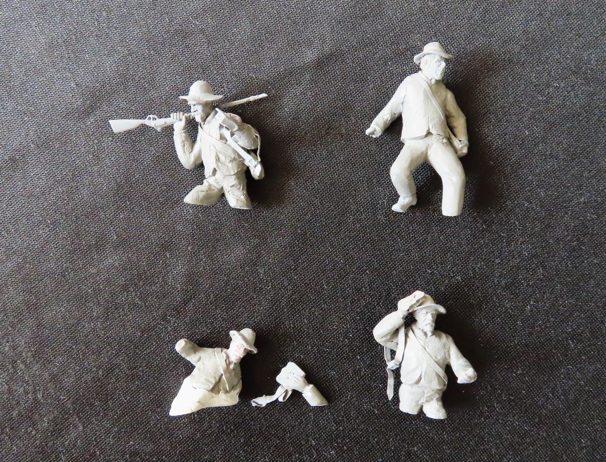

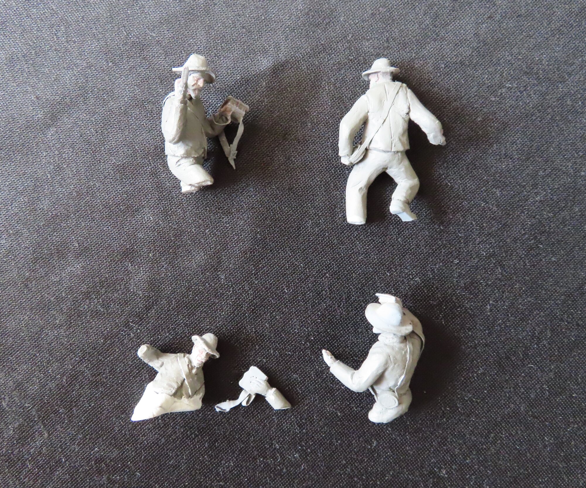

The next stage was to build the figures, again using Magic -Sculpt. I decided on 2 carrying rifles with their cartridge boxes held aloft , 1 Flag bearer and 1 falling over.

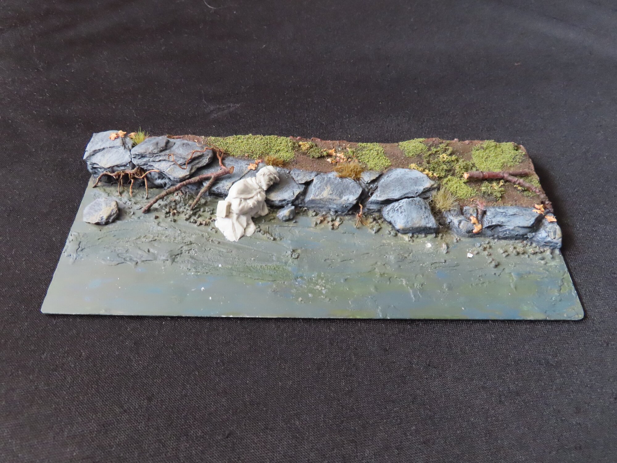

The river bed was painted in preparation for pouring the Woodland Scenics water effect liquid.

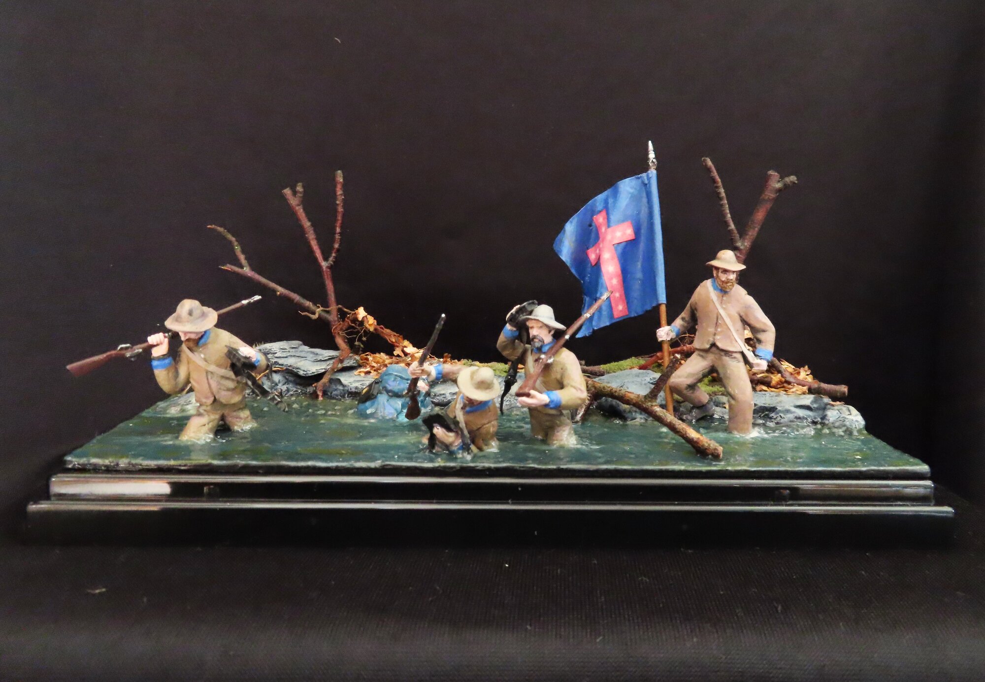

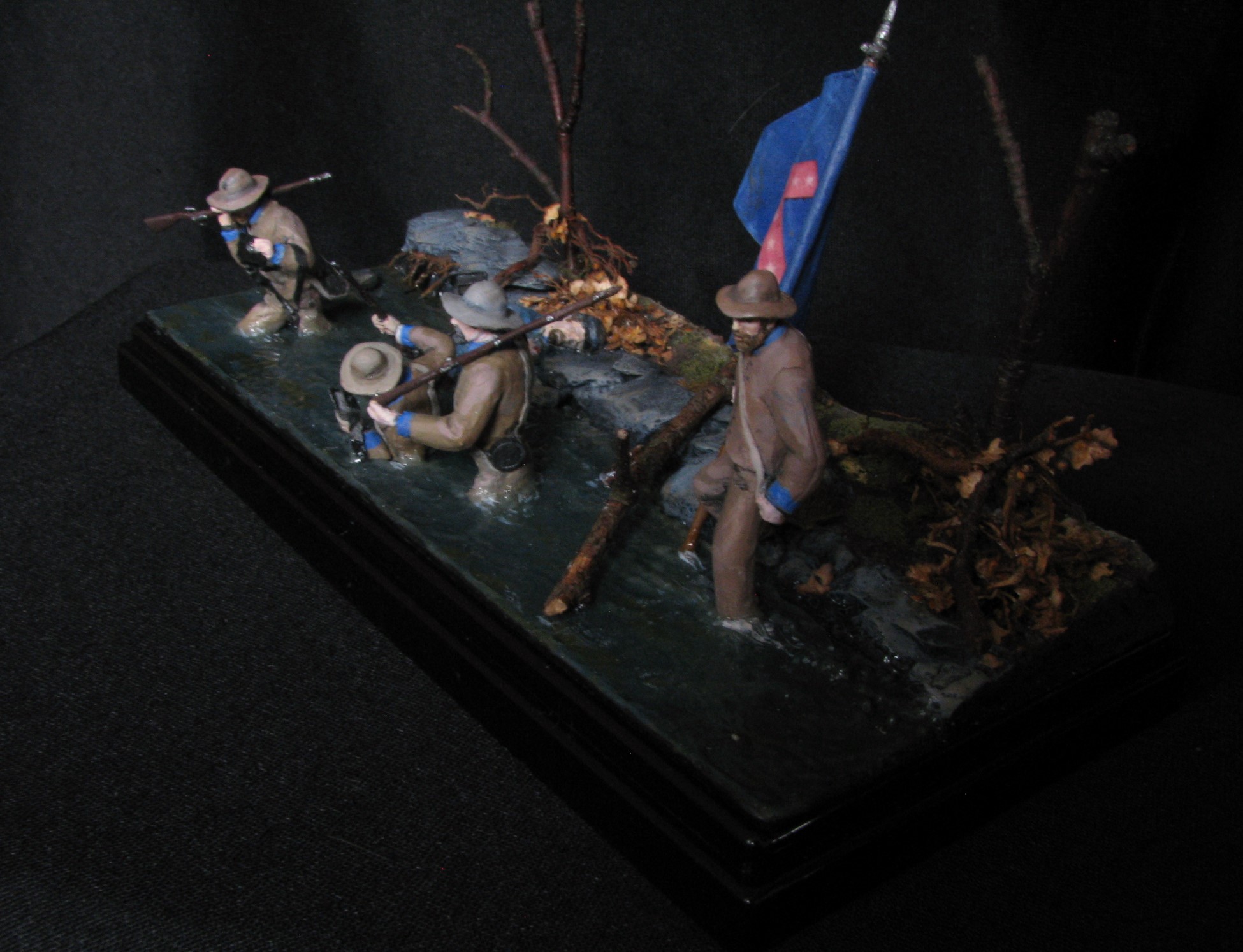

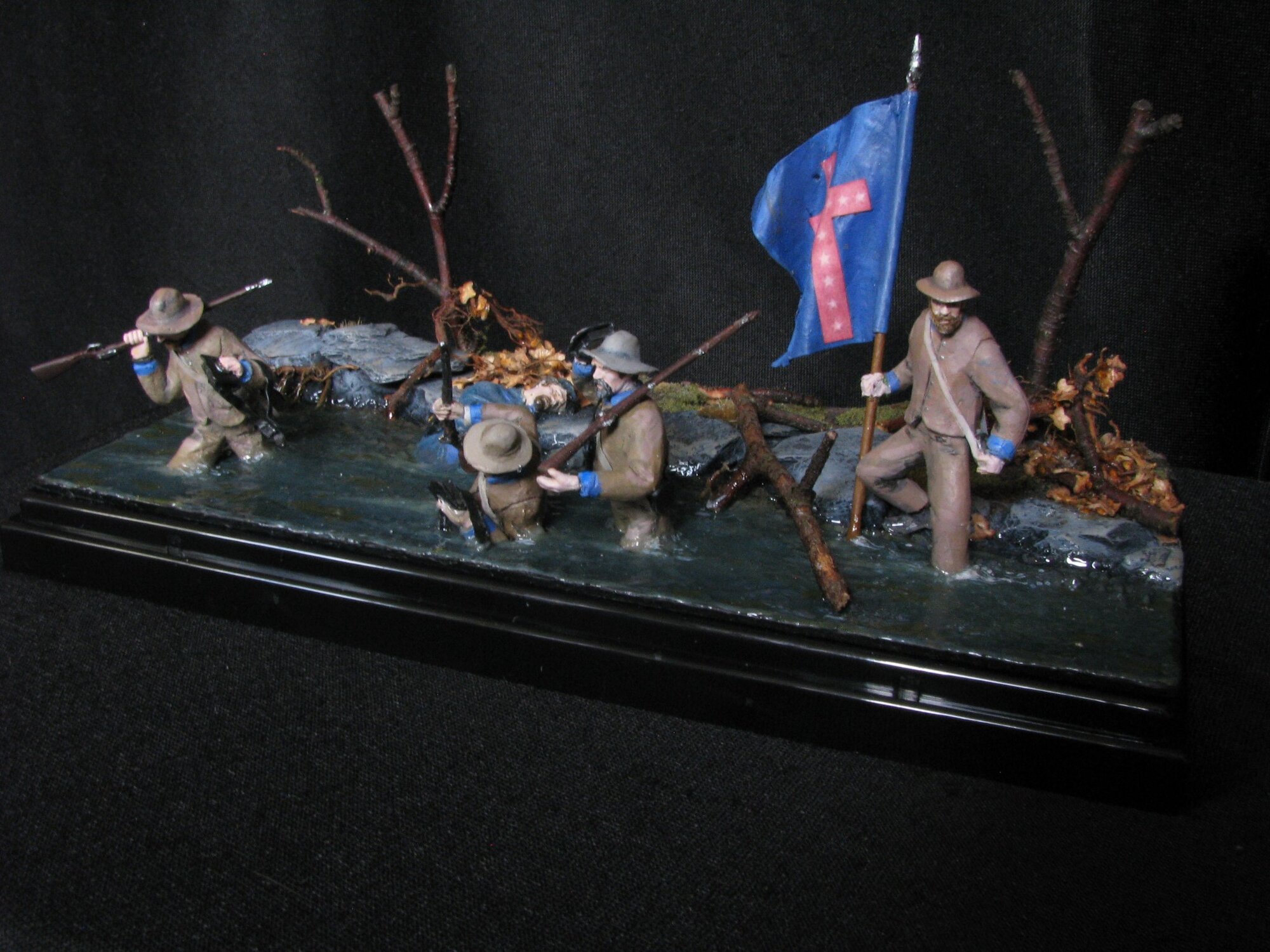

Painted in Acrylics with the flag added using sheet lead.

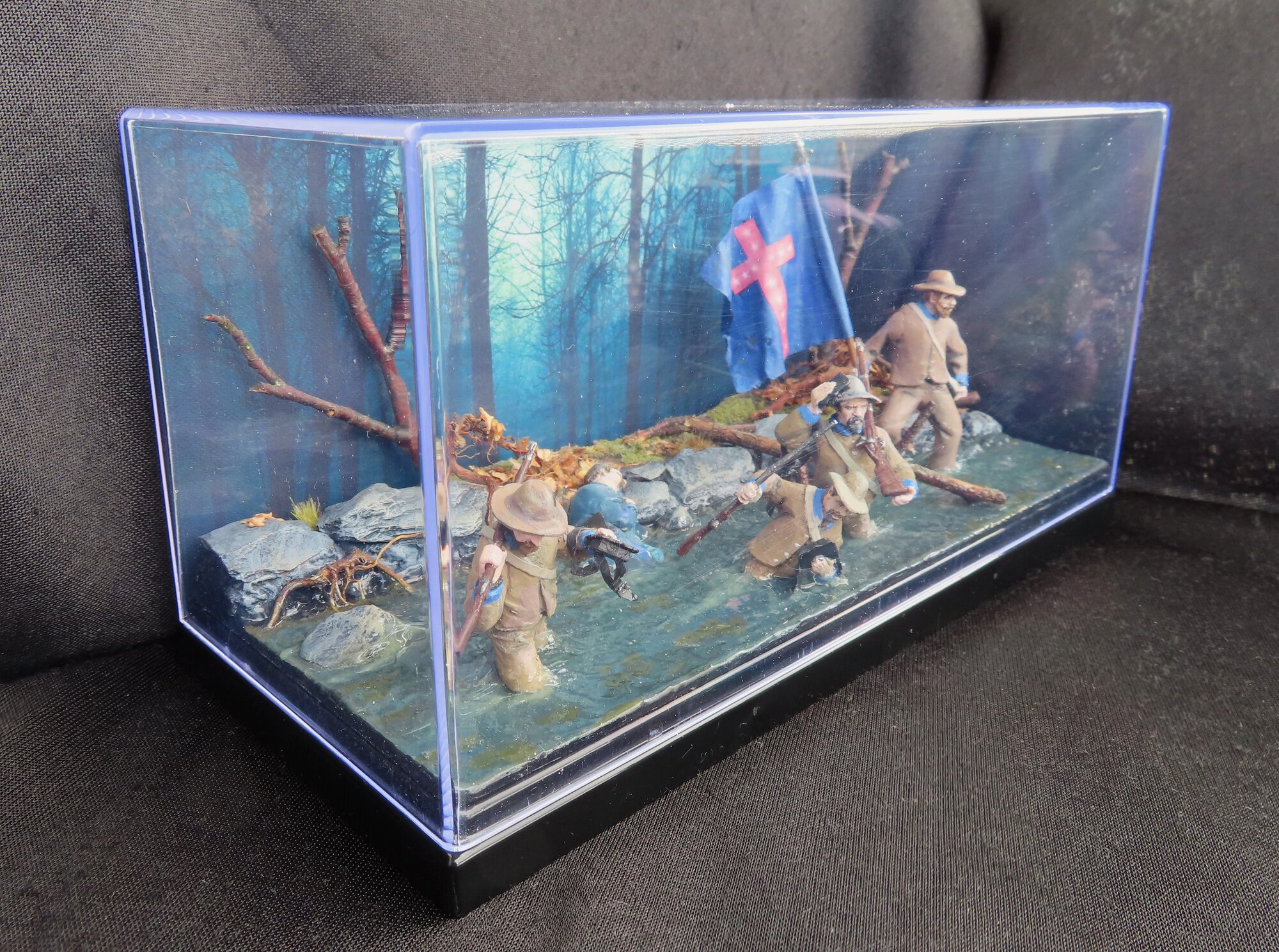

Finished in a display case with a pictured backdrop and labelled McFaddens Farm/ Stones River.

When I saw the finished product, I was sure I could see down into the water at least a little bit. Did you lay a translucent coating to the final base---even a very thin one?
After pouring the water effect solution and leaving it to dry for 24hrs you end up with it looking flat like glass. I then brushed on a layer of Mod Podge and by using a straw I blew the liquid around to get the effect of ripples in the water.
