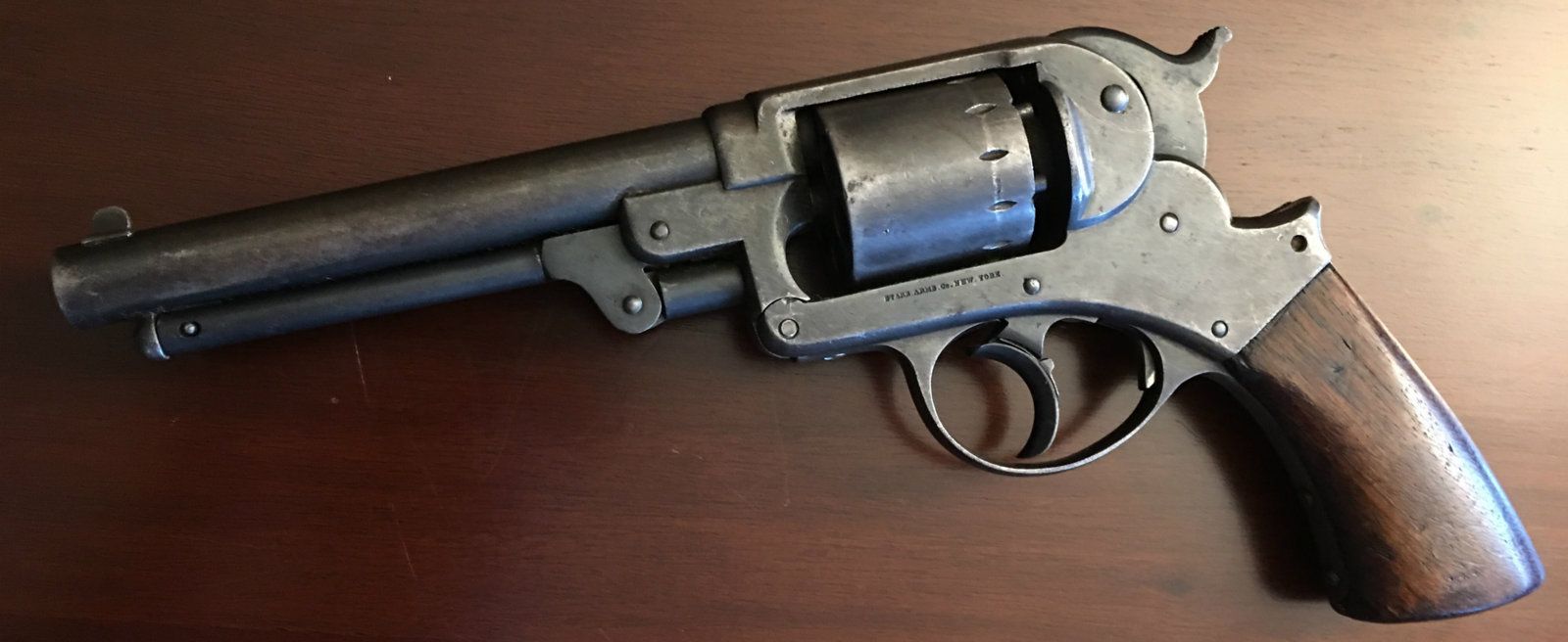

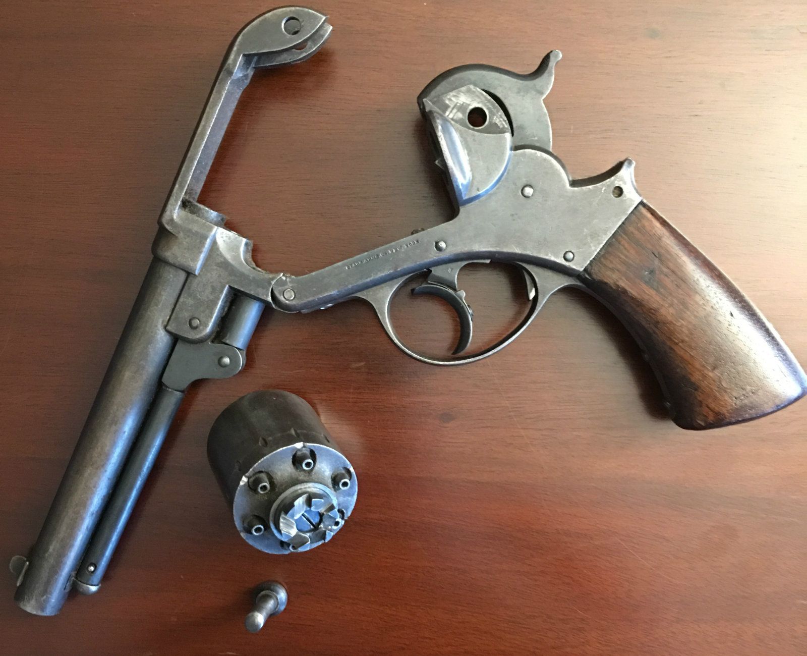

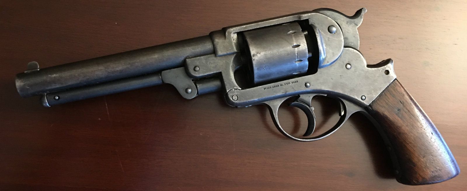

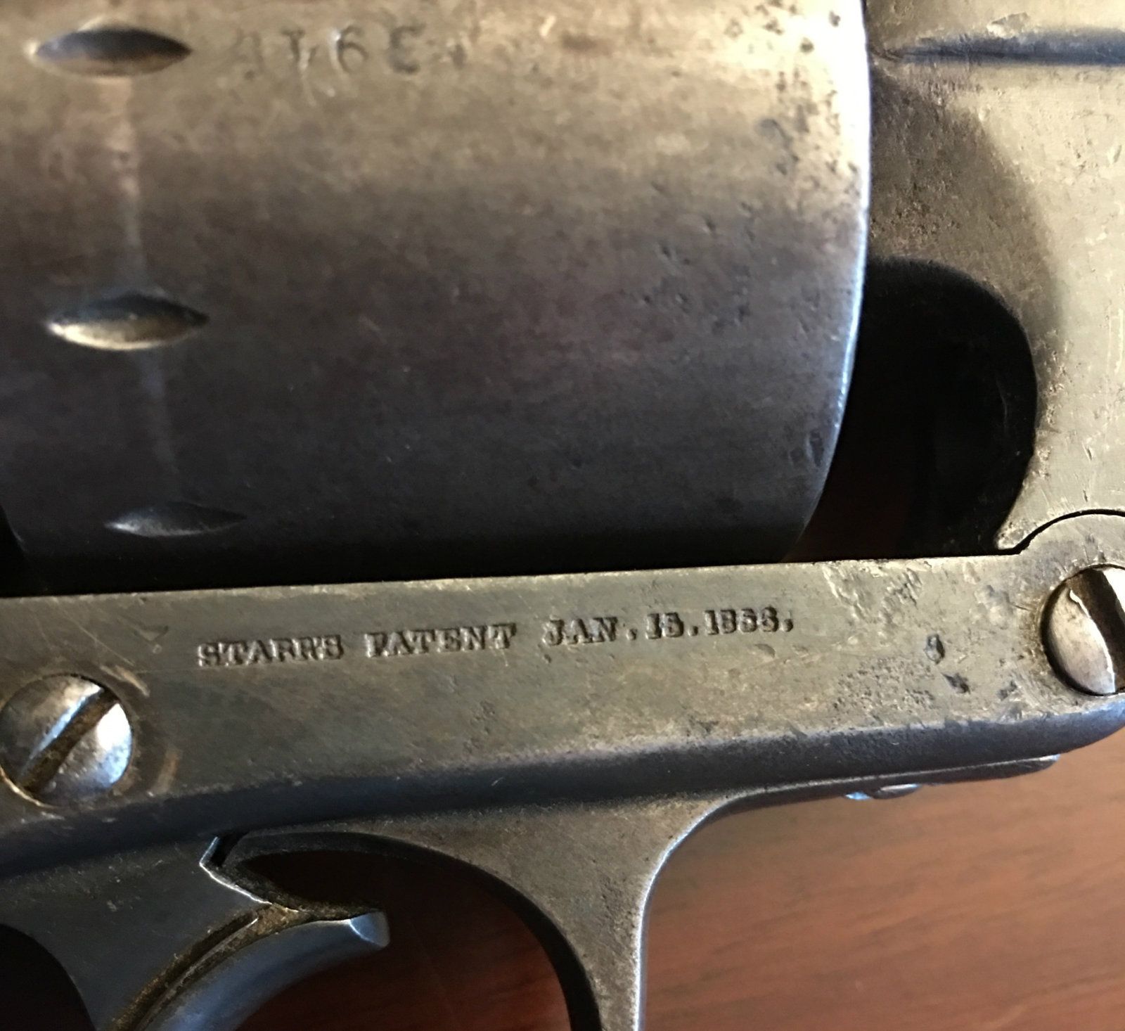

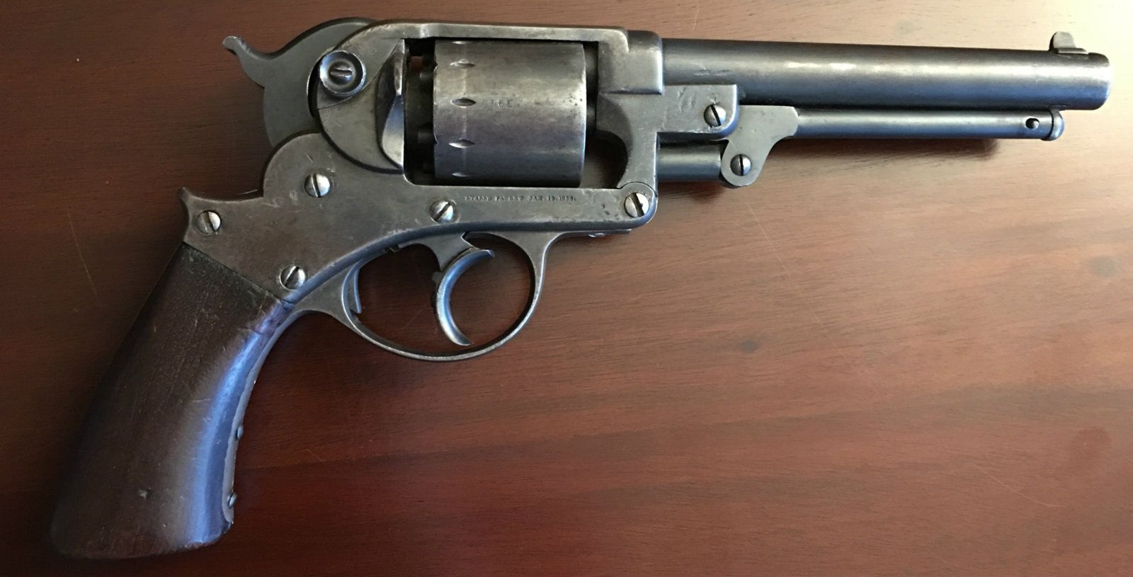

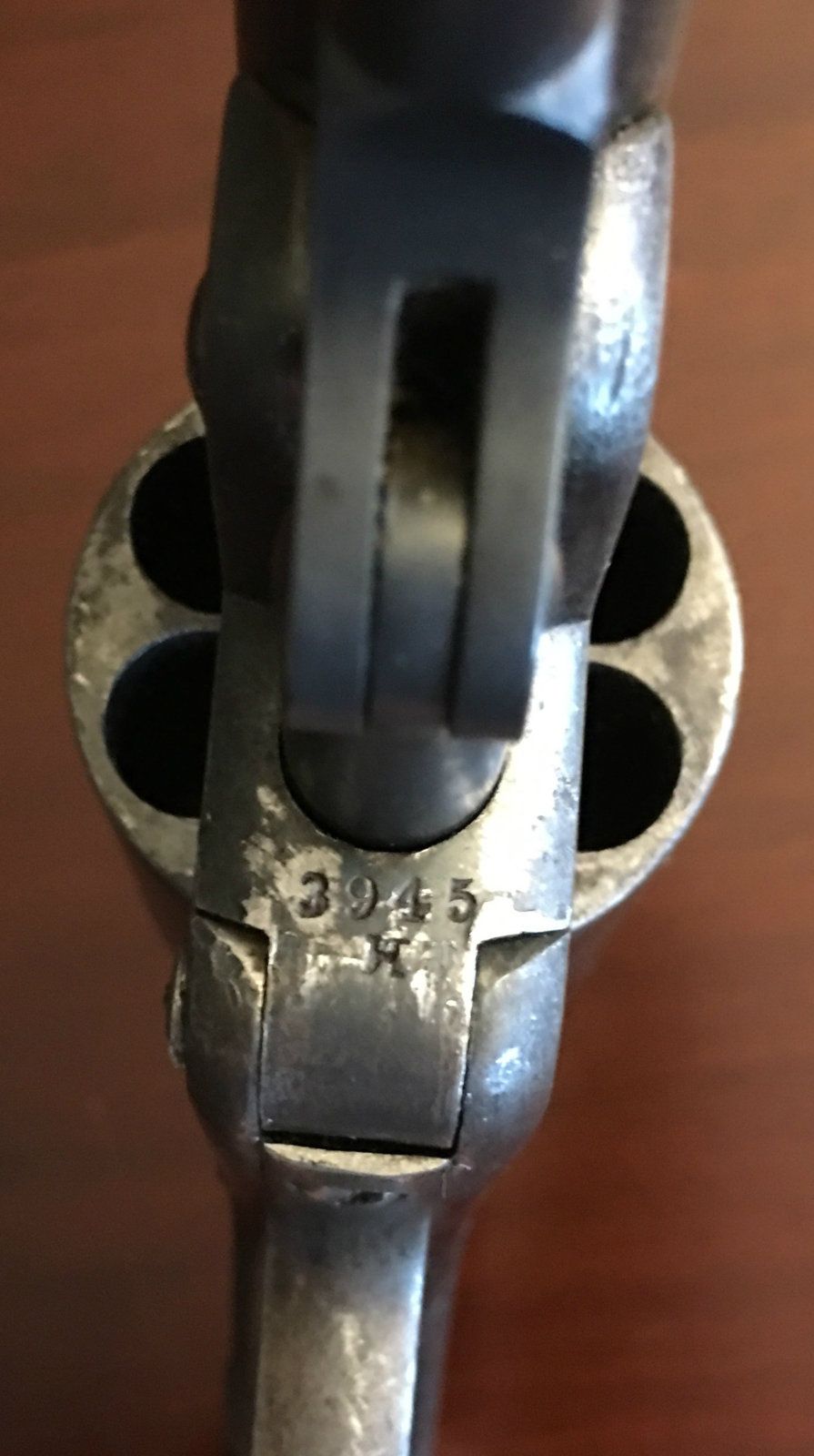

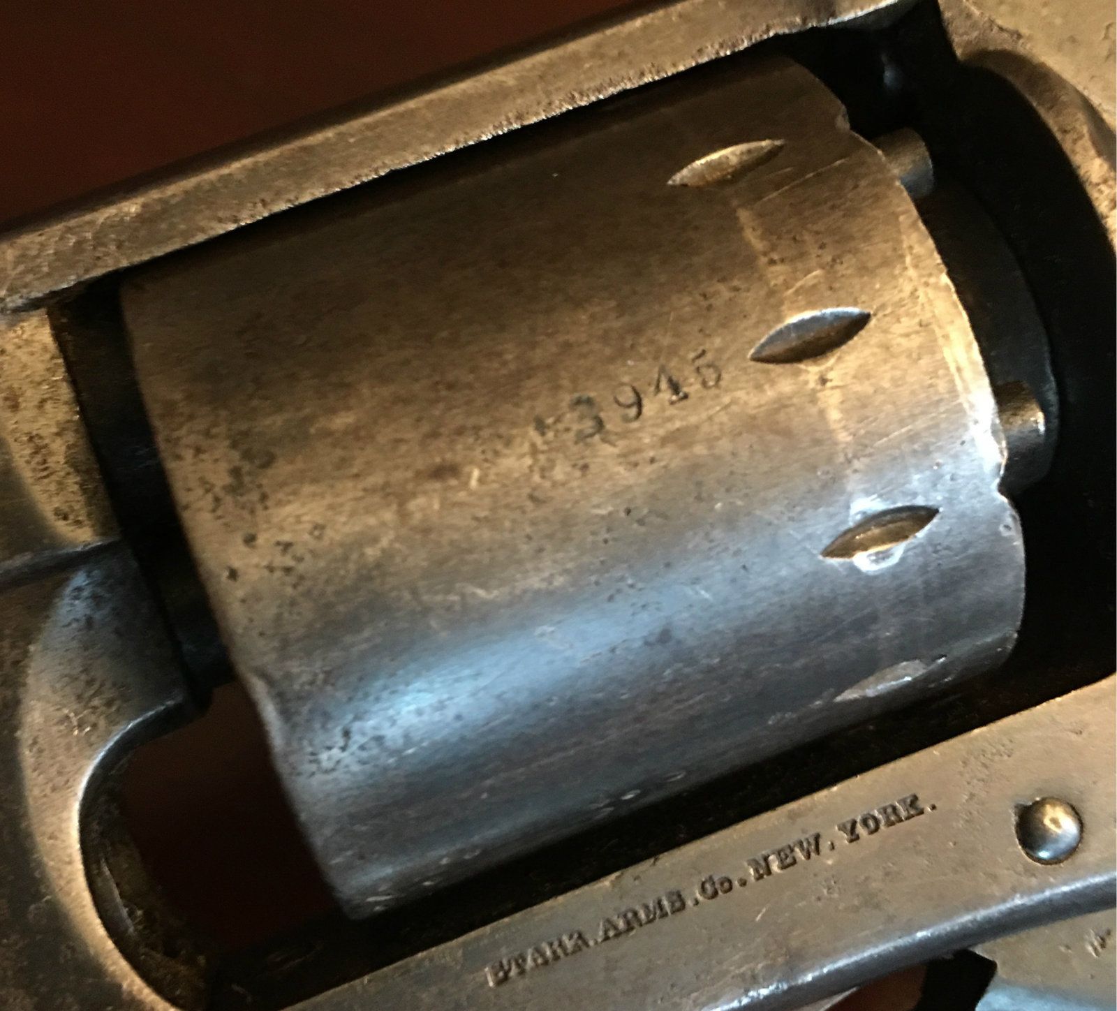

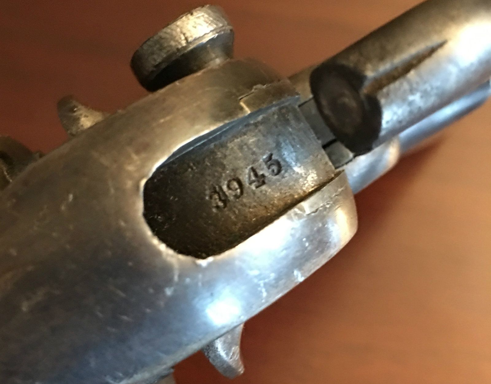

I recently picked up a Starr model 1858. The serial number is early - 3945, all matching - so I was wondering if there was any way to pin down a manufacture date? Also, if there is any way to decipher the few marks on it. The SN facing front under the barrel has an H (I think) stamped next to it. On the left side of the frame there are two small Ks about an inch apart vertically to the rear of the cylinder and that's it. I can't tell if there are any inspector's marks on the grips - either worn away or never present can't tell. But the early SN would make me think it was part of the initial Army run if they got the first batch? Finally, any idea on a price range? Flayderman says the difference is negligible between civil or martially-stamped pieces and the prices range from 800 to over 2K, good to very fine? It's got some minor pitting I'd consider but not completely worn down to grey metal.
Not sure how to judge. Thanks!
I recently picked up a Starr model 1858. The serial number is early - 3945, all matching - so I was wondering if there was any way to pin down a manufacture date? Also, if there is any way to decipher the few marks on it. The SN facing front under the barrel has an H (I think) stamped next to it. On the left side of the frame there are two small Ks about an inch apart vertically to the rear of the cylinder and that's it. I can't tell if there are any inspector's marks on the grips - either worn away or never present can't tell. But the early SN would make me think it was part of the initial Army run if they got the first batch? Finally, any idea on a price range? Flayderman says the difference is negligible between civil or martially-stamped pieces and the prices range from 800 to over 2K, good to very fine? It's got some minor pitting I'd consider but not completely worn down to grey metal. View attachment 140851 Not sure how to judge. Thanks!View attachment 140843 View attachment 140846 View attachment 140847 View attachment 140848 View attachment 140849 View attachment 140850

Welcome, enjoy. It appears to be a 1858 DA. Take a look at some of the auctions like Guns International to give you an idea of prices. Condition, condition, condition.
Welcome From The Heart Of Dixie. very nice piece. It's in very good condition but it's hard to give a price from photos. I will check my books on the serial# and get you a date and the inspector marks.
NRA says 23,000 DA and that they were produced first, so your's would seem to be within the first few years.

Here is a list of all inspectors who inspected the Starr's I believe your H is going to be Benjamin Hannis. Check the grip for any cartouche markings as it appears to have one on the lower end of the left hand grip.

BH Benjamin Hannis Allen & Wheelock, Colt M1860, Remington Elliott, Savage Figure 8 and Starr Revolvers 1861
