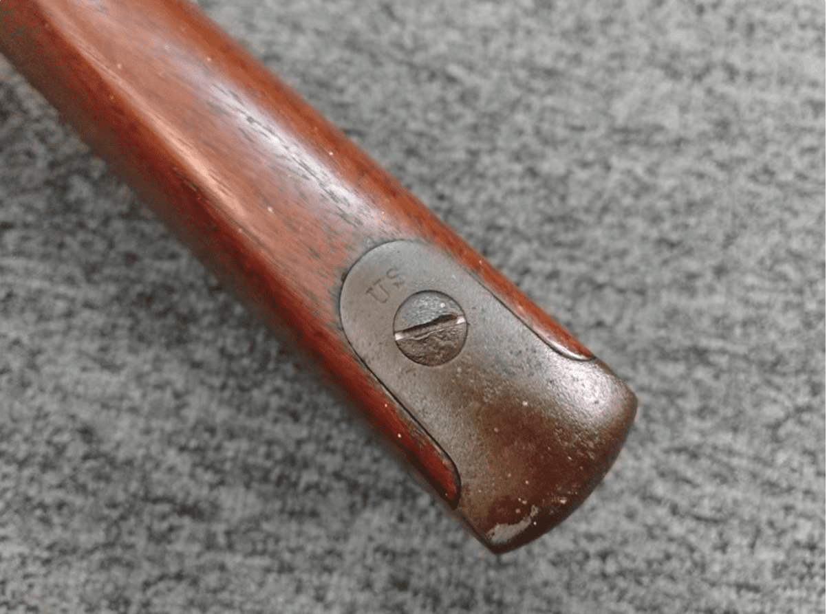

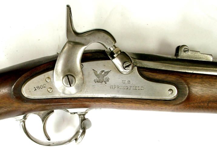

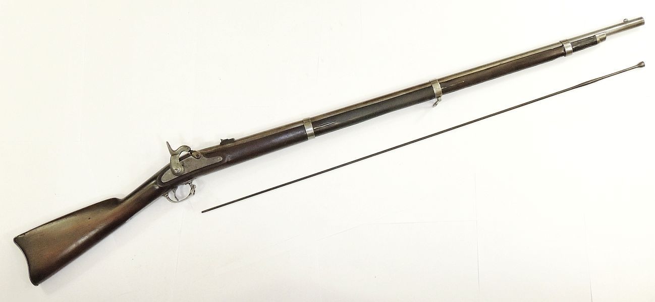

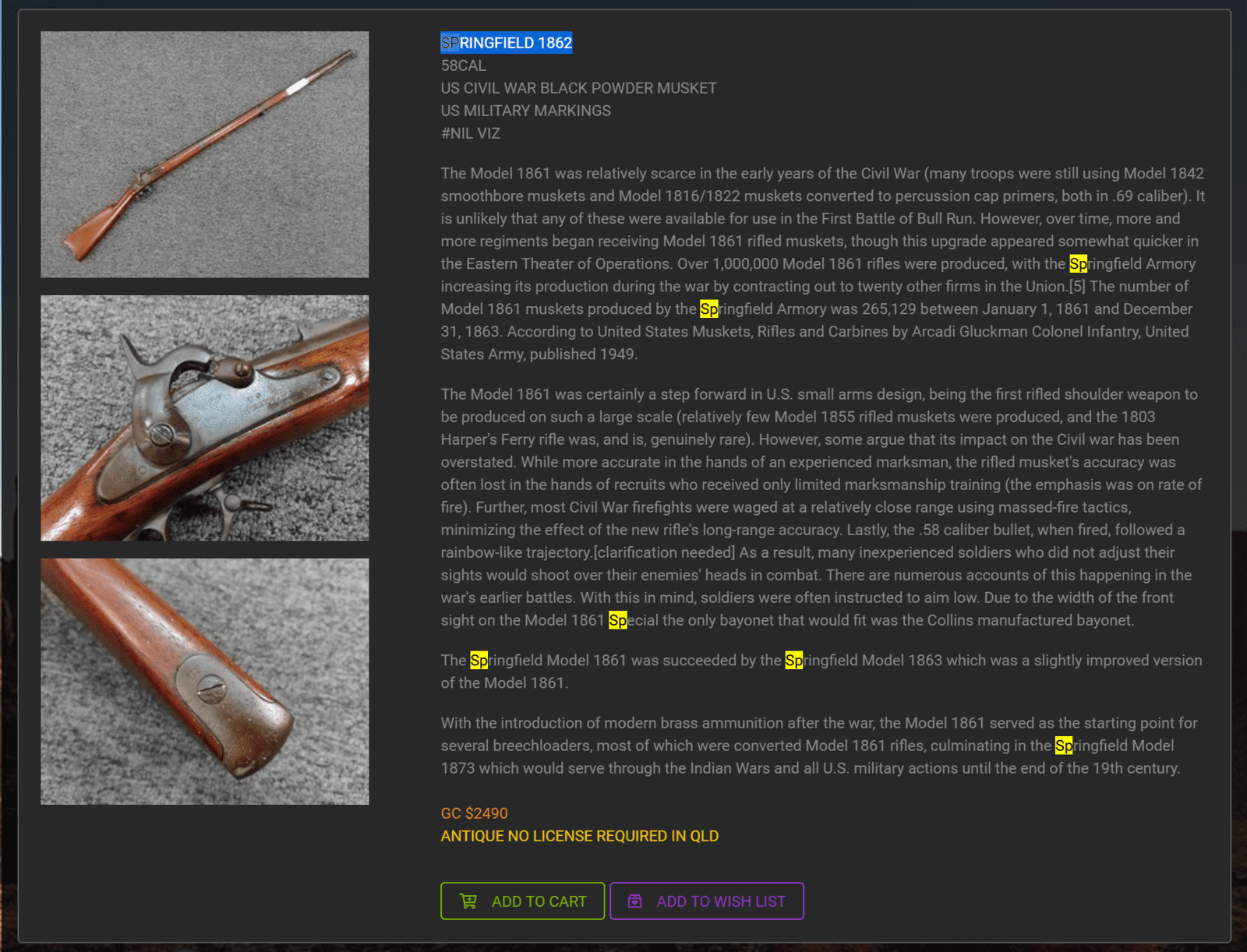

Loving the forums, thanks for having me. I am looking for some assistance in trying to work out if this SPRINGFIELD 1862 that is for sale in Australia is the real deal or a fake. I am struggling to find any professionals in Aust. that can help me out (there isn't a big antique firearm market here, as well as people who are experts in the field). As this will be a gift for my father I am doing all I can to make sure it is a genuine piece. Any assistance you guys can provide, or even a point in the right direction to find more information would be greatly appreciated. I've also purchased some books in the mean time, but if you guys have any book recommendations for American Civil War firearms research that would be amazing.
I'll post the link for the ad and post what photos I was able to get from the dealer here. Thank you all!

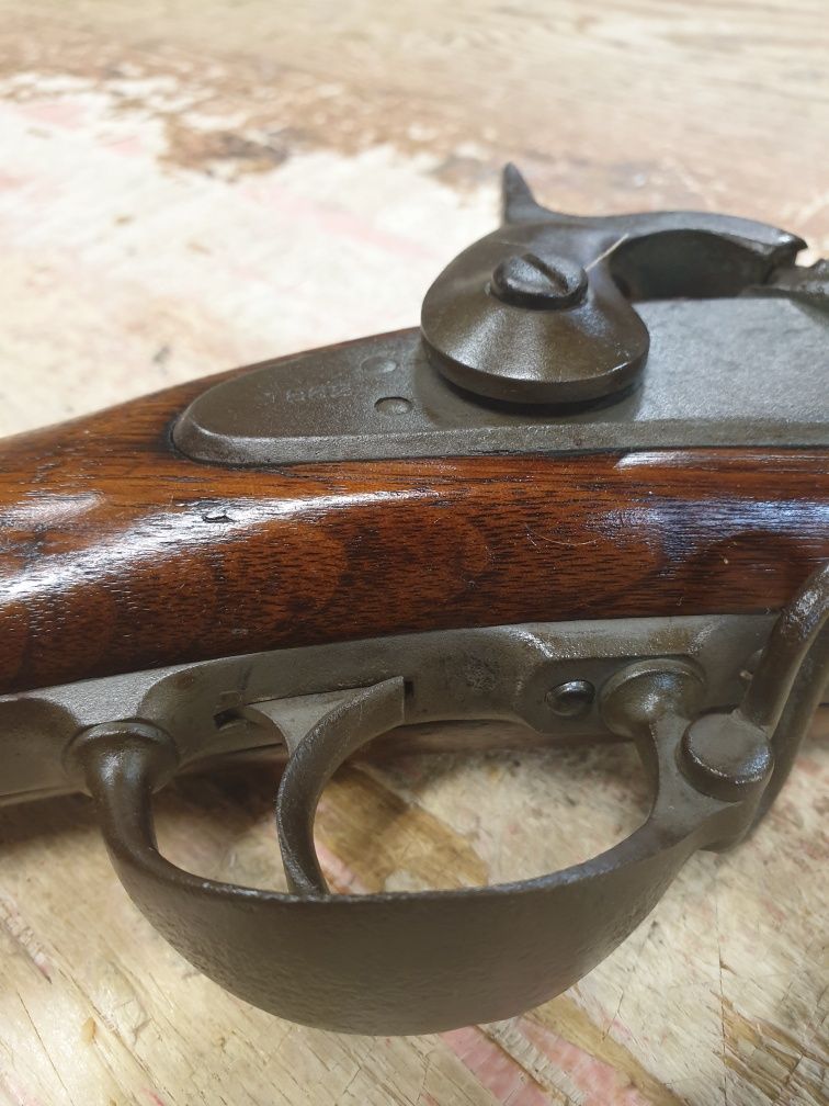

It certainly looks real to me. The clean-out screw has been replaced with something that isn't correct. The stock appears to have been sanded and oiled with something that makes it too shiny compared to the original finish, although that may just be oil that was put on it by the seller for the photos. People do that sometimes. I have no knowledge about the collector market in Australia so I can't tell you whether you could find something better or what a reasonable price would be. I can tell you that it appears to be real, is complete, and is in relatively average condition with the caveats noted. 1862 dated examples are seldom in great shape anyway.

I concur looks right as rain to me and I'm like LP a little high on the price.

I agree and have a comment about the shiny finish on the stock. I was once advised by the gunsmith at my favorite antique gun shop - who certainly should've known better! - to use a product called Tru-Oil on the stock of one I had purchased. DON'T - despite its name, Tru-Oil isn't an oil at all (though it goes on like one) but rather a thin varnish! That stuff left a glossy coat much like this on my rifle - something the originals never had when they were new; military arms were only given an oil finish at the armory. I wound up having to remove it in order to use it for reenacting.
To me, it looks like whatever they put on the stock, they also covered the metal with it, perhaps thinking that it would protect it from rusting?
I found my reproduction official manual for the 1855 Springfield , it says that applying Linseed oil is best. Carefully applied multiple coats of Linseed oil , as stated in the manual, will make a rifle stock look shiny. The page from the manual is attached. If in doubt, refer to original sources.

The description is accurate and describes the item well, but does not mention the condition. It is "real" and shows it's age, but no abuse.. Don't know the market in Oz. but at around US $1800 {converted) it seems a bit high for USA but must be far more rare where you are.
Unfortunately there isn't selection of antique firearms in general in OZ, especially ACW, so we do pay a premium it seems.
