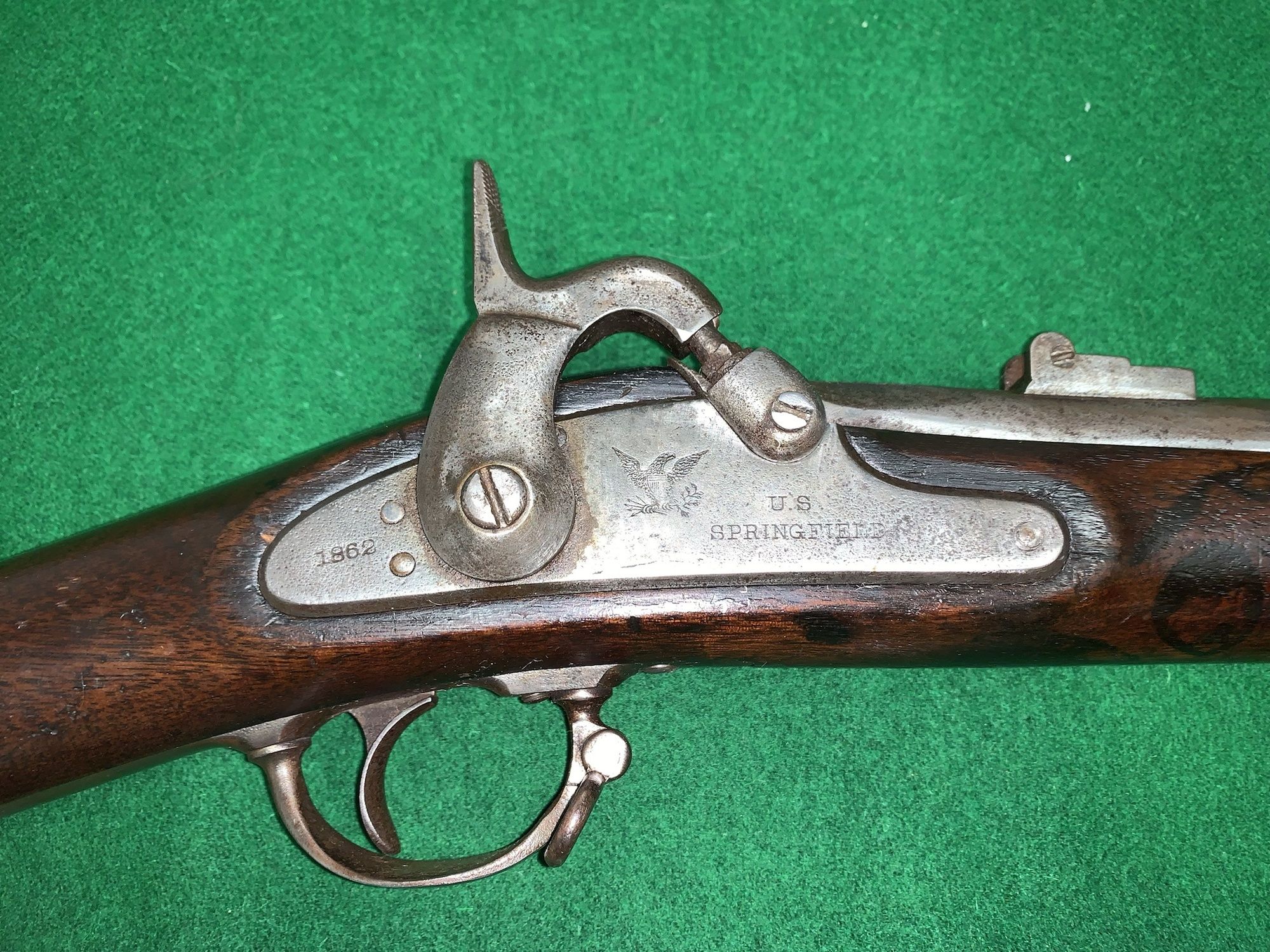

Hello all! I have an opportunity to pick up this Springfield 1861 for my collection. I pretty much focus swords, sabres, documents, and confederate currency, but I am looking to expand to firearms as well. With that said, I am still learning and dont know too much about this 1861. Does it appear all original? Do you see any red flags? What would you place the approximate value at? Any input anyone can provide would be greatly appreciated. I have a video of it too, but unfortunately it will not let me attach it. I can email you the video if you would like. Thanks!
Well the first part of your post indicates you did not buy it yet, and should not unless you want a reproduction. The first pics I thought the wood stock is in too good a shape compared to the metal. Then the serial # was a dead give away. Back in the day some of us had the serial # removed and stamped on the bottom of the barrel by Zimmerman at events. Please tell us some character is not trying to sell you that claiming it's an original?
That is a 100% original Miruko. Like mentioned serial number is a dead giveaway. Since they are removed sometimes, I always look at how the sling swivel on the trigger guard is attached. Should be a pin, screws for repros
Is it being represented as original? If the bore was good I'd buy it as a shooter but good reproductions and originals are getting strangely close in price
Thank you very much, I appreciate your input on this.Yes, he claims it is original but says hes not a collector and doesn't know much about it himself.
