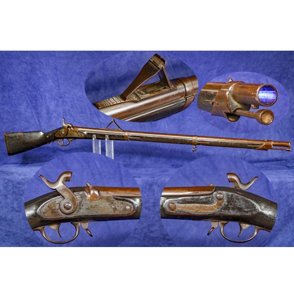

I love me some smoothies, my faves is the Bavarian M1842.
"The Union Army purchased a number surplus Bavarian M-1842 for usage during the American Civil War.[9] Of the Bavarian equipment offered to the United States for purchase, the M-1842 was evaluated as the only weapon of sufficient quality for Union usage. An unknown number of the weapons were sold to the Union, with sources referencing around 3000 muskets being sold as surplus by the US government in 1865 after the conclusion of the Civil War.[2][1]"
