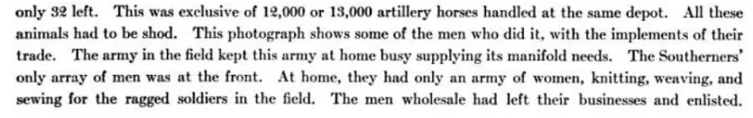

During the 1860s, the Army Quartermaster's Department established large remount depots at St. Louis and at Giesboro Point near Washington, DC where purchased horses were collected etc. in preparation for distribution to Army units.

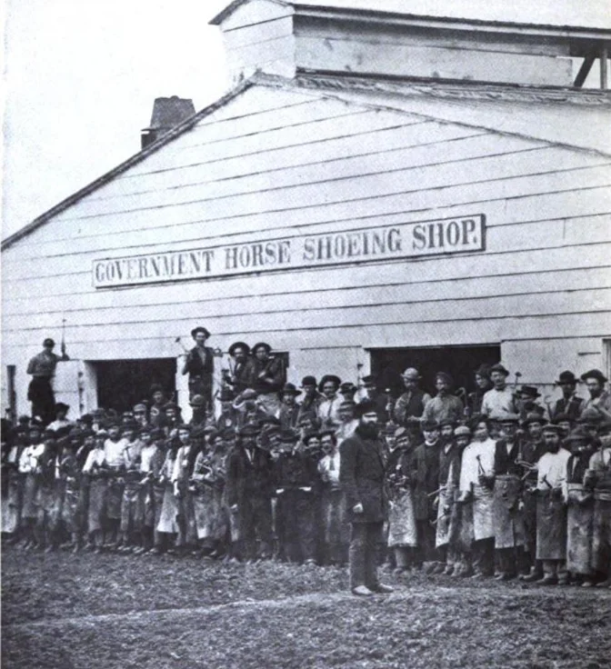

Mr. William Russell, who wrote a popular book on "Scientific horseshoeing," was said to have been quite prolific in his labors in the 1860s, shoeing up to 300 Army horses per day under government contract, which required him to post a $10,000 bond. It was said his shop labored day and night, and by shifts to complete the work.
Unlike in World War I, where the Army Quartermaster's Department soldiers were the farriers, etc., in the 1860s the Government employed civilians for much of the work.

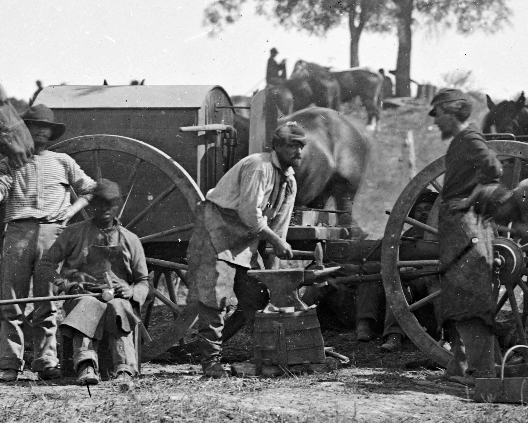

The Army employed field forges for taking care of the horses assigned to units.
Major Jacob Roemer of the US Army Artillery observed that in his field battery the unit farriers (about two per company) had to be kept busy every night replacing lost shoes, etc.

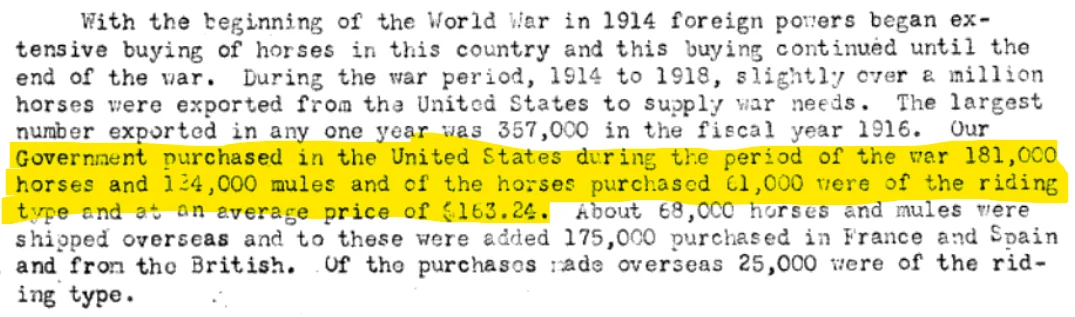

During the US involvement in the First World War, 1917-18, the Government purchased 181,000 horses and 124,000 mules, or about 300,000 animals, according to this 1926 US Army publication:

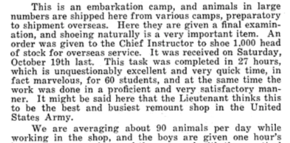

From 1918, Pvt. Humm among the Army Horseshoers says his unit was setting up 90 horses a day on average, but was able to process 1,000 horses in 27 hours...

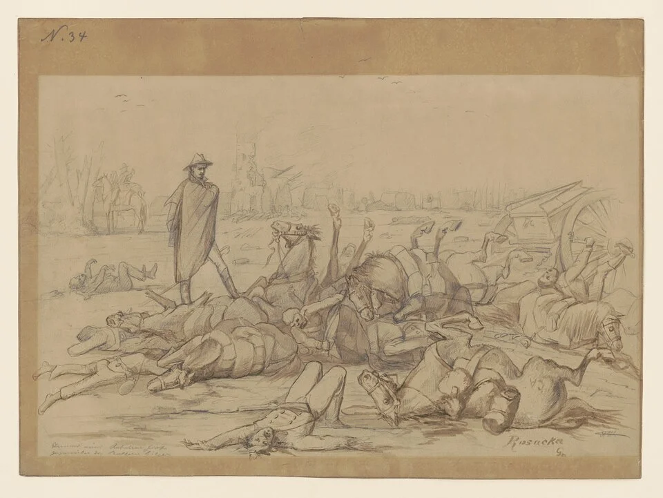

Captain Adolph Metzner was a gifted amateur artist. Have you ever encountered a dead horse in a field? The smell will linger in your clothes far longer than anyone would credit. Pity the poor Confederate artificers who salvaged horse, mule & ox shoes from dead animals. Pity is inadequate a word.

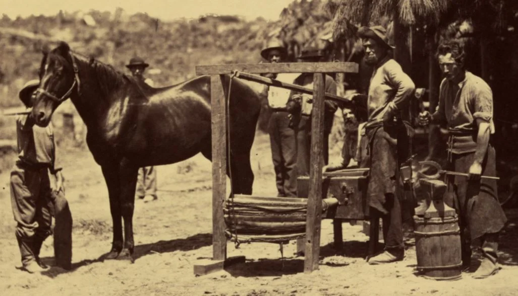

It takes (+/-) 3 hours to forge shoes from bar stock & shoe a horse. After a 30 mile march on the MacAdamed Nashville / Murfreesboro Pike, an artillery battery's farrier would shoe (+/-) 50 of an artillery battery's horses. Fifty times 3 hours… my goodness. I am too embarrassed to post how many hours it would have taken me.
With manufactured shoes figure 45 - 90 minutes. Maybe somebody should invent a machine, don't ya know?

If you really want a get a grip on what the Union remount system was, take a look at "The Cavalry" from the 10 Volume Photographic History of the Civil War."
