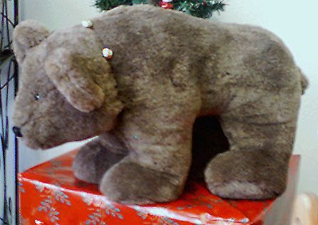

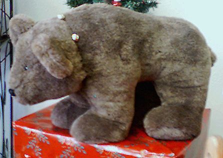

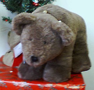

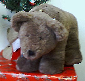

My wife had a bear shoppe in Pekin. Making keepsake bears from clothing of family members. I tried my hand at it and this is the first one I did:

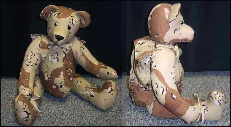

She made several thousand bears from coats and uniforms and any material presented by survivors for keep sakes for children and grandchildren.
This is an example of her using uniforms of military men:

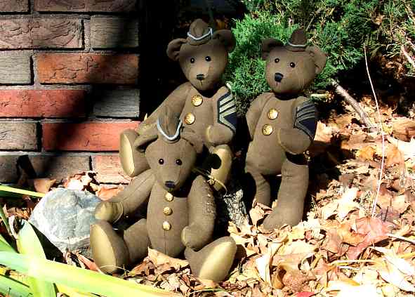

These 3 bears are my favorite. The hats were made from a hat. She used the insignia when possible:
Sorry for hijacking the 'thread'...
View attachment 209375 View attachment 209376
Those are absolutely adorable! What a wonderful idea for keepsakes. A friend of mine found a woman in Nova Scotia who made bears from old fur coats. They were beautiful as well. Oops, no more high-jacking.:O o:
