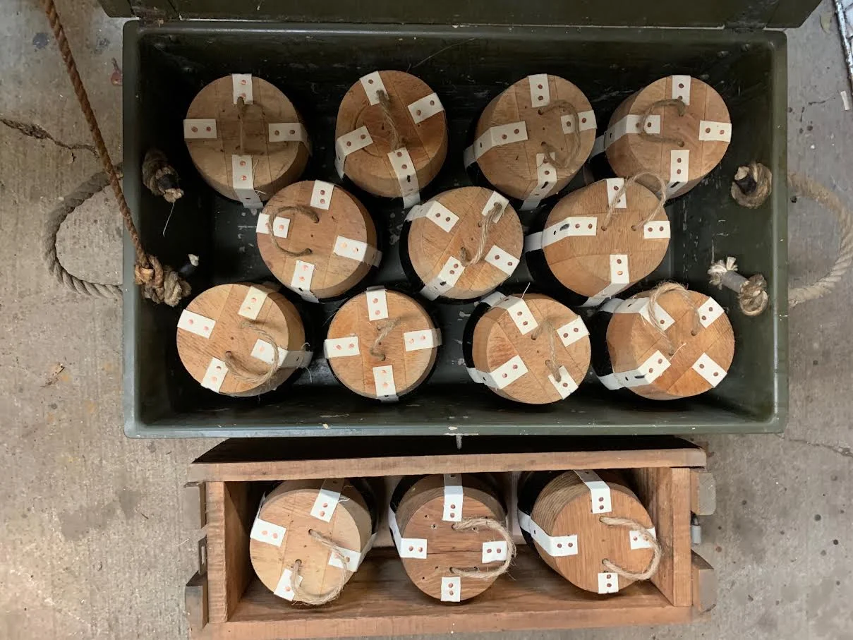

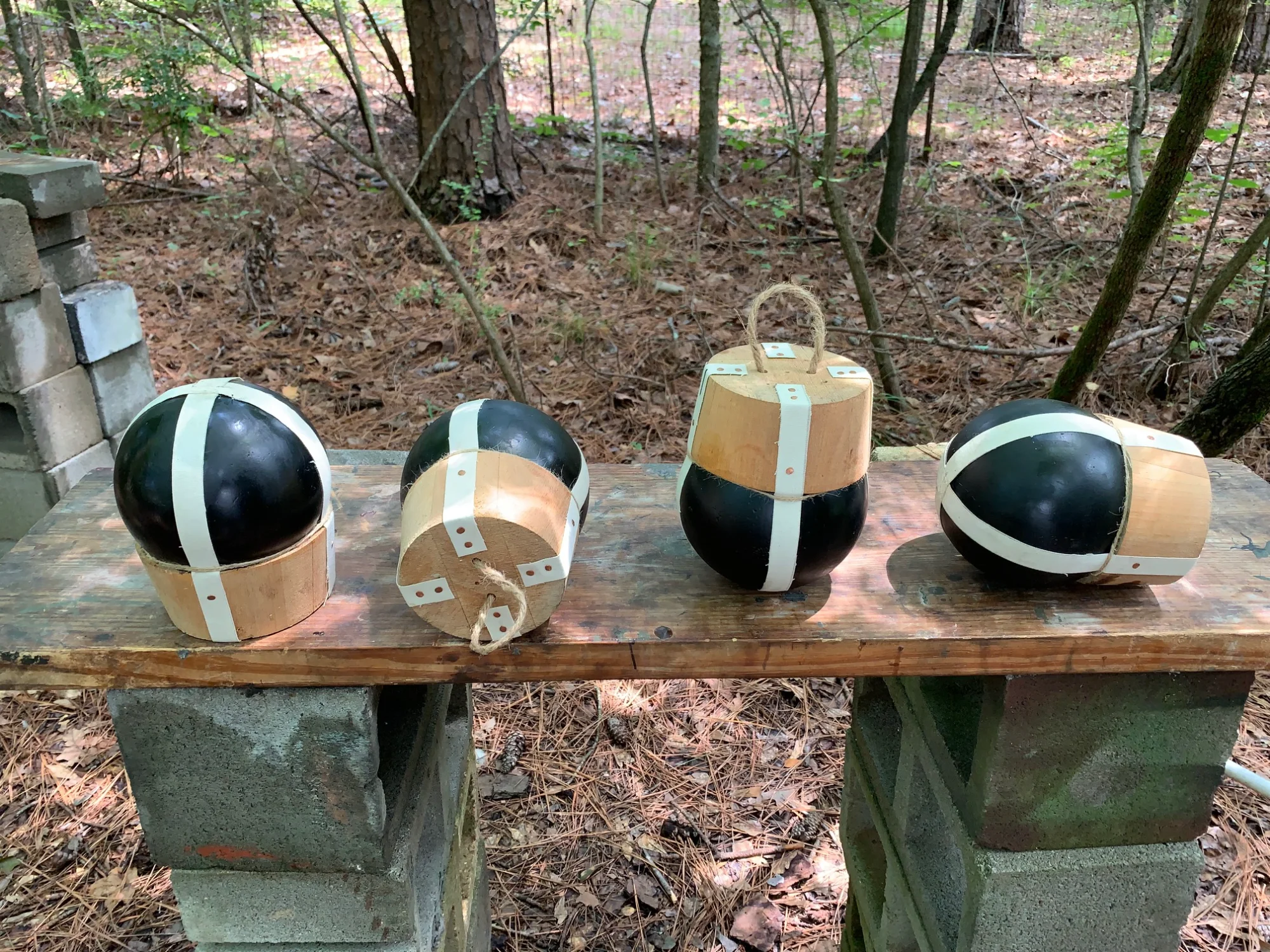

I have been manufacturing artillery ammunition for well over 50 years for both smoothbore and rifled cannon. But, until now I have never made any semi-fixed rounds. I am preparing ammunition to fire out of a 24 Pdr. Field Howitzer and have just finished the projectiles. I thought you might like to see what I have completed at this time. As per Gibbon's Manual, fixing the projectiles to the sabots can be done with either tin or canvas straps. I am using canvas straps sewn together at the intersection of the two straps and then glued to the shell just as Gibbon prescribes. To keep tension on the straps, I have pulled the straps tight to the projectile by wrapping twine around the ball where it meets the sabot. Semi-fixed ammunition also has handles made of cordage to assist in handling. The handles are attached at the back of the sabot.
Soon I will start work on the powder cartridges which will have a cartridge block as per Gibbon's to give a finish to the cartridge and fill the chamber. I will keep you informed as I continue on the project.
