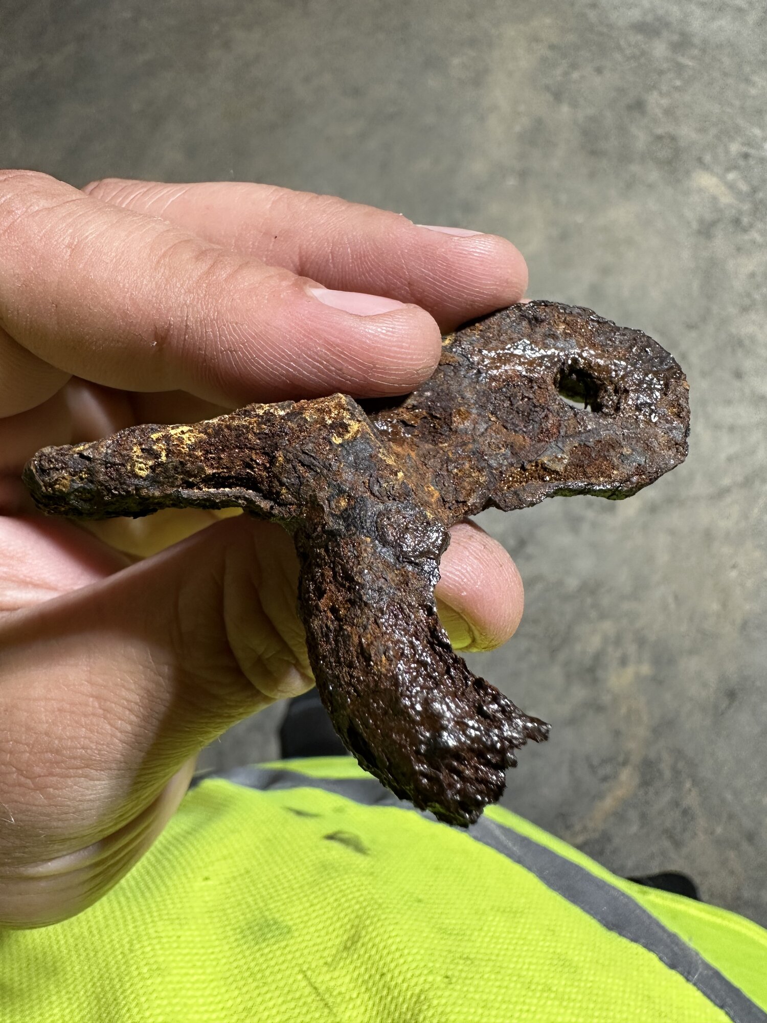

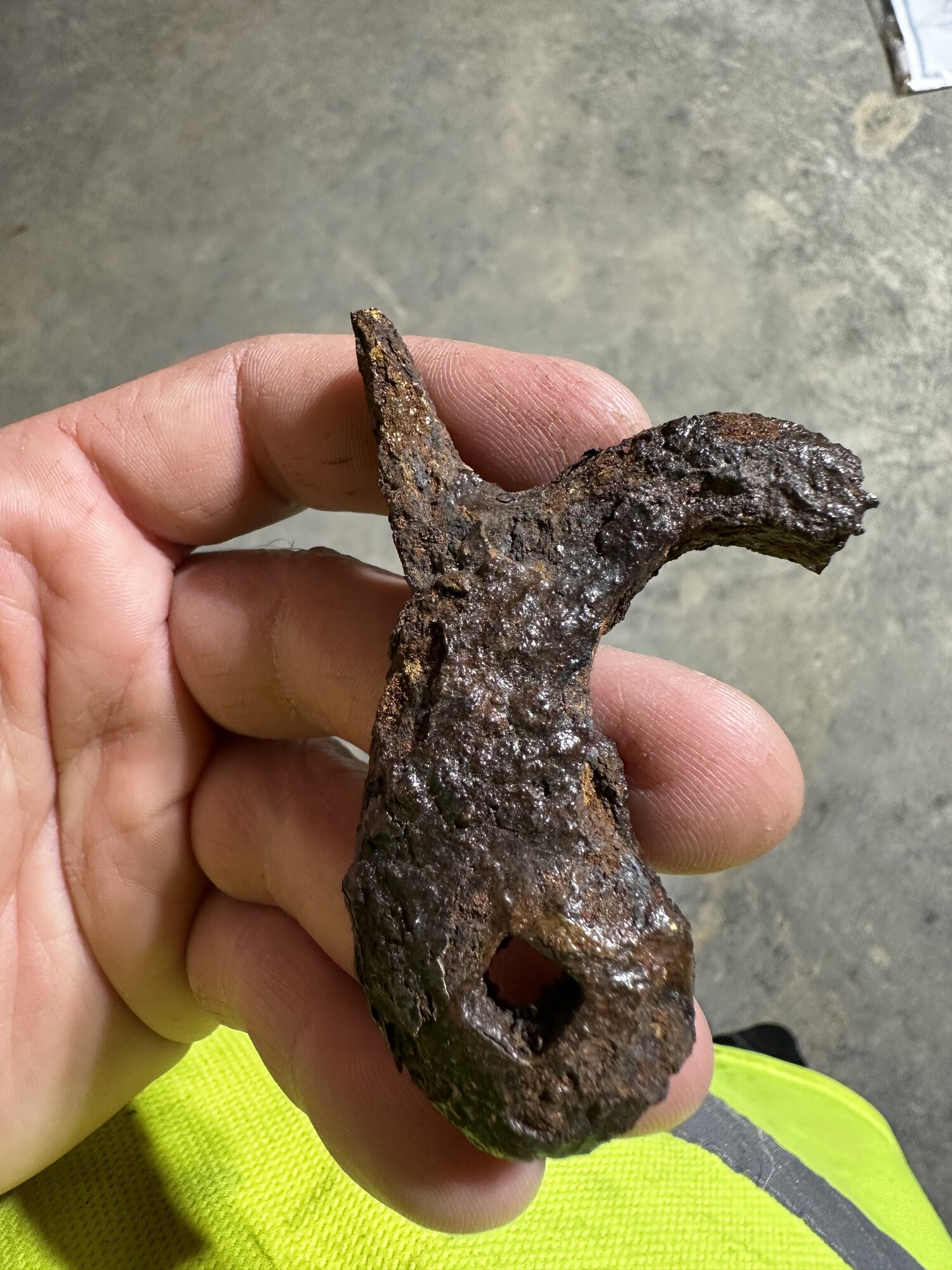

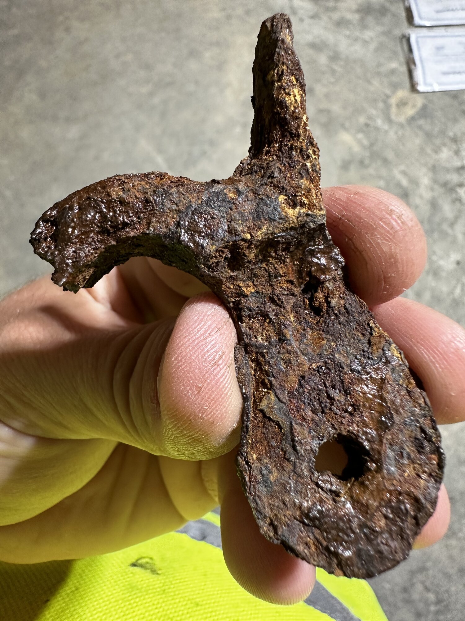

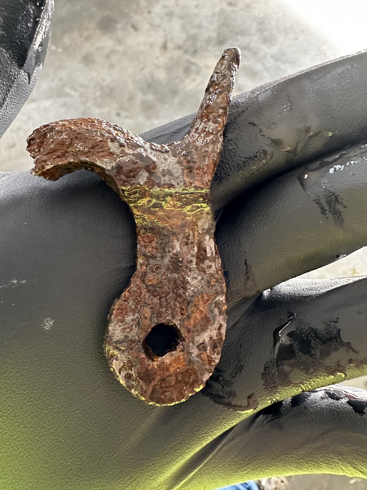

Its hard to say and depends on the amount of rust. I always do electro. Post a photo as there are other ways to deal with the rust.
Wow, thats going to take electro. Did it come from salt water?
As bad as it is, the best thing is to get as much rust off as you can, then put it in the over on a low heat 250 for an hour to get the internal moister out then hit again with the brush and then cover with Gemplers. If you don't the the moister out of the metal it will rust from the inside out. The Gemplers will help with that. Good Luck.

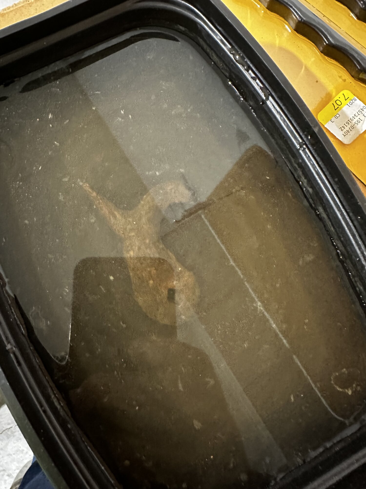

It only looks cloudy from me scrubbing it but no reaction yet has been 12 hours I'll let sit all day then just wire wheel the heck out of it
White vinegar = 24-48 hours BEFORE you start with a wire brush and then repeat. It is not a miracle cure. Heat will flake off a lot of the loose rust, but do not expect a nice clean surface. It will be well pitted. Electro is a bit quicker - but far more messy. You do have to get rid of the solution too.
Yes the white vinegar you told me about in another thread worked better. Had a 250 year old badly rusted sword blade. Rust Dissolver did not impress me even several times over. WD-40 coating over and over, copper wire brush, nah not impressed. But got a tube filled it with the white vinegar, stood it up, dropped the sword in up to the hilt, and 48 hours later. Worked great but made a hell of a mess. I should of used a bucket because it played havoc on the wash room sink. Heck of a clean up and you can still see some light staining. Only there is still light rust in the fuller of the blade. Now I'll lay the blade flat over a bucket and just put a little vinegar in the fuller for 2 days, see if that works.

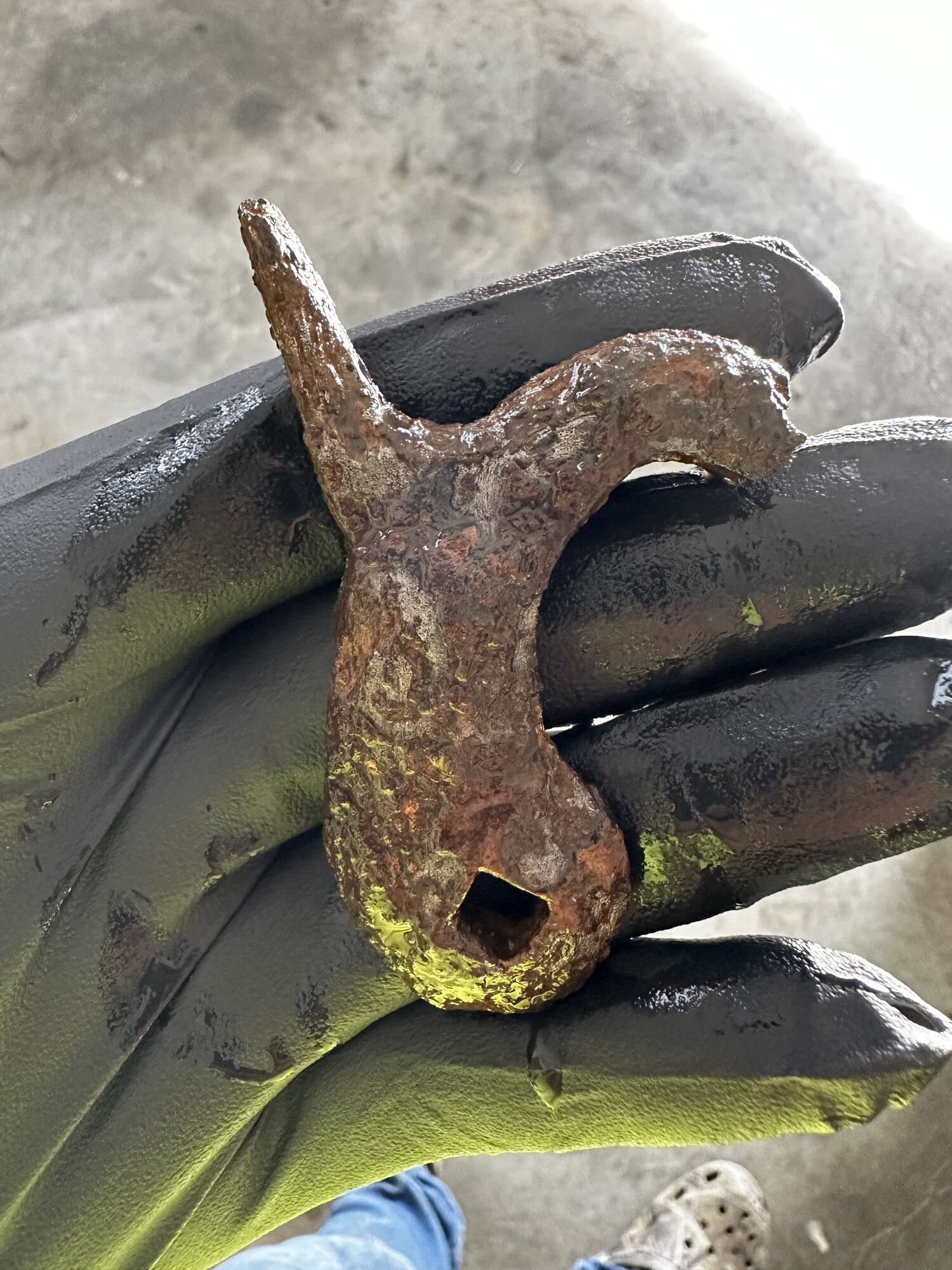

Here is an update after 24 hour soak no reaction far as dirty foam. But removed rust and have bare metal coming thru! I chip it lightly with slag hammer and brushed will let soak another 24 hours before I soak the hammer in a baking soda mixture to neutralize acid then bake and apply Gemplers
Have a hammer soaking in vinegar how long until I get a reaction? It's been 4 hours and not one bubble or fizzly bubbler just soaked in white distilled vinegar thank you for any tips I don't have electrolysis machine
You normally have to soak it for days. Vinegar is a slow but effective method.
