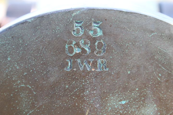

The Army had marking standards for the 1840's and 1861. Here is an Ames 6-pdr M1838 number 55, 689 pounds, inspector: JWR.

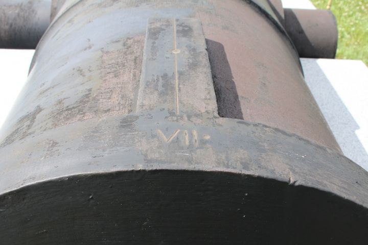

These things have markings everywere. Just to add insult to injury, WPF used roman numerals as foundry numbers for a long time.
