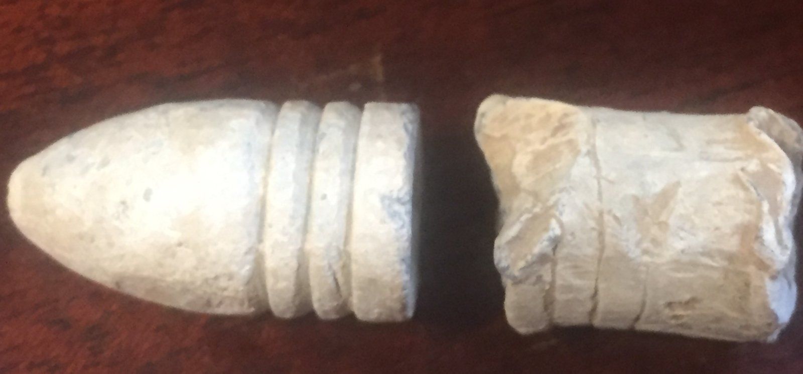

Not only that, but the basic premise of the Burton Ball was to have a thin skirt with grooves cut into it to act as almost an one way accordion effect that would compress and flare the skirt, so that the ball would engage the rifling. Many fired three ringers will show not only the rifling, but the thinner compressed grooves. Enfield bullets show the rifling a little better due to their smooth nature and lack of a vertical seam.
Visuals, I believe, are the best, in explaining these things. Here are a three ringer both dropped and fired, as well as a hard impact Enfield and a drop. You can see the rifling on both fired bullets and on the three ringer you can also see the compressed rings, that are now little more than a pencil line. The compression and friction both cause this effect when fired from a rifled barrel.
You can easily see the rifling on the Enfield and can see where the skirt has flared a bit on both.
These were just examples I had on my desk and easy to demonstrate the differences. Other rounds will be different, such as breech loaded carbine bullets as they were better fitted to the barrel and will usually demonstrate better rifling groove markings on fired rounds.
