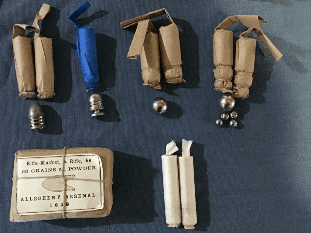

An original .58 minie cartridge...
The only negative with this, when blank firing, and perhaps ramming such a "stuffed" cartridge, is it adds to the burning paper fragments on firing considerably, so I can't recommend it.

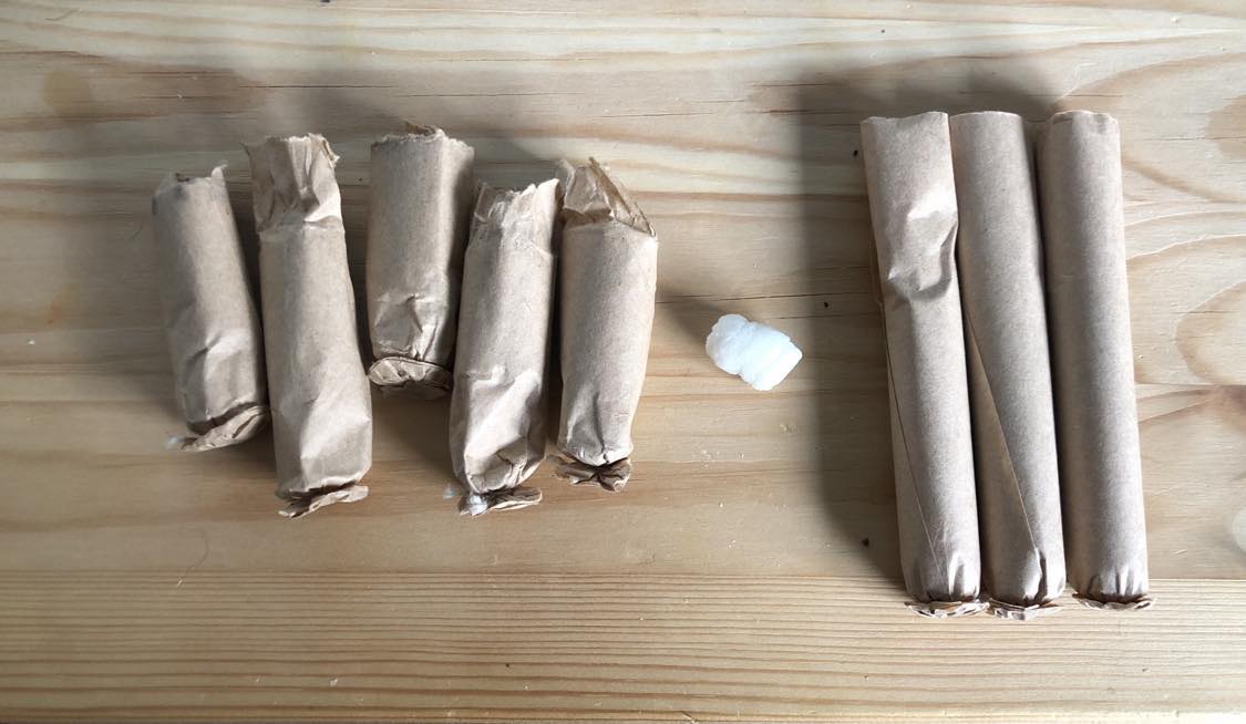

The cartridges here are a special order he made for me filled with lead bullets and foam. To show people how they look and weight.
And the other way around. With a bullet made up of cornfoam.. ready to be filled with powder.
If rammed with the paper the "bullet" mostly survive, but rammed without the paper it mostly burns up.
It fly like 2-3m so less than the distance the burning powder can cause issues.

Me using one of his blanks. (in this case I remove the bullet from the paper and only ram the bullet)
They do improve the experience since I can remove it from the paper, ram it and it result in a bit of recoil and the sound is louder.
So the safety issue is not the cornbullet... but the use of the ramrod.
