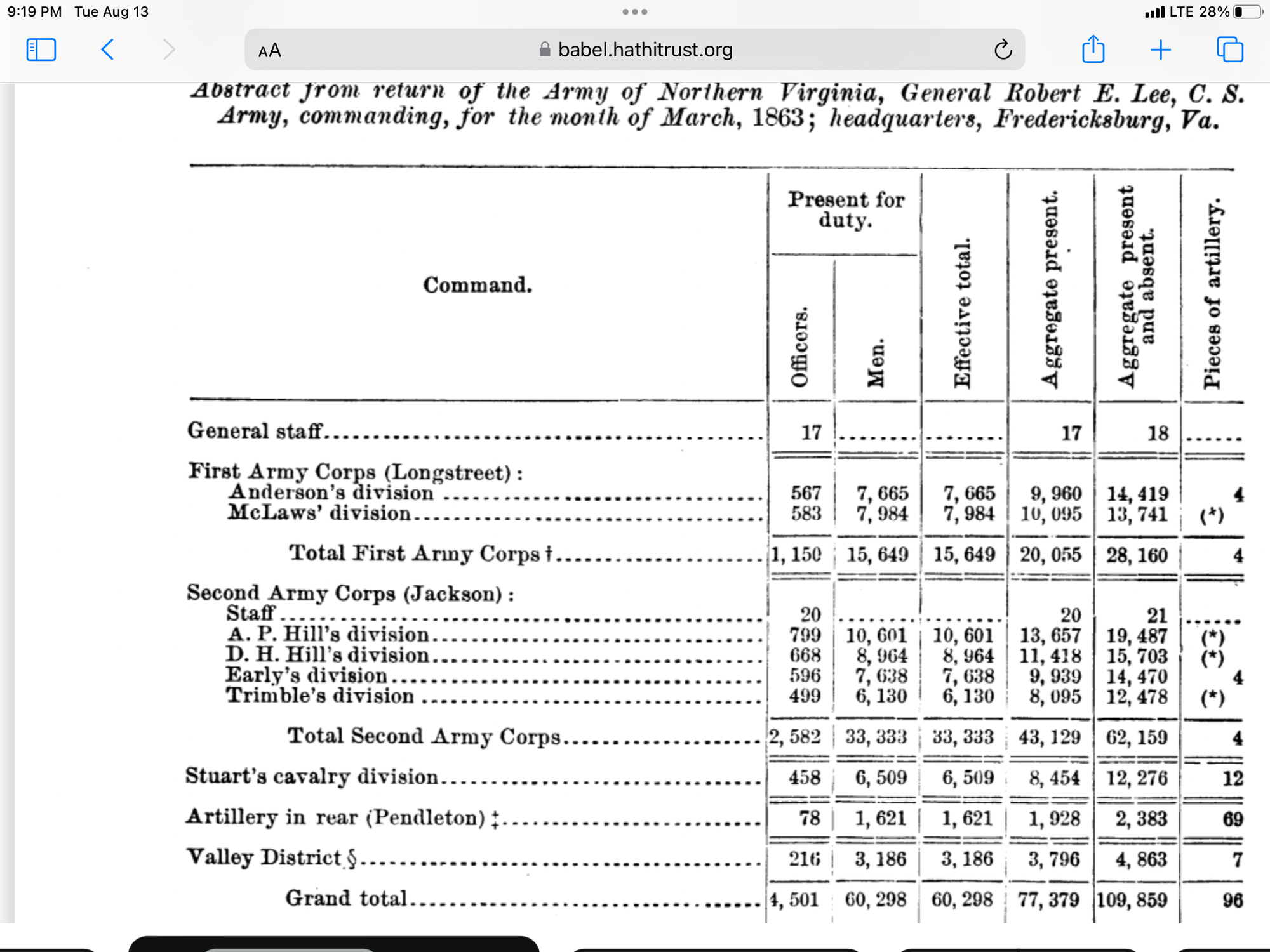

If you meant that such was the way in which things were done in the Army of Northern Virginia after Lee took command of the Army, well, that is unfortunately not accurate either. I could point you to any number of returns, but these will suffice. Here are the March of 1863 returns for the Army of Northern Virginia. They are exclusive, of course, of the Divisions which had been detached from the Army. They can be found at 25 OR 2:696:
As you can see, they are Present for Duty strengths of officers and men. This was true right through the war. You can see the same in regimental rolls.

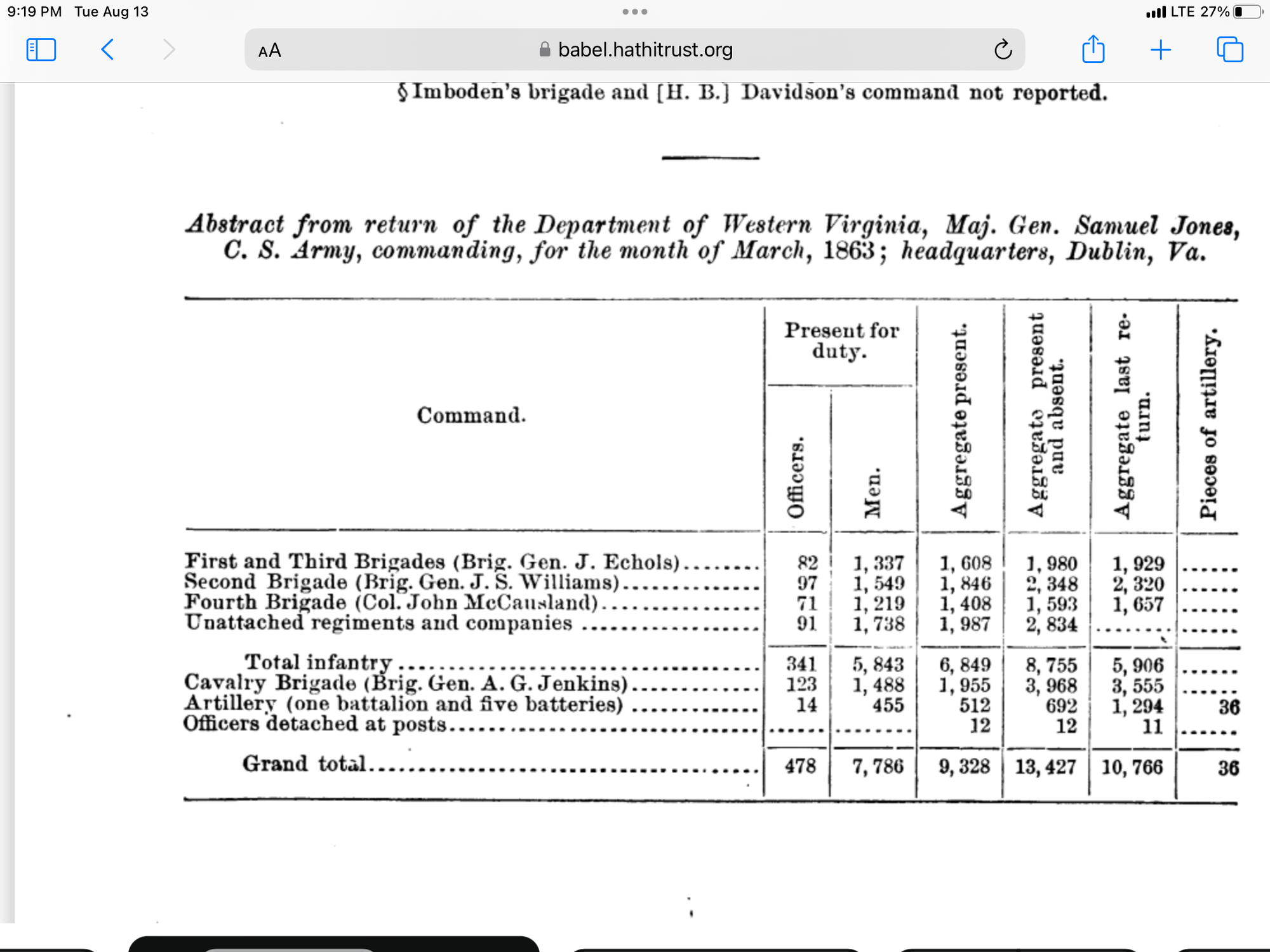

Right below them, on the same page, you can see the returns for the Department of Western Virginia, under the command of Samuel Jones, for the same month (March of '63). As can be seen, they are calculated in Present for Duty, officers and men.
You can find this right through the war in Armies across the Confederacy.
Yep, as you can see, the situation was as Taylor described it. The number of "effectives" is the number of enlisted fighting men, exclusive of the logistics. Troops with the logistics were carried under aggregate present, but not under "for duty."
Now, with Johnston he appears to have included officers with effectives in his returns, but it is uncertain what is going on with the memos of 30th April and 20th May. Since most of the numbers are the same, which is unlikely, it's very unclear, but the best we have...
