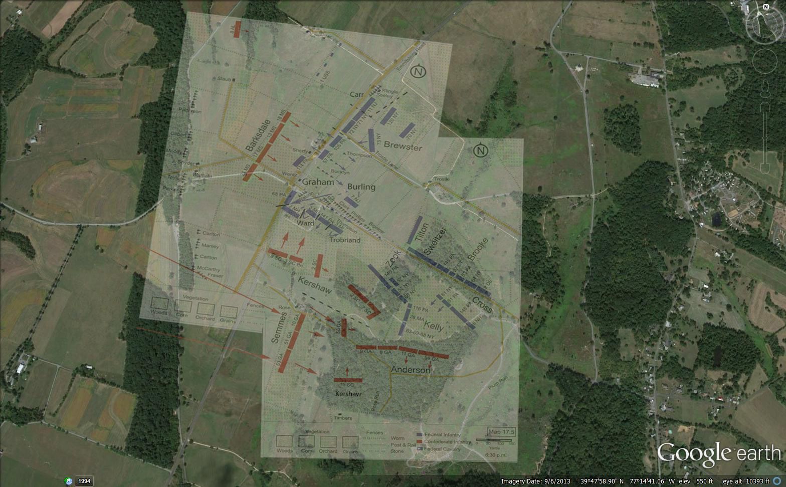

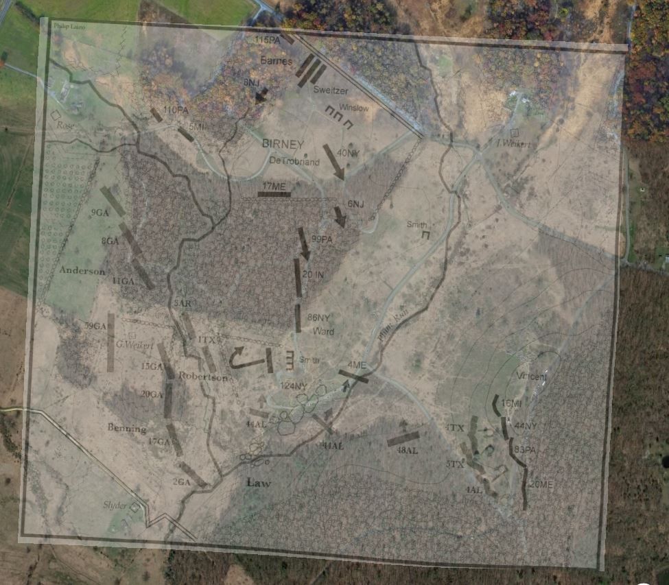

A few of us did some map overlays of Gettysburg that you might enjoy checking out :smile: We're going to have to start cataloging our cartography on the forums! :wink:
I would love to see your maps. I got to got to Gburg 3 different times for several days at a time in the Spring and Summer of 2016. I'm particularly interested in the wheat field and triangular field.
Here are a couple that I did- one is an overlay and one is a buffer map I made showing monuments at least 100m from the main tour route :)

Here are a couple that I did- one is an overlay and one is a buffer map I made showing monuments at least 100m from the main tour route :smile:
