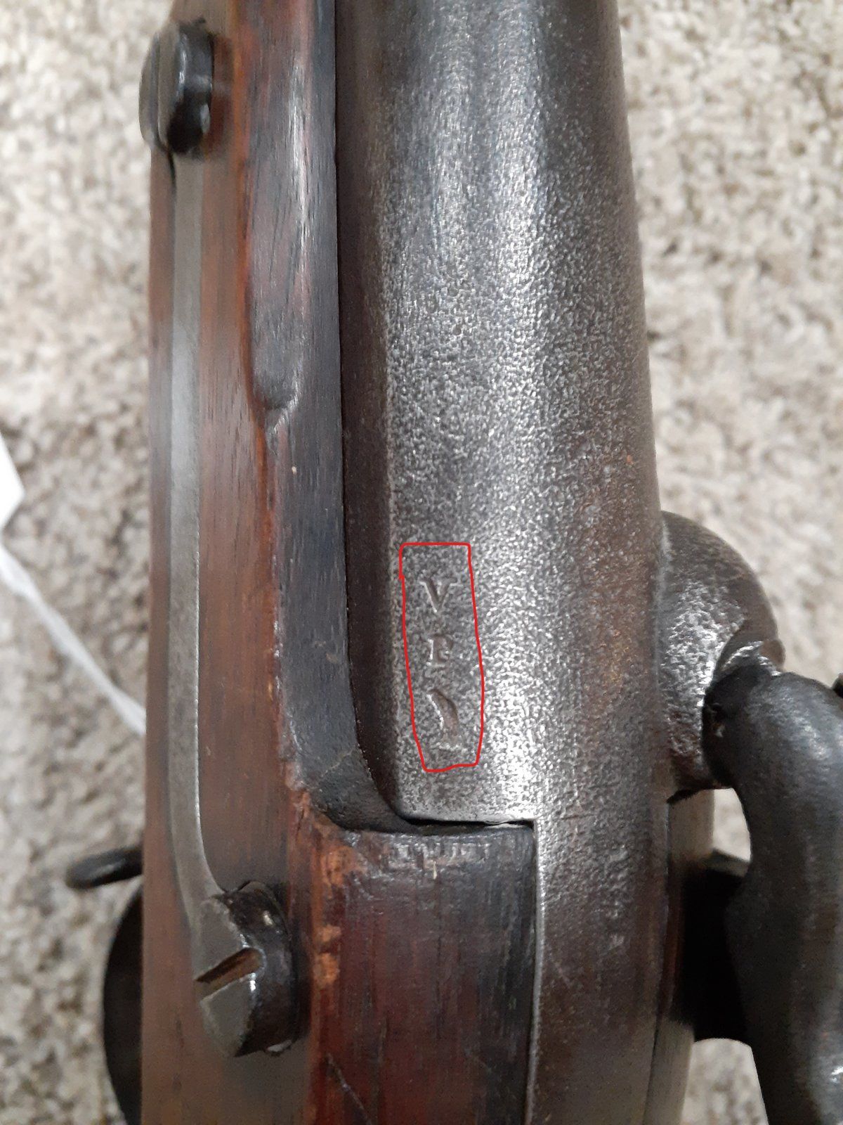

I just picked up a Palmetto marked musket. It has a V P and what could be a palmetto. There is no Wm. Glaze anywhere that I can see. Additionally there is no SC on the barrel. The butt tang has a nice US. The lockplate has the Palmetto mark and the S C. The word Columbia is hard to read and anything under that is beyond my ability to read. The barrel from breech to business end is about 43". I understand from an earlier exchange that the factory did alot of conversion and repair work. Since the barrel is stamped 1846 I would assume (or hope) that this is the case. Where the butt tang came in I couldn't say. Photos are attached. They are as good as I could get as was my level of cursing. So please help brothers and sisters. Enlighten me. Thanks H

Thanks. That makes a lot more visual sense. Now help a fellow Buckeye out. What does the eagle head mean? Ignorance is not bliss but it is my natural condition. H

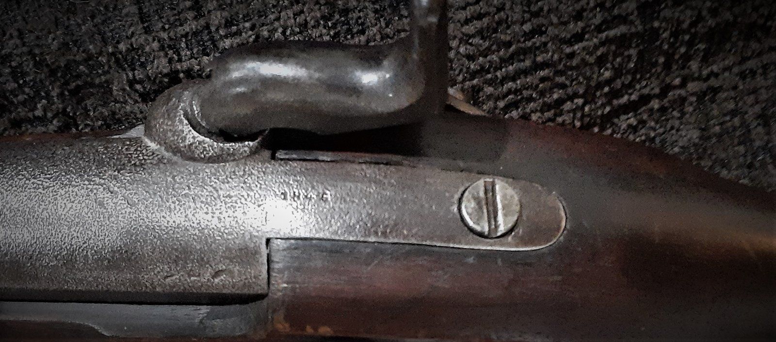

The barrel on your gun is from a US Model 1842 .69 cal., smooth bore musket, assembled by Flagg {with leftover Asa Waters} parts., on an earlier {pre-Palmetto} SC contract. It was US inspected at some time well before it went on to a Palmetto musket, thus the "eagle head" on the barrel.

Breech area of same. Note the "Eagle". My bar code is the "15" I've had this one a very long time..(1063 now)
