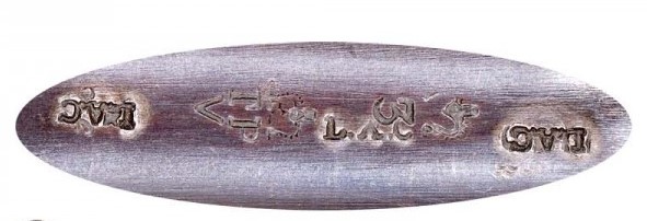

Further research reveals that some London Armoury Company often did not have proof stamps on the barrel, but often replaced them with their own LAC stamps.
From College Hill Arsenal:
A small number of examples of L.A.C. made guns with Confederate provenance, including Confederate inventory numbered examples exist that do not have London commercial proof marks, but are rather stamped L.A.C. three or four times. As failing to have a barrel proved at the proof house by a London maker was one of the most serious crimes of the period, it would be an exceptional situation in which any gunmaker would have risked their entire livelihood to evade the Draconian English proof laws. It is my belief that L.A.C. guns so marked were being rushed out the door for delivery to their Confederate buyers and for whatever reason the management was willing to risk their entire business by failing to have the guns proved. Similarly, it is my belief that this gun was assembled with a barrel previously inspected, proved and marked for British military service. However, the need to get the gun "out the door", possibly as part of the Massachusetts contract resulted in the with the military markings being partially obscured by being over stamped with the L.A.C. mark.
(from a past example at College Hill Arsenal)
Barrels made for Britain had to be proofed and most of the other contracter got their's from the barrel-makers who would have their barrels proofed before selling on. LACo was the only contractor who made these rifles on a production line - every component made by them and to the same standard as Enfield but marked LAC then proofed by either London proofs or government proofs..
Yours does not have any LAC barrel stamps which suggests either 'over-restoring' as I stated earlier, or that is not an LAC barrel IOW a replacement. Any photos of the underside of the barrel may help in tracing its origin.
