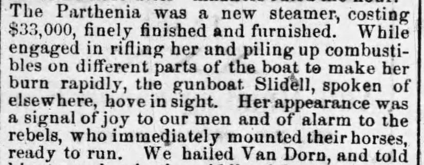

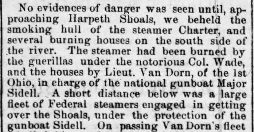

Below are attached are two clippings from that article. One is a clipping from column 2, followed by a clipping from column 3, which incidentally spells the vessel Slidell. Both clippings prove conclusively that the vessel was not Confederate, but Federal, as can be seen in the clipping below from column 2.
Likewise, the clipping from column 3 verifies that the vessel was Federal and captured by the Confederates. It is instructive that the Sidell is referred to as a (US) Army gunboat. This is the origin of the statement that the CSS Slidell was a "CS Army gunboat,"
Notice that this second clipping incorrectly spells the vessel as the Slidell, which may be the source of the confusion about which vessel is being referred to.
