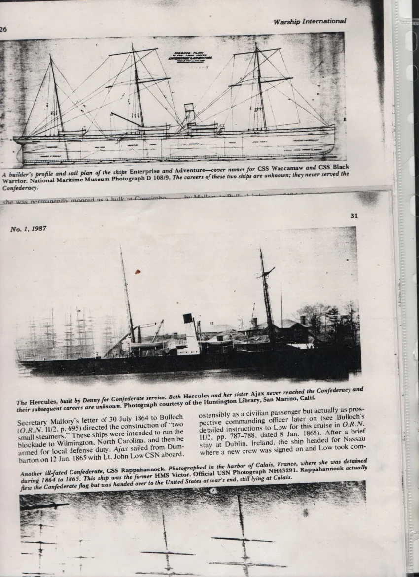

My apologies for the quality of these copies, they are many years old now, here are the vertical elevation plan for Enterprise & Adventure, and a poor photograph of Hercules. The latter originated with the Huntingdon Library, San Marino, California. Apparently taken alongside in Denny's Yard. the former is fromm the NMM collection.
My apologies for the quality of these copies, they are many years old now, here are the vertical elevation plan for Enterprise & Adventure, and a poor photograph of Hercules. The latter originated with the Huntingdon Library, San Marino, California. Apparently taken alongside in Denny's Yard. the former is fromm the NMM collection.View attachment 574831
Thank you so much! They look just like how I remembered them!
