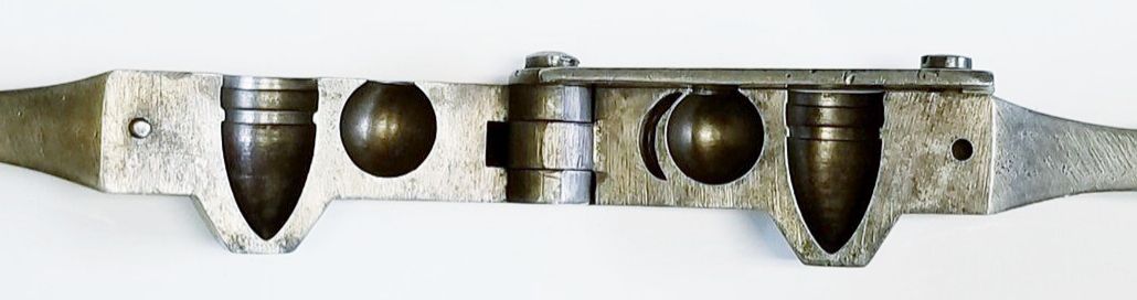

Can anyone identify this .44 bullet mold. I thought it was a Colt, but perhaps it's a Remington. It has too much corrosion to see any markings. The feature that I find unusual, at least different from a Colt, is the bump where the conical mold is. Any info would be appreciated.
It appears that it a standard 44 cal pistol bullet mold that would fit any 44 cal revolver. If it was a Colt bullet mold, the mold would be mark Colt.

Perhaps I should not have been so terribly brief when I wrote: Allen & Wheelock mold for their Army revolver. (My post #5)
The "drop" in the block that facilitates the conical bullet is only found on the Allen & Wheelock mold. All other makers, including Colt, Freeman, Manhattan, Mass Arms Co., Remington and Whitney had blocks that had a straight contour across the bottom.
(L to R) Allen & Wheelock - Colt - Freeman - Manhattan - Mass Arms Co. - Whitney
The mold in the original post can easily be discounted as a Remington mold for two obvious reasons. 1) Remington used a screw to hold their block halfs together. The mold in the original post uses a rivet. 2) Remington sprue cutters are full rounded at their top.
The other makers cut notches on both sides of the top of their sprue cutters to match the notches cut into their blocks.
The Remington sprue cutter hangs over the notches cut into their blocks.
Remington did not make a mold for their revolving rifle. In short the photos in the original post are of an Allen and Wheelock 44 caliber mold.
