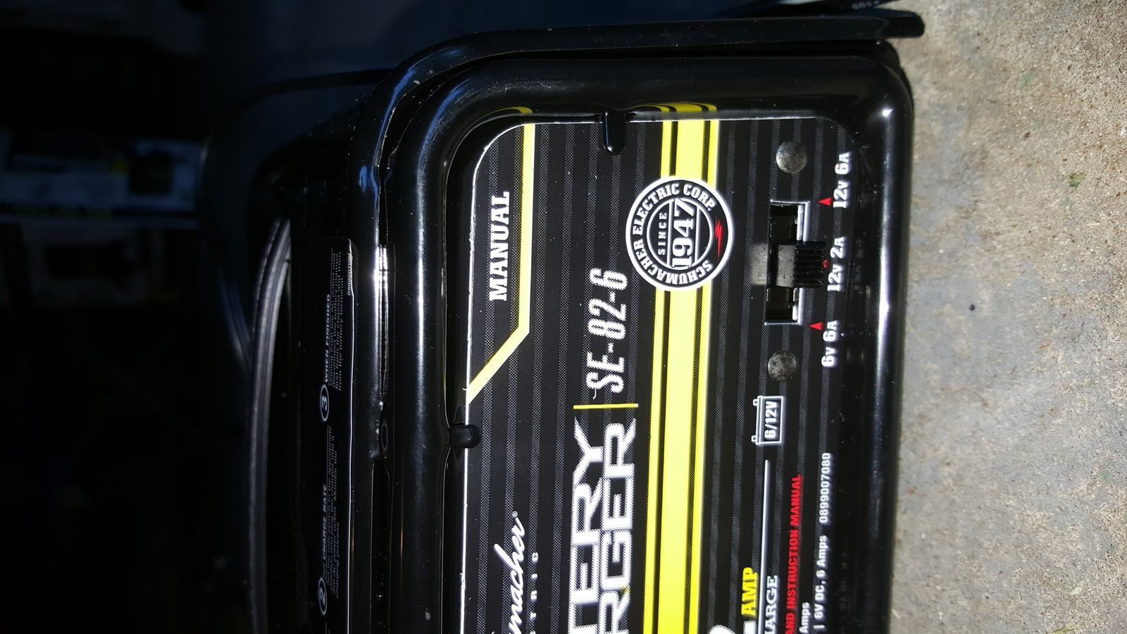

Ok men can not get charger to come on what next.View attachment 100002

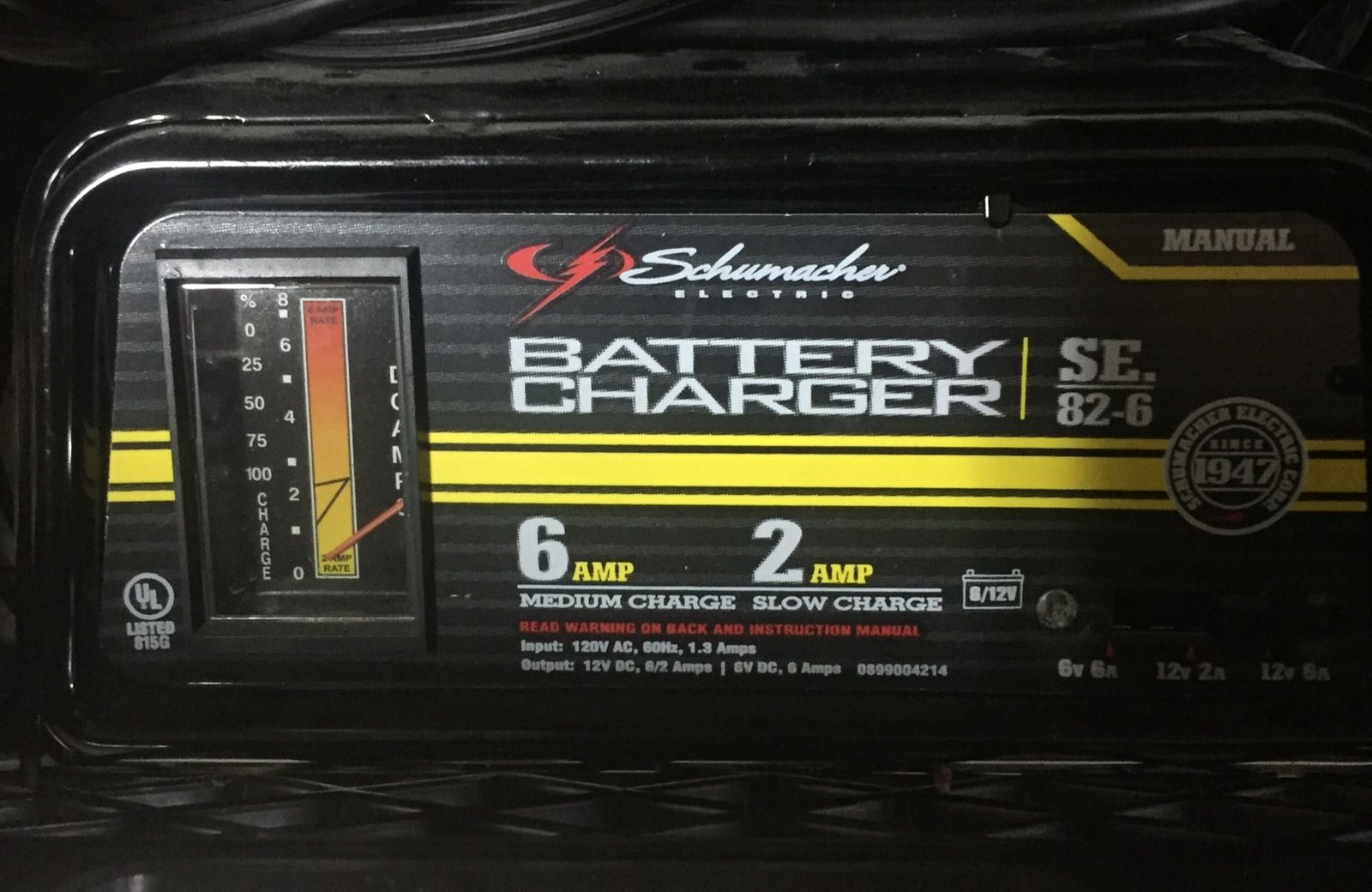

That is an automatic/voltage-sensing charger...
You have to have an analog/manual charger, such as:
Dirt cheap and available at any AutoZone, O'Reilly, Western Auto, NAPA, etc...

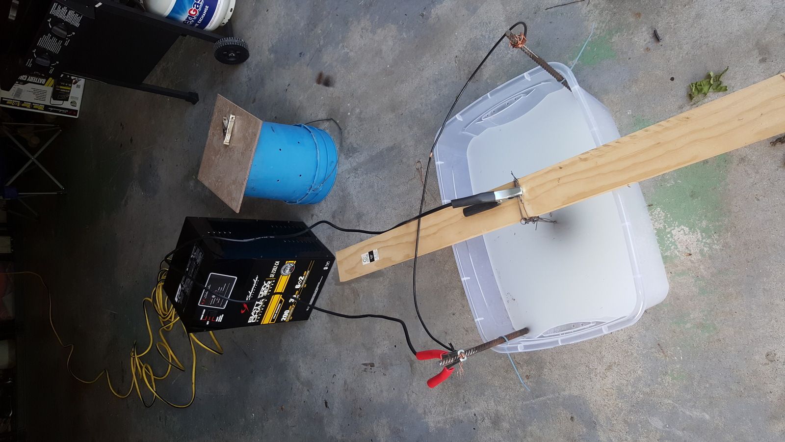

While the electrolysis process isn't going to be as dramatic in your situation because you are ahead of the game with little to no surface scale, rest assured that you are purging/drawing out years of what you cannot see - you want to 'slow cook' that solid shot.
Depending on your current draw, i'd recommend giving it 48 hours... Electrolysis doesn't effect the structural integrity of the 'good' mass so you have nothing to worry about.

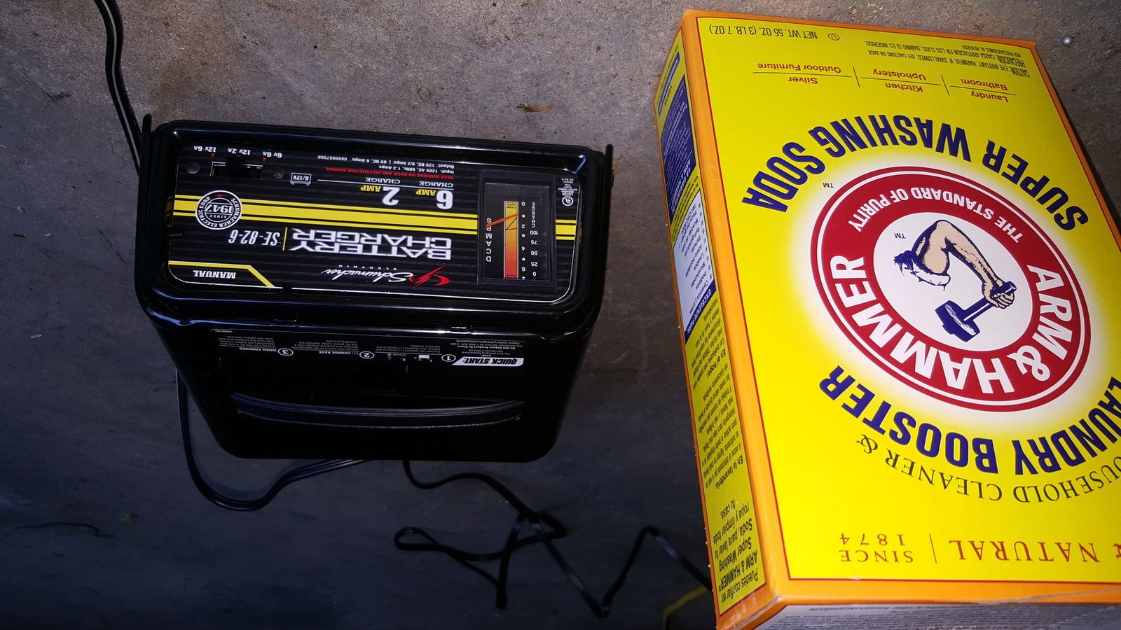

I used arm and hammer laundry boost will it be OK to let it run all night while sleeping.
I use A&H 'Super Washing Soda' - but if what you have is a sodium carbonate you are good to go!
You will be just fine leaving it overnight, as long as you have enough water covering the ball to offset the evaporation/wicking rate.
Electrolysis does off-gas hydrogen, which under the right conditions can be combustible - so while you don't want to run your dip tank in a teeny-tiny enclosed room - a garage or similiar will provide plenty of air dissipation space.
