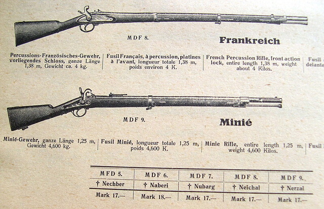

Yup, was lying upside down when I first looked at the chart.
From the German ALPHA catalog of 1911
That is the M1822 and a shorter version of the M1840.
In danish service they where shorten a bit and rifled in 1861 and then called "minieriffle af fransk model I" and "model II."
From a 1862 instruction book on arms for the nco school.
As can be seen the way the conversion from flint to percussion is not the same as this.
