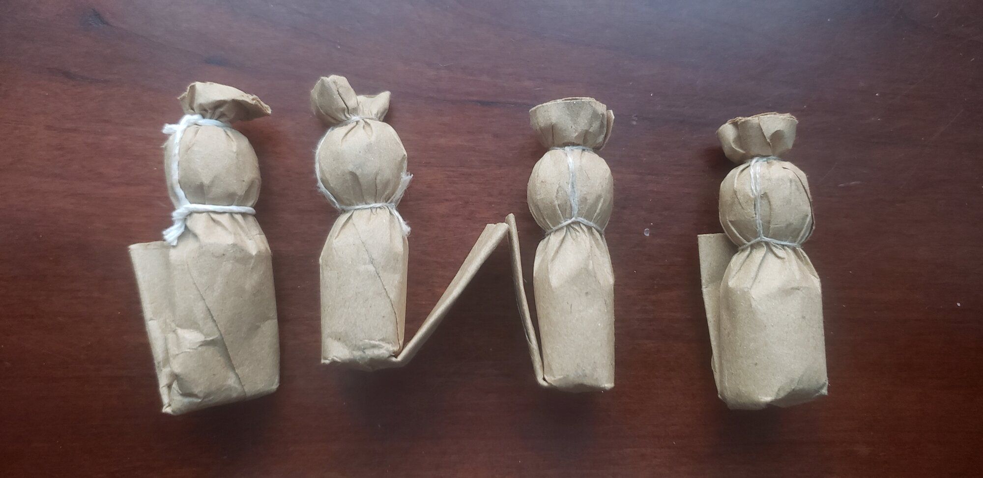

Been working on making musket cartridges. Do these look like they are suppossed to, anything I should change? They contain a .69 lead roundball and inert powder.
The cartridge on the right is perfect. The others look pretty good, particularly for practice.
Neat cartridges are necessary so they hold together in the cartridge box while "on the march." The shaking motion in the cartridge box can cause a lot of wear on 'em. Make sure you never confuse 'em with real ones if you fire authentic cartridges!
I used to use black sand for dummies, but then I thought that it would be even harder to keep 'em apart, so I started using farina/cream of wheat for the dummy cartridges.
Cartridges look good! But what grain charge are you using? The charge looks a little light to me.
I am just using black sand in two and black condiment powder in the others. I was more concerned with the way it was tied and the shape of it. I am incorporating these in a demonstration in old folks homes I do on Civil war gravesites and musket use.
For the flintlocks in .69 cal., the service charge was 120-grains of very coarse Fg powder. Fully ten to fifteen grains of that was intended to prime the pan of the musket.
It was shortly discovered that simply changing from flint to percussion ignition improved muzzle velocity, and the charge was thus reduced to 110gr. to 100gr. I don't think that whether or not the cartridge was made single-ball or buck-and-ball made a whit of difference in the powder charge, but I'd defer to people far more conversant than I about the paper ammunition.

I didn't do any gluing with these. Just cut the pattern, rolled and tied. I may try to also make the some for the Minie Ball but none of my muskets use that one. They are all smoothbore except for the Bridesburg Needham conversion. I would like to see yours sometime if you would like to post them.
I know you are not firing these but one comment I would make is the twine is too thick on the cartridge all the way to left. If you did try to shoot it depending on what size the ball is, it would probably be too tight for the barrel with that thick twine. Everything else looks good.
I made these from the left to the right. As you can see, I started using smaller diameter cord.
