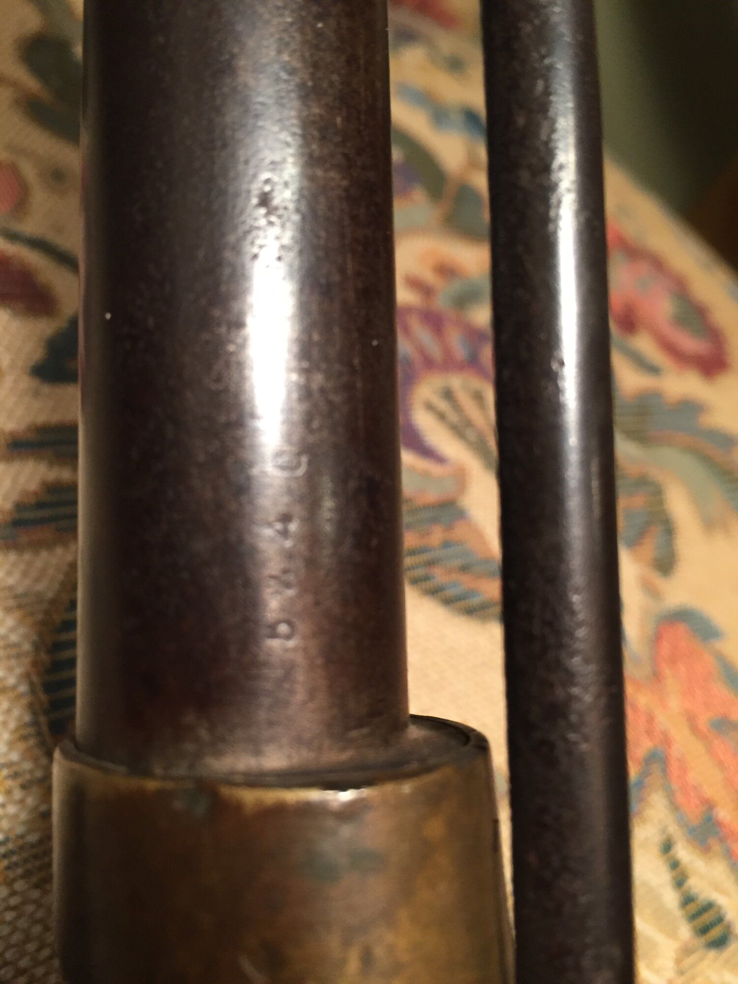

The clincher was the four digit number underneath the barrel in front of the upper band. When Colt performed its alterations in 1861-62 re-boring to .58, rifling for Minie ammunition and adding long range rear sights (same as on M. 1855 Colt revolving military rifles), it stamped a consecutive serial or alteration number on the underside of the barrel of each of the 10,411 altered. This gun has a still legible no. 5240 right where it should have.

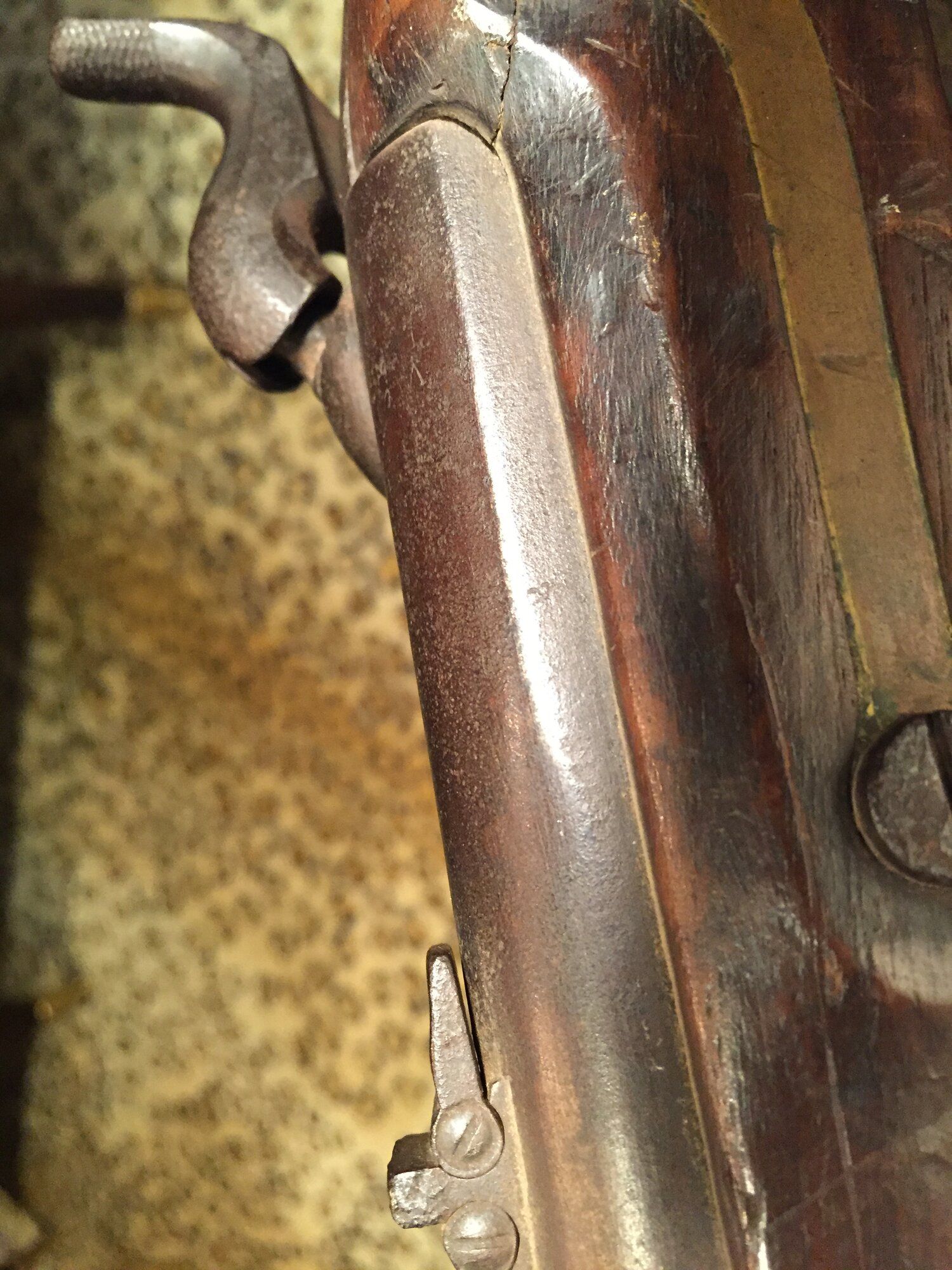

Colt also reproofed the barrels after re-boring them to .58. Per Moller, a "barrel reinspection mark, such as '200' or '3cc', is stamped into the barrel's left breech flat." This one has at least a clear "2" there.

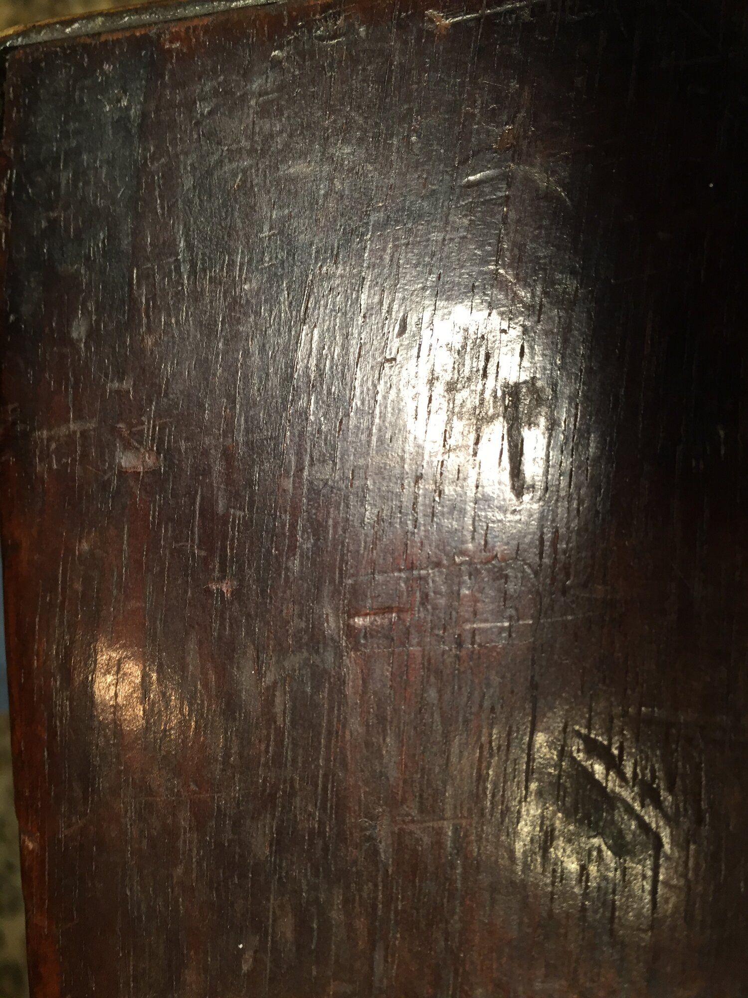

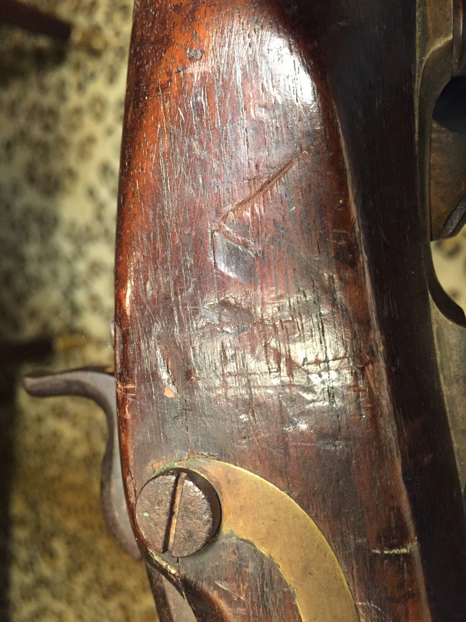

Moller also writes that "Most rifles are also stamped with a reinspection acceptance cartouche in the left side of the butt." This one has the faint outline of a now illegible cartouche on the left side of the butt, a few inches up from the heel (just below the shine in this picture):

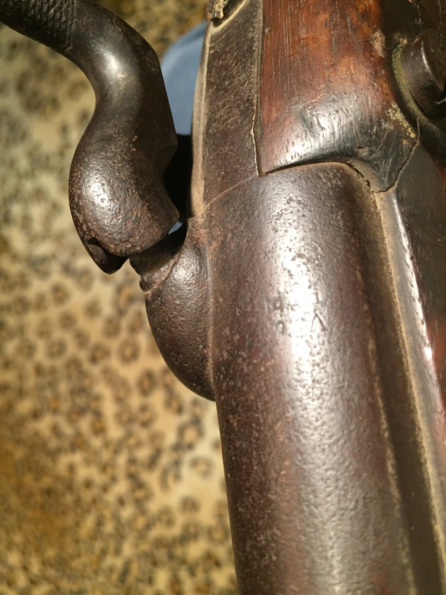

While pretty beat up, the left breech face also does seem to have faint outlines of two now illegible original acceptance cartouches:

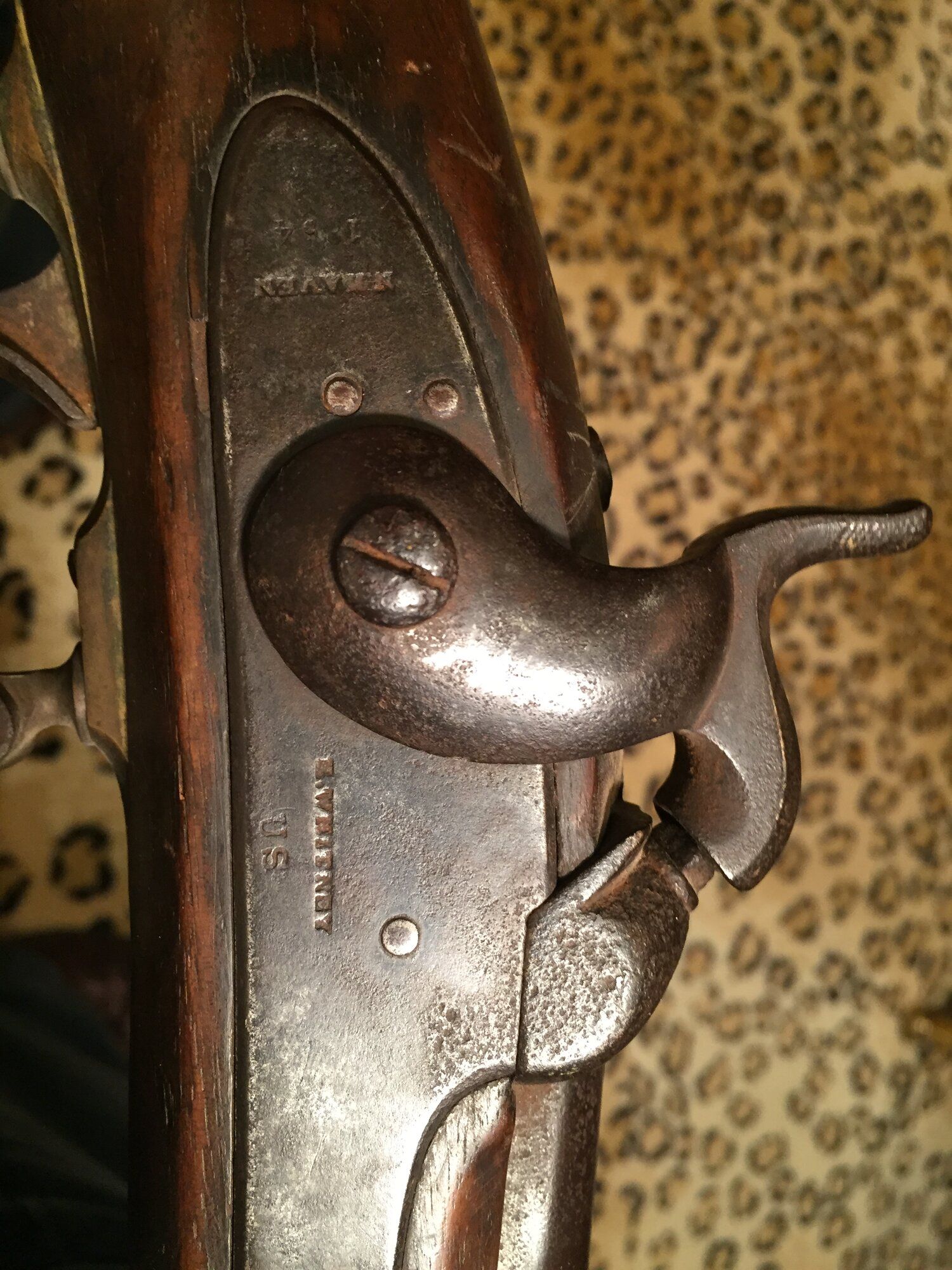

The gun saw a great deal of use and has heavy flash pitting around the nipple area, which has obscured the "U.S." (though I can see remnants of the "U" in strong light but it does still have the "S.K." inspection stamp and the original "V P" barrel proofing stamps.

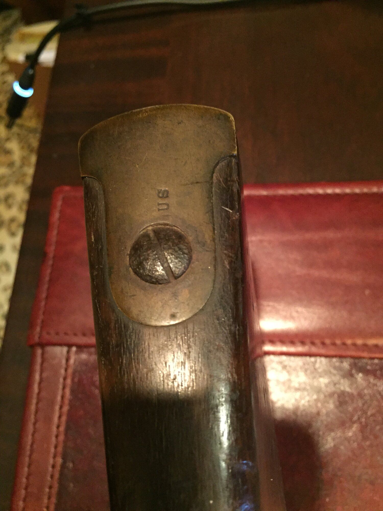

And of course the "US" on the butt plate tang.

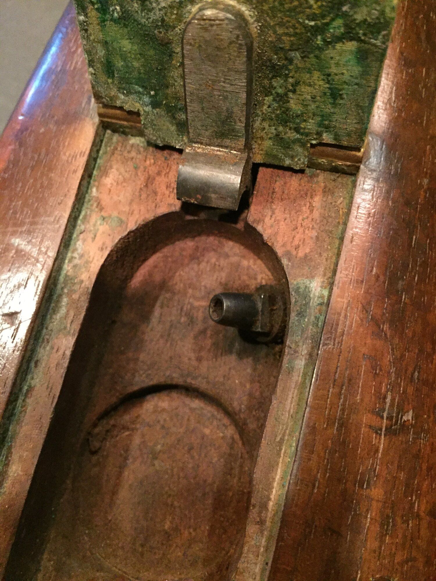

One unexpected bonus was a spare nipple inside the patch box.

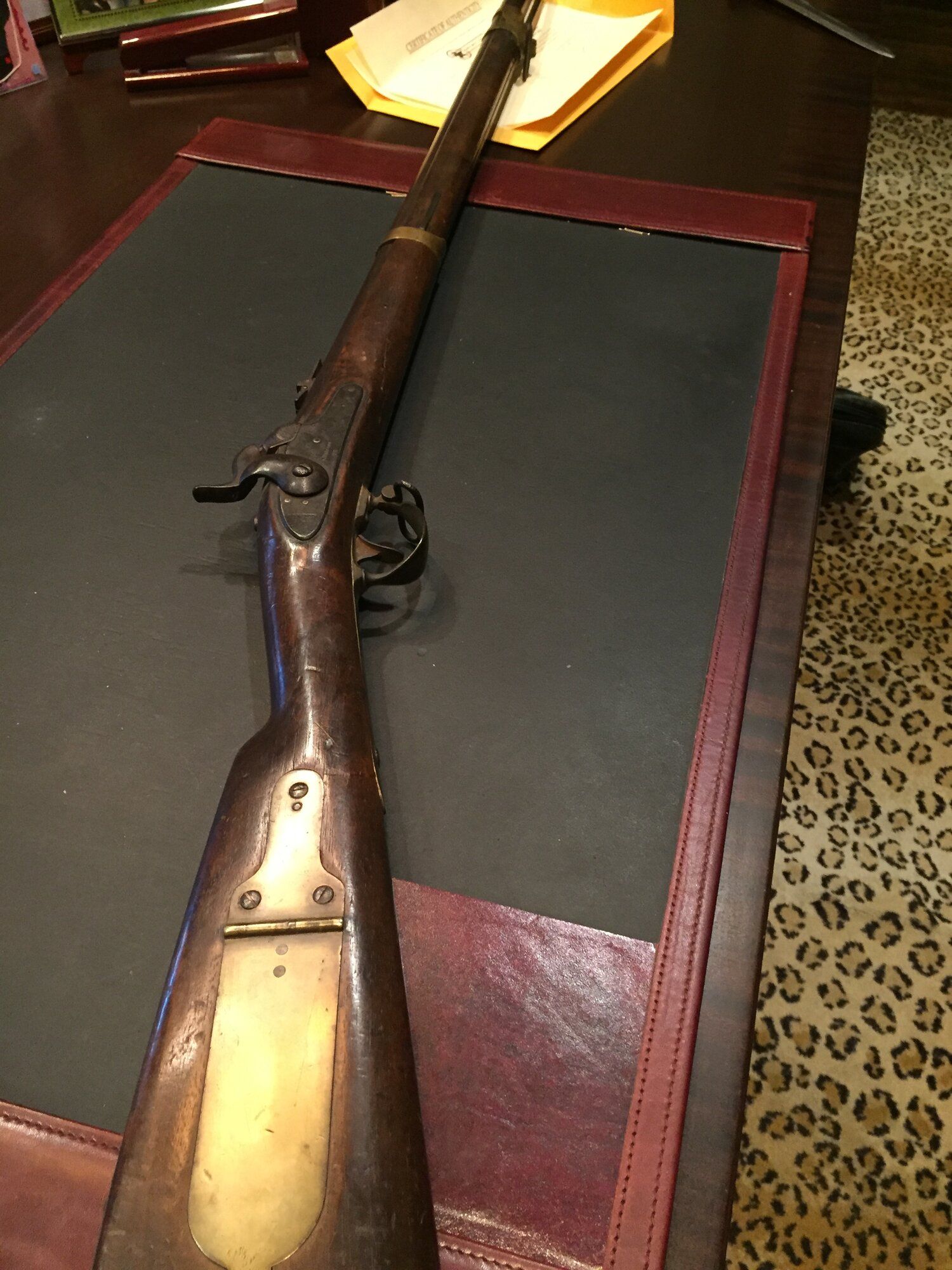

All in all, a good honest gun, and is the version of .58 caliber-altered Model 1841 most likely carried by my ancestor's battalion of the Third Iowa cavalry in Missouri in 1862-63.
