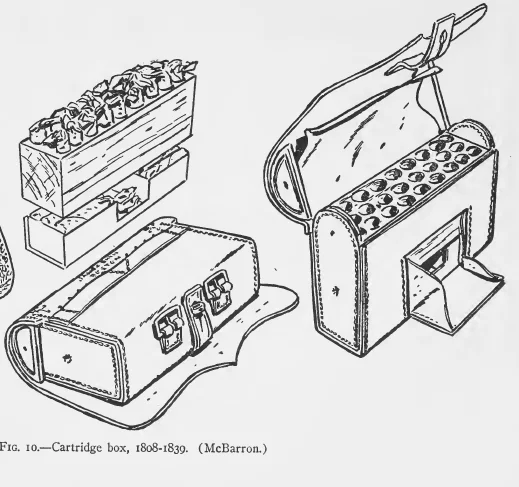

Firing a replica Charleville musket, I've found that maybe 25 shots with a perfectly tuned up and clean musket can be achieved (the US cartridge boxes for flintlocks generally had provision for 26 rounds in the wooden case, with a reserve below in the tin.

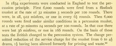

The British in 1834 estimated perhaps all told an average of one misfire in 6.5 shots for a flintlock, and one in 165 shots for percussion from their experiments:

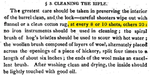

Indeed. From some reading of period sporting, rifles were supposed to wipe their bore between shots if possible.
That's even with the finer "rifle" grade of powder, which apparently gave less fouling than musket powder. For military purposes, the Duane's handbook of 1812 suggests wiping the bore at least every 8-10 shots...

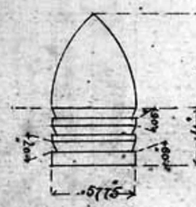

The US rifle-musket in .58 caliber loads with a minie type ball of .577 diameter.
