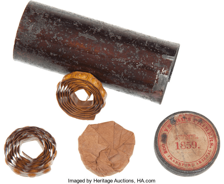

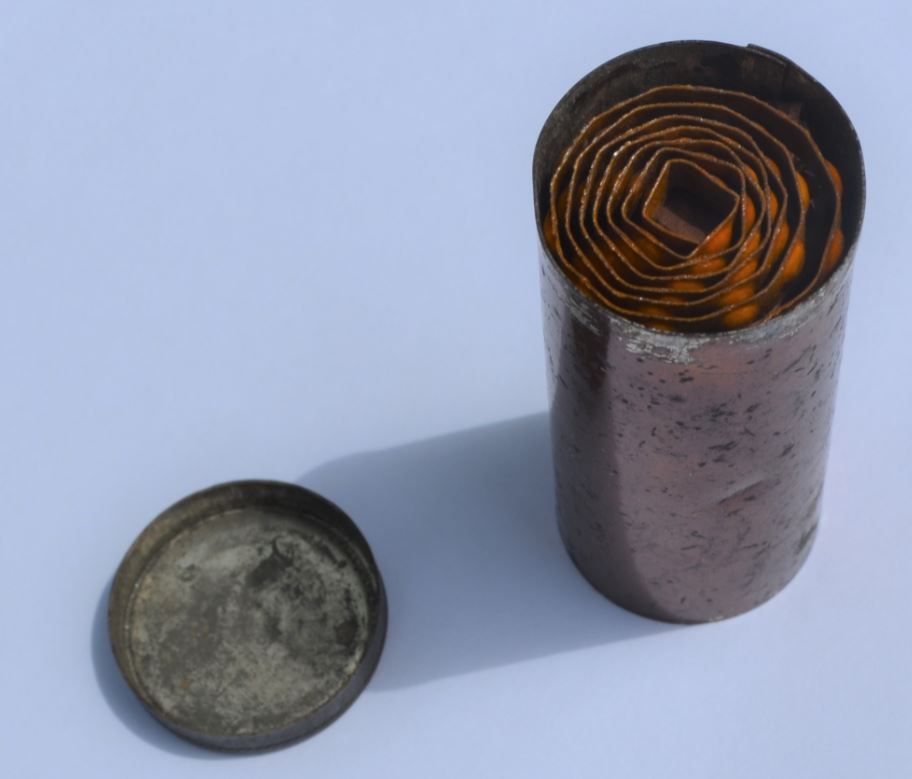

I have a Model 1855 rifle musket, and recently found some Maynard Tape Primers. I purchased a tin canister which contained 10 rolls of Maynard tape primer rolls. Nine are unopened and one was opened. The opened roll fit my Model 1855 perfectly, see photo. This caused me to wonder on how were the Tape Primers originally shipped to the men in the filed. Were they in tin canisters, like I purchased, or was that for civilian consumption. Any information on this would be appreciated.

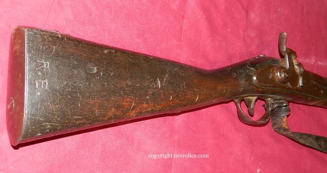

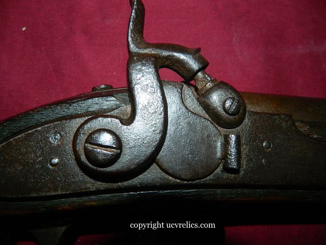

Here is an early musket from my personnel collection with the Maynard system. The Maynard primer system was a great concept and there were weapons from pistols to musket made for it, but it really didin't live up to expectations. Below is a tin from the Frankfort arsenal and as yours this is how they were issued.
Were the tins issued in an ammunition crate or separate? I would assume they would have been issued with the ammunition but I have seen several requisitions requesting primers.
Thanks so much, that is the first label I have ever seen! Appreciate the information!
