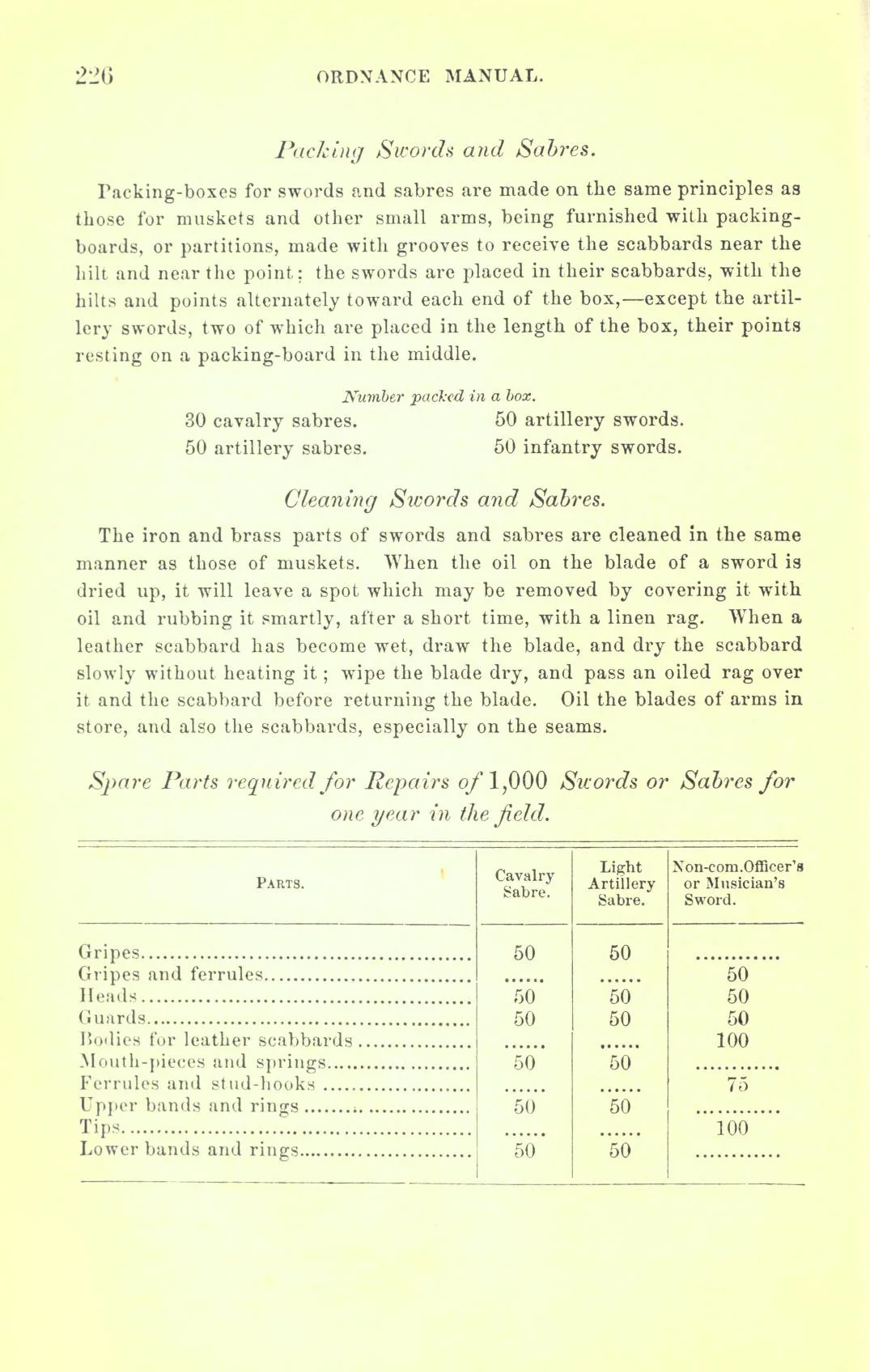

Left over inspected blades? The Ordnance book lists replacement sword parts.

It was a page I was remembering but there are no blades mentioned
