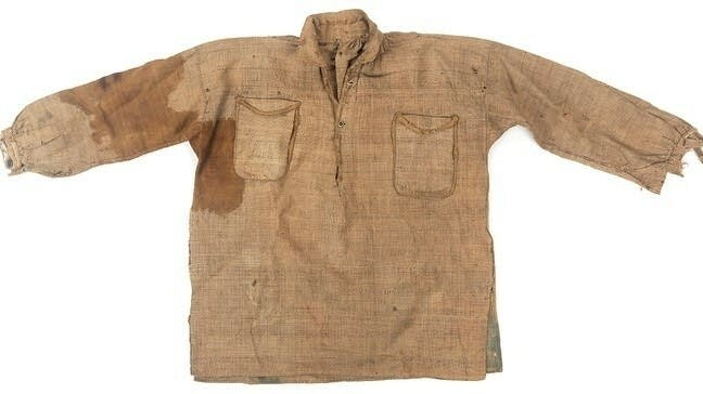

sometimes they had pockets fixed on the fronts. This is a Confederate soldier's shirt picked up at the Battle of Nashville.
