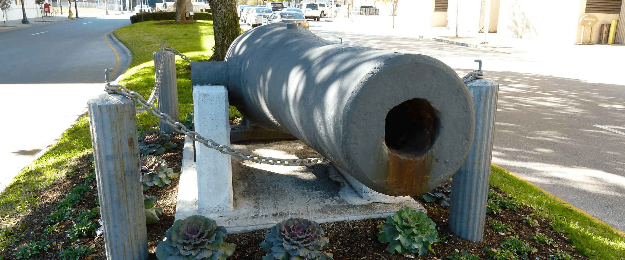

A 6.4" Anderson Rifle from Fort Powell, a surviving sister to Lady Polk & Belmont, located in downtown Mobile, Alabama - Images of this gun are

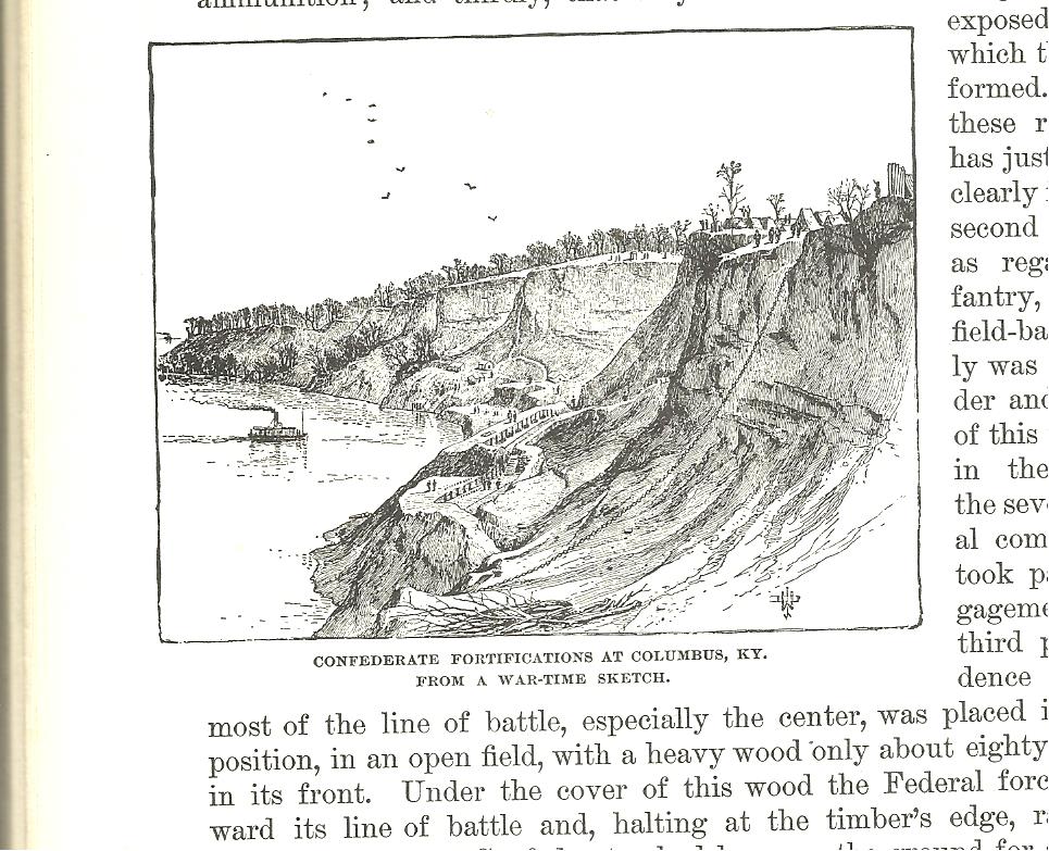

:CSA1stNat:The two most famous, and by far, the largest Confederate cannon at Columbus, Kentucky were the Lady Polk and the Belmont, 6.4 inch Anderson rifled columbiads made at the Tredegar Iron Works in Richmond, Virginia. Both were cast solid in the molds of huge Model 1861 10-inch smoothbore columbiad cannons, but bored and rifled as 6.4-inchers. The 10" Columbiad design was chosen with expectations that the thick walls of the barrel would provide sufficient strength for the guns to fire rifled projectiles. Both guns were a little over ten feet long, and weighed nearly 15,000 pounds each. Their solid iron rifle bolts were known to weigh up to 128 pounds each.

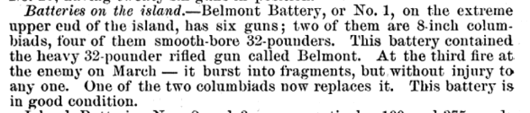

Only a few days after the Federal Navy began to bombard Island #10, on March 19, 1862, the Belmont gun burst while firing on the Yankee iron clad gunboats. The Belmont did not kill any of her gun crew.​

A 6.4" Anderson Rifle from Fort Powell, a surviving sister to Lady Polk & Belmont, located in downtown Mobile, Alabama - Images of this gun are View attachment 452289 FortWiki.com

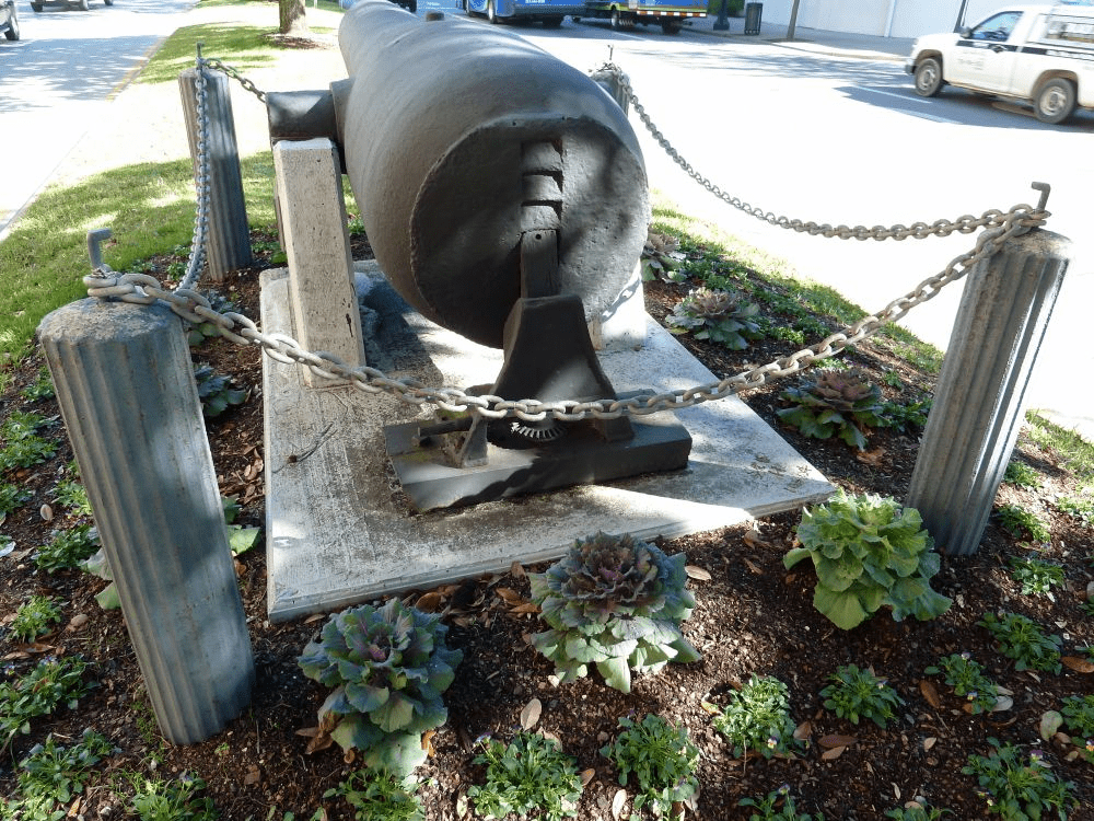

Here are 2 of the rounds fired by the surviving sister in Mobile.

I am in a bit of a hurry and am "thumbing" through this thread. The opening photo is of a sister cannon and not the original exploded "Lady Polk"? That one was lost in a scrap iron drive? But I understand the anchor and chain that was across the river during the battle was saved from that same scrap iron drive? It seems that I'm just full of questions this morning.
