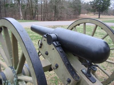

Any thoughts on the puddled wrought iron (semi-steel) rifle?
It is a stock photo of the Wiard 6-pdr cannon from on line so I am not sure it is a replica or not. Do they even make repilcas of these? My question is, why is their no cascabel to attach arresting ropes to deal with the recoiled of firing the cannon? The Wiard Rifle System must have dealt with recoil by another method.

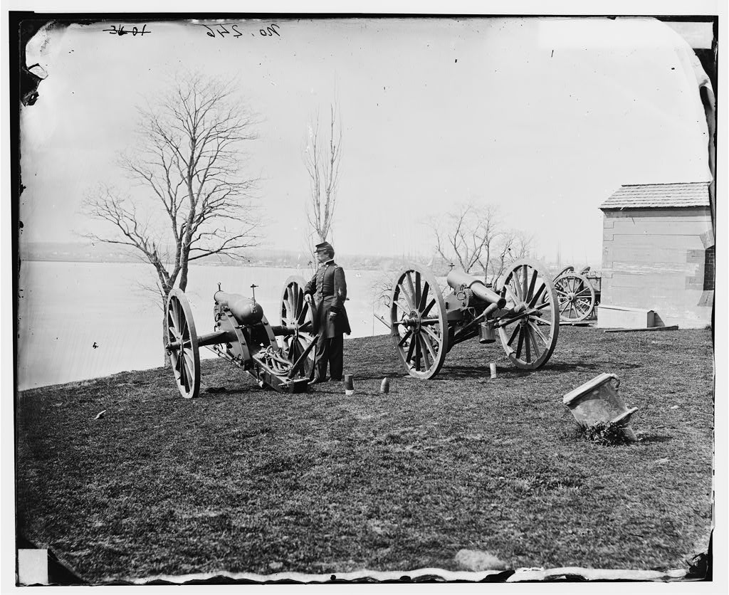

Wiard Rifles came in 6 & 12 pounders and besides not having a casabel, they had a rather peculiar carriage, unusual sights and the ability to be elevated much higher than a normal piece. Photo LoC
Cascabels were primarily used on ship board guns for obvious reason. Most land based cannons just recoiled back on there wheels.

Wiard Rifles came in 6 & 12 pounders and besides not having a casabel, they had a rather peculiar carriage, unusual sights and the ability to be elevated much higher than a normal piece. Photo LoCView attachment 305186
The LOC identifies the man as Gen. Daniel E. Sickles.
I think that aside from not having any sights installed, that appears to be the correct shape barrel for that piece.
I've seen one of these guns before and I think there are some sockets for the rear sight to fit into behind the vent hole. Looking at the glare in the photo, I don't see that.
If this gun is mounted on the battlefield the sockets may be filled, or the barrel could be upside-down... or it's a repro and they didn't bother with that detail.

The Wiard in this image is NOT a replica. This photo was taken several years ago at Shiloh. This particular 3.67 inch (12 pounder) rifle used to stand in front of the National Cemetery gates but it has since been moved to a new location. Shiloh has six wiards of this size as well as eight of the 2.6 inch (6 pounder) rifles. Over the last two years the park has purchased a number of replica Wiard carriages to display the tubes. These carriages have the unique teardrop-shaped cheeks as well as the wheels which were designed to be repaired in the field instead of replaced.
