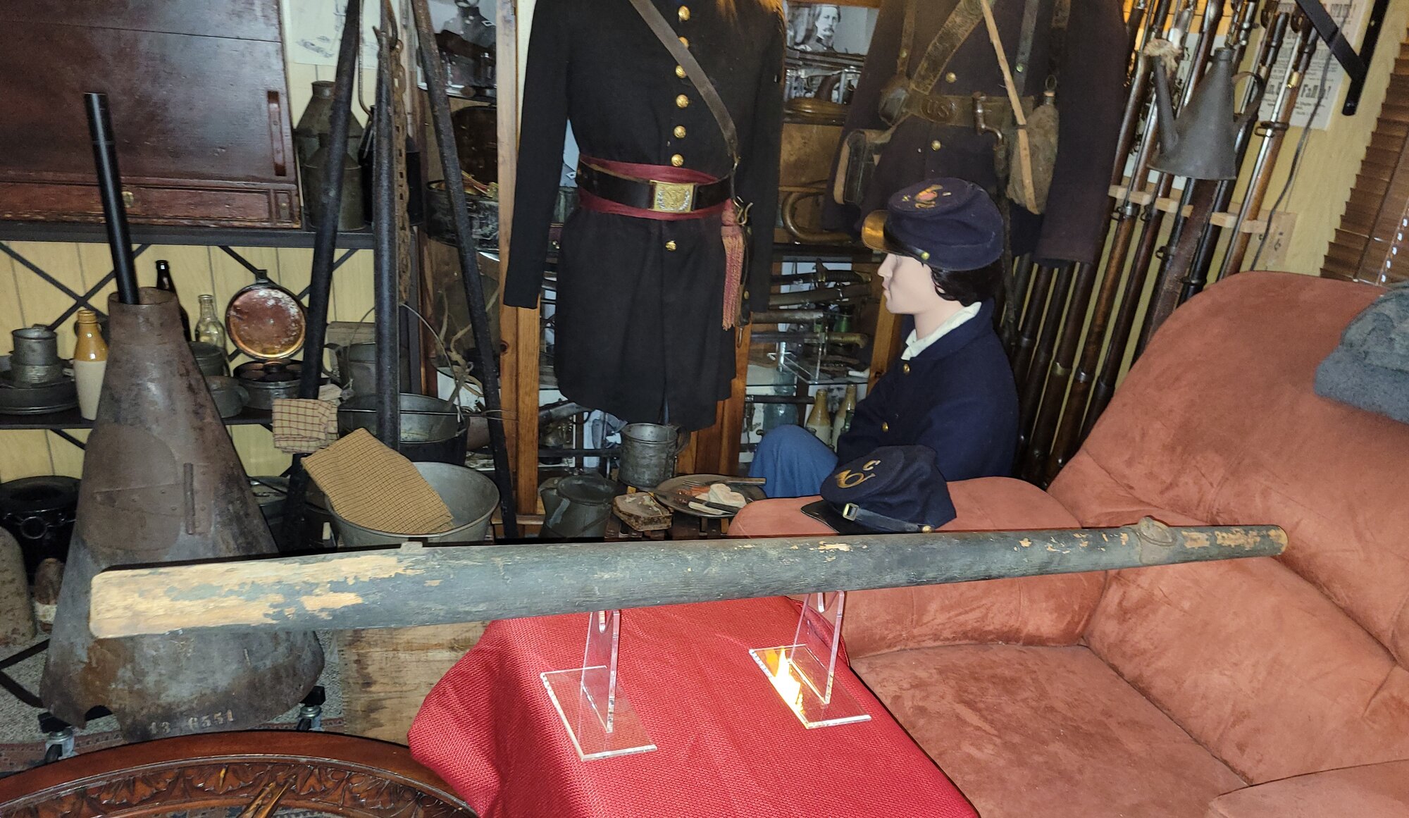

My artillery trailspike appears to be stamped CONN, which means it could have belonged to 1st or 2nd Connecticut Artillery? I'm not sure what cannon the 3rd used, or if there were any other Connecticut ligjt artillery battery's. I'm guessing there were fairly low numbers of Connecticut trailspikes, (as opposed to rifles, pistols etc in the thousands). My imagination has me wishing it was one of the ones in this photo from an earlier post showing 1st Conn light artillery with trailspikes attached.

It looks like there were three batteries of light artillery and two regiments of heavy artillery formed by Connecticut. Out of curiosity, do you have a full length picture of the spike? For some reason the shape is looking a little off to me, although I might just be tired and foggy brained at the moment of posting.
The handspike was made to fit the model of carriage it was used with. The obvious thing being the necessity of it fitting through the ring on the trail & providing proper leverage.
53" long. Excuse the mess in the background, I don't have enough room to get a better photo with all the clutter
You raise an interesting question that's been bothering me for awhile. How do you tell an original handspike from a repro? Wooden implements like trail handspikes, rammers, worms, etc. are hard to date. Items that were made for the CW Centennial now have some age to them and are almost indistinguishable from originals. To the best of my knowledge, original items were not marked in anyway.
I don't mean to cast doubt on your handspike; I inherited 2 sets of implements that I don't know if the original owner bought from Bannerman (like so much else) or made for the Centennial.
It came to me from the Ray Ritchie collection, and I took their word for it, as they had it displayed in the Texas civil war museum as original. I'll buy your centennial artillery implements, to go with a repro display cannon,,,what would want for them?
You could have the paint analyzed, just to answer your forensic question.
regarding markings, While I don't know of any U.S. issued ones that were marked, If it was issued from a State Arsenal (Early in the war, the States provided the equipment for troops going into Federal Service) it could have been marked. The Ohio Arsenal would mark nearly everything that left the Arsenal with "OHIO". While I can't speak for other states, Ohio's arsenal would stamp nearly everything.
