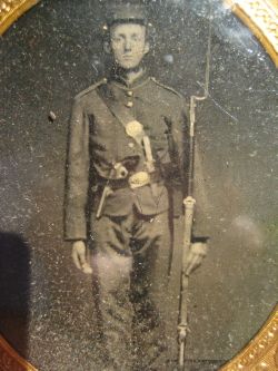

Yeah, what little I read yesterday said I should be fine scanning one time. But I really liked your story, as I think ours needs to come out of the frame and be cleaned as well. As you can see, there's a lot of dust going on. But, that's the thing I'm most not wanting to do, and feel a professional would help. Have to research more in Southern California, see who can handle this kind of job. Thank you again.

Warning: I never touch the surface of an ambrotype. I used to gently blow dust off of them with an artist air compressor, but even that is dangerous, as emulsion flakes can blow off. That happened once, and I have not done it since.
All I ever do with ambrotypes, and only if visual appeal can be increased significantly, is clean the protective glass, and if the image (emulsion) is on the reverse side of the photographic plate I wipe off the non-image side.
This site has some good advice on cleaning: http://www.phototree.com/cleaning.htm
I would just add that it is very important to not introduce moisture into a cased photo (or dust into a cased dag). If you clean the protective glass, dry it with a lint-free cotton cloth and then let it air-dry for a while just to make sure. Or you can get a can of compressed air at most hobby stores.
