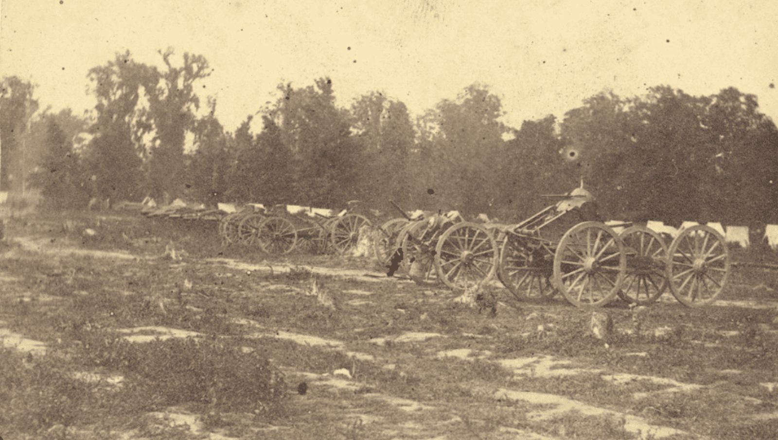

We've all seen photos of the smaller 8 & 10 inch mortars setup ready to fire. I found a great photo of a yankee mortar battery in camp with the mortars on their transports. This photo is from Post Hudson and shows just how they were transported to be installed in the breastworks.

I have to admit that when thinking about artillery, I very rarely consider the use of mortars or the role that they played. Ive always assumed that mortars were primarily used to destroy fortified positions, more of a siege weapon than anything else. I can't imagine that mortars would have been much use in a battle especially one where the lines were constantly shifting. From looking at the photos that you posted, I'm thinking that it must have been hard work and very time consuming having to move, unload and then of course dig them into position, I can also imagine that those transports which the mortars are mounted on must have taken some real punishment especially on rough terrain, how much did those mortars weigh?
Interesting photo. I have the same question about the weight. Do these transports look like something specialized, or would they have been used for other kinds of pieces as well?

Here are the weights. The transport wagons were specialty built for hauling these mortars.
8-inch siege mortar M.184144 lb.930 lb. tube920 lb. carriage
10-inch siege mortar M. 184188 lb.1,852 lb. 1,830 lb.
