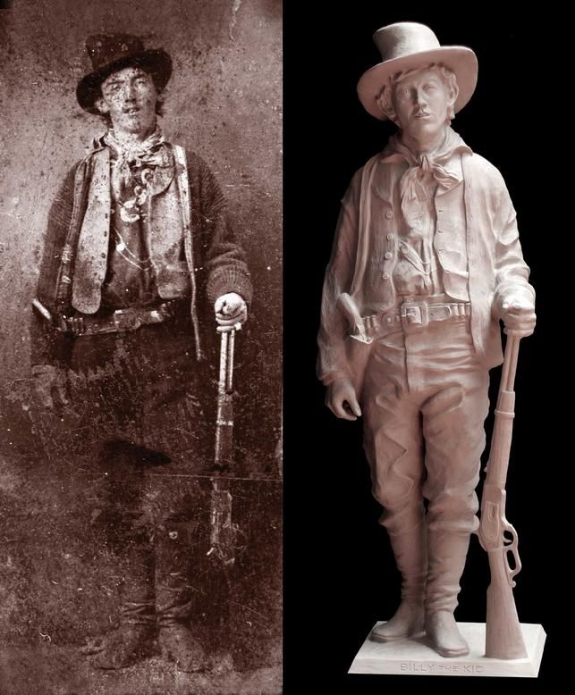

I would remove the base first and use a hand drill to make a small hole in one or both feet . Then glue very fine brass wire into the holes and temporarily mount the figure on a wood block with pre-drilled holes . After painting you can drill holes in your diorama base and push the wire into it . Secure with glue . I use this method on all of my figures and it works well . If you look at the cowboy I worked on ( it is an Andrea figure. I said Vallejo) you can see brass wire drilled into the horses feet on my temporary painting base .
Bases/stands is one of my pet hates, I think that 1:72 is the best scale for large dioramas but I hate the fact that I've got to spend time removing the bases from delicate figures. I've seen some excellent dioramas but some of them are let down by those unsightly bases. The problem is that the bases are useful for holding the figures during painting but then the paint work can be damaged when using a sharp blade to remove the base, what to do, remove the base first and paint or paint then remove base!
This is what I'm talking about . When I am done painting I remove the figure from the temporary base , trim the wire to about a half inch and mount on the permanent base .
