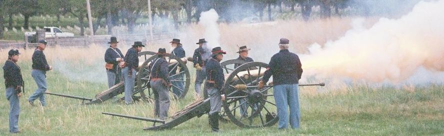

I am #1 on the right gun of the section. You can just make out my corporal's stripes.​
I do a safety lecture during our annual training & can attest to the fact that firing muzzle loading blackpowder cannons is a potentially life threatening activity. No enemy fire is required. The Stones River gun books show that I have participated in ~ 2,400 firings, so I have seen a thing or two. At a non-NPS event I witnessed a friction primer & jet from the vent go through #3 hand. Fortunately, it went through the muscle between his pointer & thumb. The skin grafts & burn scars are something to see, but he has the use of his hand.
As he was stepping out, #4's foot got tangled in Maypop vine that tripped him & fired the gun prematurely. #3 had gotten carried away with his authentic drill & had laid his hand over the friction primer after inserting it. That was a left over from linstock days that was meant to keep the priming from blowing away & was still part of the C.W. drill. Our modern NPS drill keeps #3's hand clear of the vent as #4 steps out.
Every time a fuzed round is fired there is a chance of a premature detonation. I have only seen it happen once near the muzzle of the gun. Nobody was injured, but it sure got everybody's attention. I have seen eight or ten shorts down range. Because fuzed rounds are so inherently dangerous, many artillery live fire venues do not allow them. Cannoneers #1 & #2 would be in particular danger. When I am not gunning, I am usually #1, so there nothing theoretical about this topic for me.
