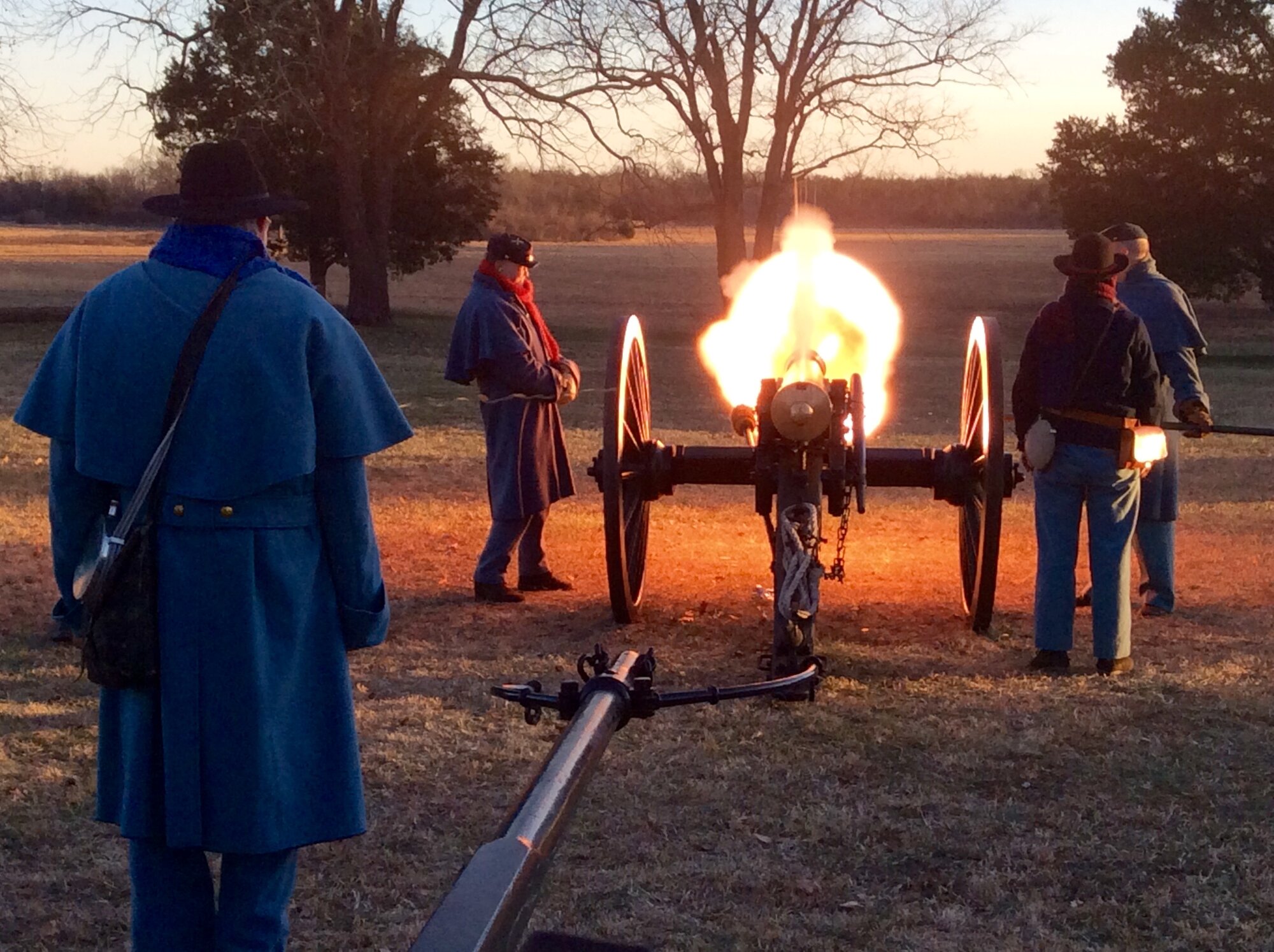

This sequence of photos shows a friction primer in action. The time lapse is about the blink of a eye.
The three stages of a friction primer ignition are visible in this image. The fine horizontal line is the kitchen match chemicals on the priming wire igniting.
The puff of smoke to the left is from the primer.
Jetting up from the vent of the 1841 six pound smoothbore is the charge in the breach going off.
By expanding the top of the jet from the vent & you will see that the primer tube is visible.
Note that no light has made it to the muzzle.
A nanosecond later, the streak at the top is the primer tube rocketing upward.
Look carefully between the wheel & gunner there
is the sine wave of the recoiling lanyard.

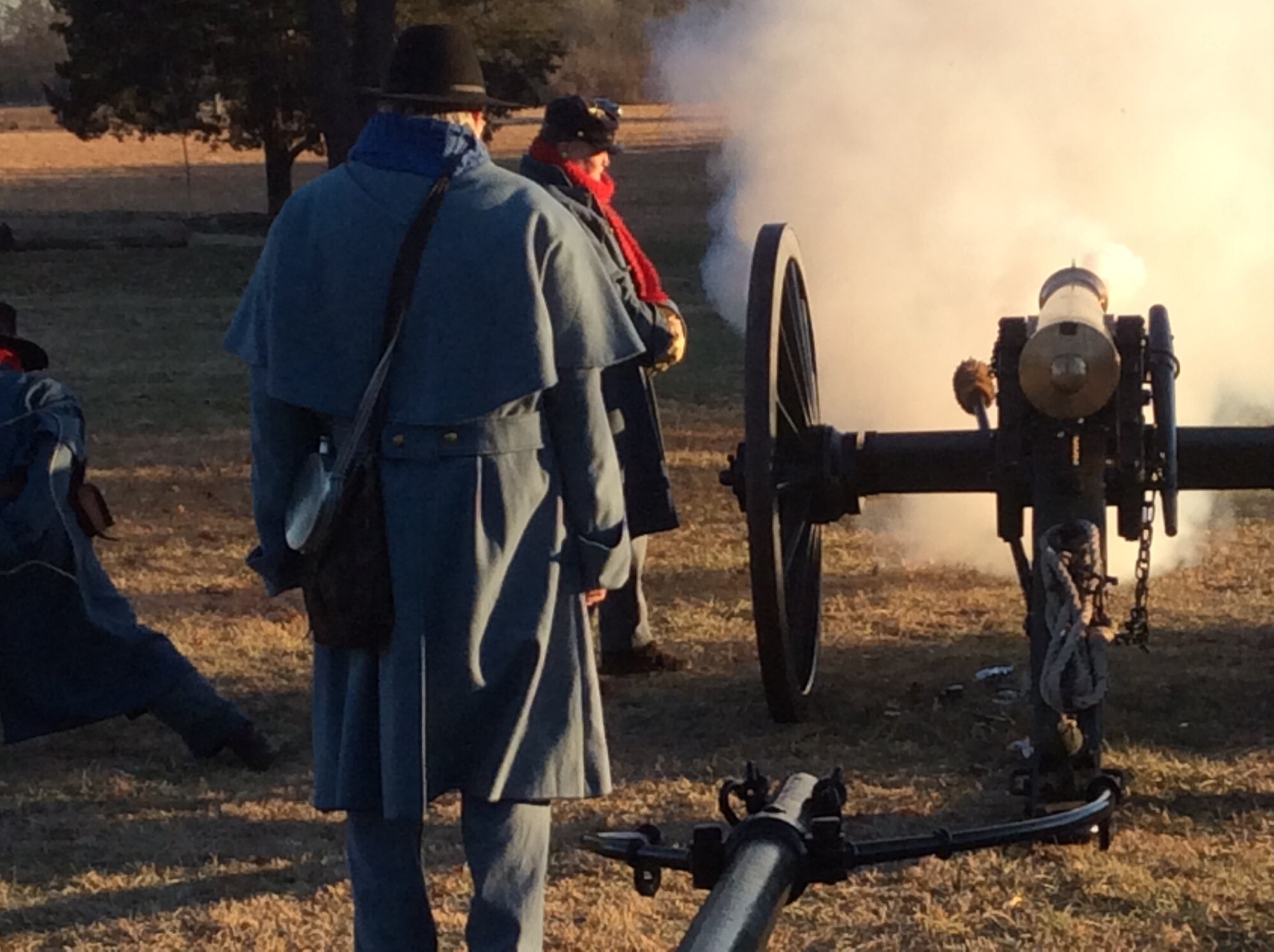

On the left the steep waves of the lanyard's recoil toward #4 is visible. The vent is angled slightly forward so that the primer tube would not land on the men or horses. Depending on the wind, they land all over the place.
The great plume of white smoke is all the visitors on the other side of the safety rope get to see.
Remarkably, I took these images with an iPad mini setting atop the limber box. Stones River NB living history volunteer gun crew.
