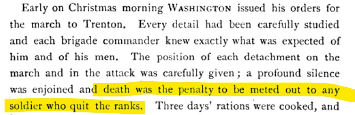

General Washington had called for "instant death" to those who misbehaved. At Trenton...

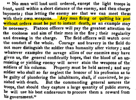

General Zebulon Pike's orders for the assault upon York, Upper Canada, in 1813:

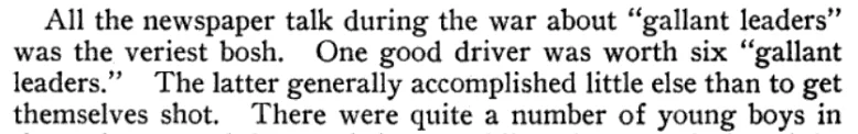

Col. Oates of the 15th Alabama...
"bosh" as in empty words, poppycock, etc.

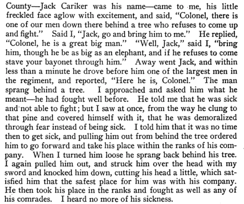

Regarding Chickamauga, Oates recalled...

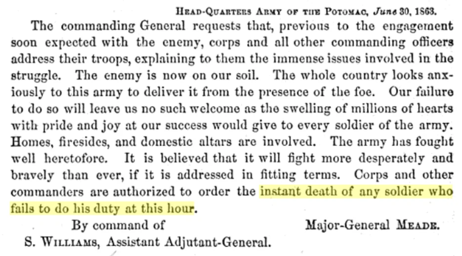

General Meade approved of instant death to deal with any misbehavior in battle, from June 30, 1863:
The veterans of the 155th Pennsylvania recalled on the reading of this Order from the Commanding General before marching that day, that some of the soldiers felt concern for their comrades who had straggled in the previous days and not yet caught up....

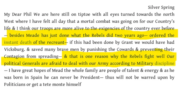

In the wake of Meade's standing orders, etc., Elizabeth Blair Lee, daughter of Lincoln's advisor Francis P. Blair, and sister of Postmaster General Montgomery Blair, and General Frank Blair, who commanded a division under Grant at Vicksburg, wrote her naval officer husband that it was considered a great turnaround in affairs...
