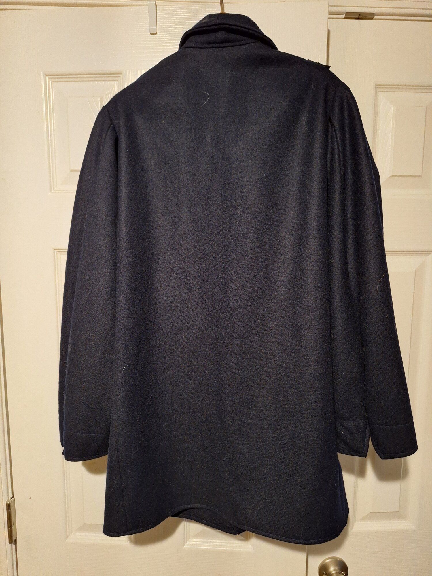

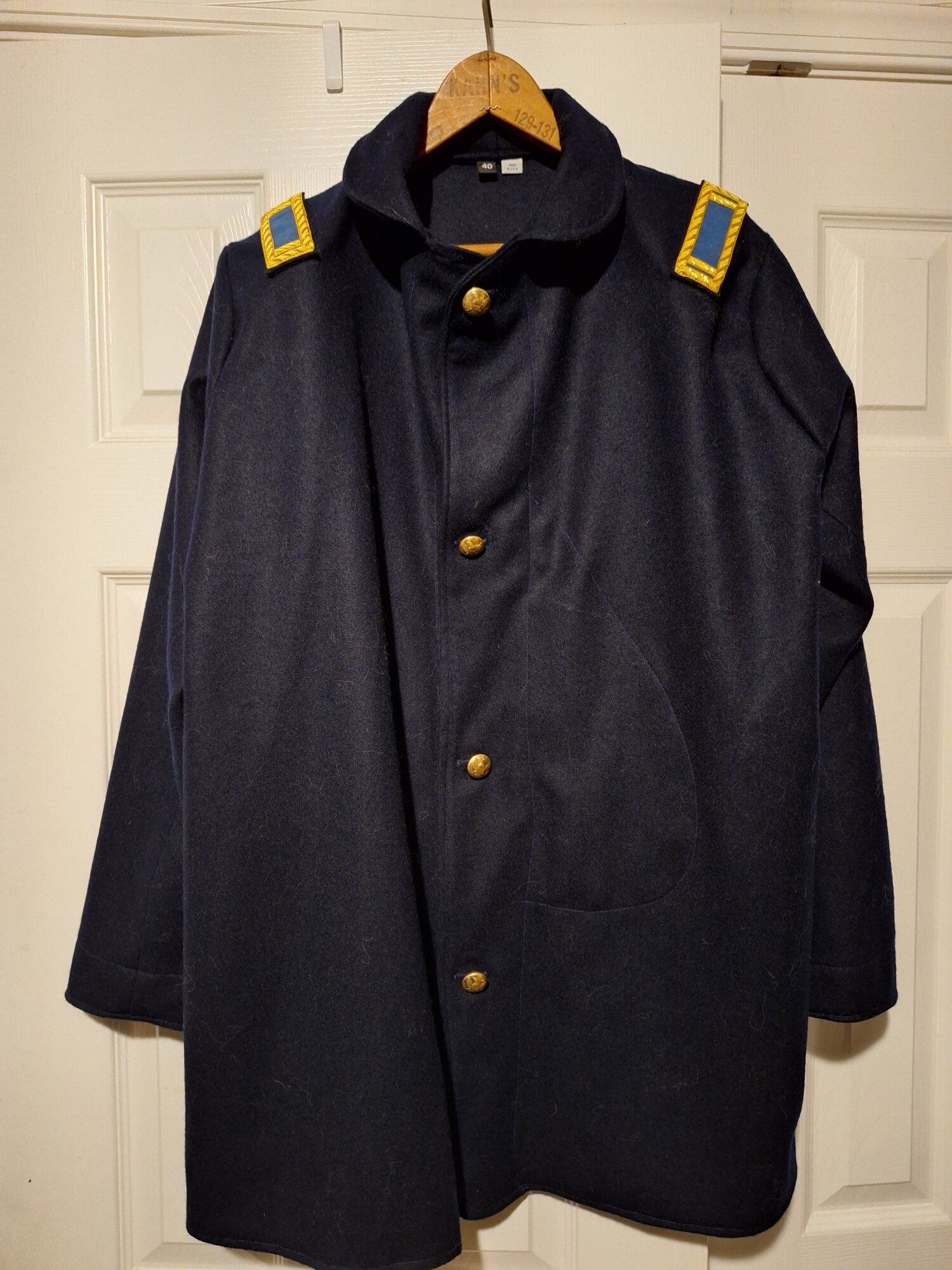

An old reenactor friend is getting rid of a bunch of his old gear, and offered me one of his fatigue blouses. It was free, so of course I took it. It's an enlisted fatigue blouse with 1st Lieutenant shoulder boards sewn on, never worn, made by the Regimental Quartermaster.
I know that Regimental is considered a mainstream sutler, and this is definitely an off-the-rack blouse, but how does it look? Are there any glaring innaccuracies? I was thinking of starting a federal officer impression, and this would have been a good start. Thanks.
Well the good news is the price is right. The typical sutler row fatigue blouses are the wrong material, wool instead of flannel, the wrong color which quickly fades to a purplish in the sun, and doesn't have any hand sewn features such as the button holes. Here is a side by side comparison of a typical sutler row blouse to a top quality blouse made by Wambaugh and White (top)
Now if your just starting reenacting in the ranks for mainstream events your blouse will work fine. To do a good officer impression, they were responsible for outfitting themselves, you'd want a private burchase blouse or frock coat. They wouldn't be wearing an enlisted issue blouse. Although I've been asked in the past to fill a Federal officer position and I added shoulder boards to my blouse but I rarely do Federal, especially an officer, and couldn't justify buying another coat.

It was free? Roll with it. Using an enlisted blouse and saving your private purchase officer's coat from damage in the field is appropriate. You have something to build on.
