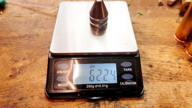

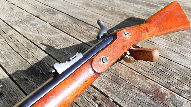

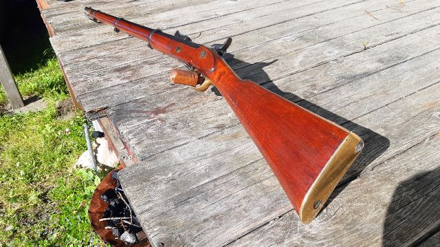

Got this P-53 recently and would like to tap in on what bullet to use. Idea is 100 meter shooting for numbers mainly, but will stretch to 300 on occasion (compete) too.
Was adviced by Brett to go Hay 568 bullet, and presume that´ll be a good call. What say the rest of you?

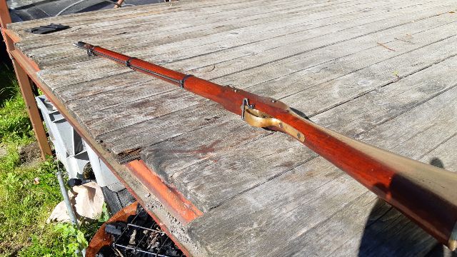

First of all you need to provide information about who produced this rifle (assuming it is a reproduction). I would also suggest finding the exact board dimensions. This is typically done with a set of pin gauges.The N-SSA website and message board has vast amounts of load data for these but each rifle can be different as to bullet type, powder type/amount as well as lube used. Welcome into the rabbit hole!
It´s a Tower marked original made in 1863.

quote; "It's a Tower marked original made in 1863"

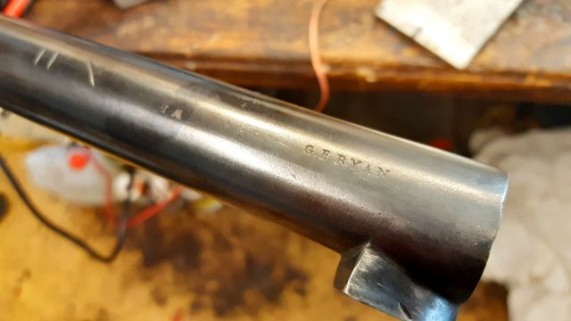

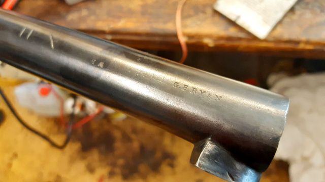

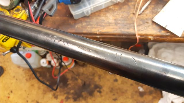

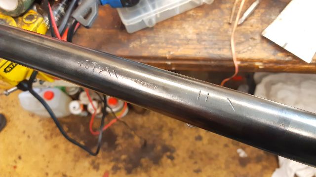

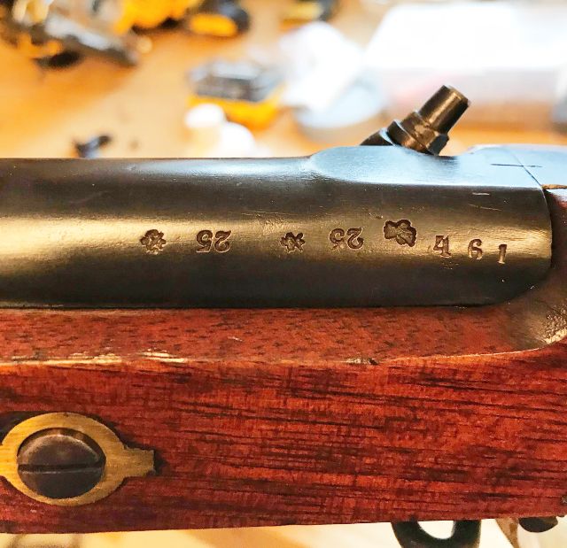

I'd suggest that you find the proof marks, and other marks, especially on the barrel. It is almost impossible it could be made in 1863 and be in this condition. Possibly a Parker-Hale, Petersoli, or Navy arms production and a modern copy.
As for shooting it, I'd also recommend the NSSA site for loading information
Impossible, not by far.

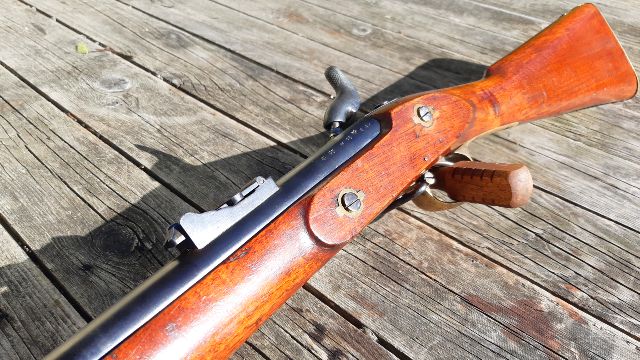

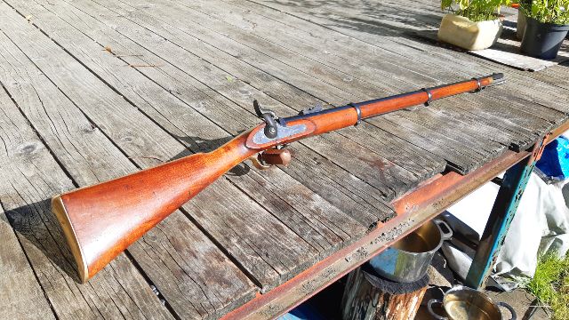

I state that it´s an original as i know it to be. It´s an Enfield export version, to my knowledge the exact same gun delivered for the US civil war, and yes it is in essence about new.
While the US civil war raged there was an uprising in Warzaw in Poland, and these men needed arms. So 900 Enfield export was ordered, bought and paid for and loaded on a ship that set sail for Poland.
Now. As that ship was about to enter the Baltic sea it got boarded by Swedish customs (the absolute south point of the country) as it was decided on that the ship had entered Swedish waters.
In short these 900 rifles got impounded, and there they stayed. For quite a while..
Then one day it was decided on to sell the guns off, which the founder of one of Swedens major newspapers did, Lars Johan Hjerta, and he did.. bar one.
The bar one being this rifle.
Nope. This thing ended up at Swedish regiment I-15 in Borås, not far from where i live.. and there it reached the wall of the officers mess where it came to reside....
When the new mess was built in 1914, one of the first things to enter was again this Enfield. Somewhere along the line though someone took the hammer off, i guess to spare the nipple, and that got misplaced as far as i know. We´ve replaced the hammer with another Enfield one of the time, and i guess all is golden.
Anywhoooo...
There the rifled hung ´til 2012 when I-15 was dismantled and the rifle followed one of the officers home. At HIS home in turn, again a wall hanger. Until last year when the officer in case called my good friend up who´s ALSO a former officer of I-15 ...knowing that my friend is into black powder. So. Rifled changed hands again, this was last october.
Now. Me and my friend are in charge of anything black powder at the club and he know´s that i´m into both US made carbines and rifles of the time as well as British and French made ones, the one day recently.. "this Enfield is really way more you than me, how a about a barter? A trade?"
So i handed him my Gallager carbine and all is good, i guess. Since i´ve been diving into what gives as far as making this rifle perform.
As it used to belong to this good friend of mine, that has fired it, i wanted to be absolutely sure of the conditions of threads and what not as i plan to do the same.
These days we look after these old war horses as they were certainly NOT back in the day, so using it sparingly to me is about living history. Wings of time if you wish, and i truly regard myself the caretaker of it more than the owner. Ditto for for instance my Whitworth 451 military match.
As it turns out, "very good working order" would be an understatement.

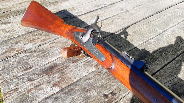

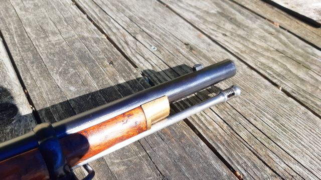

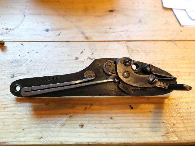

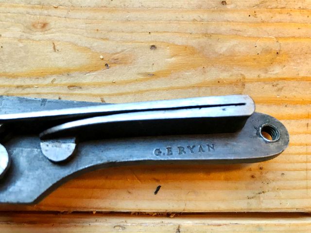

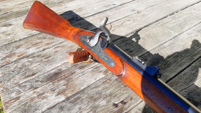

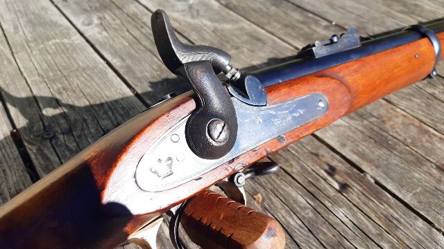

..n yes. The other side of the lockplate certainly carries the Tower marking coupled with 1863. As "impossible" as it might strike anyone.
So uhu. Be that as it may.This is an original Enfield export made in 1863, as "impossible" it might be seeing its condition (well it´s basically new so.. no argument and very understandable i guess). No matter, here it is and you´re looking right at it.
Nope.
Not a "virgin", while close to it why i reason as such that as it´s not... it is ok to use it as long as it´s done with judgement, insight and knowledge.
But yes. This is how these rifles looked, to the color n number, as the boys of the US civil war took delivery. Here it is, the reference. :smile coffee:

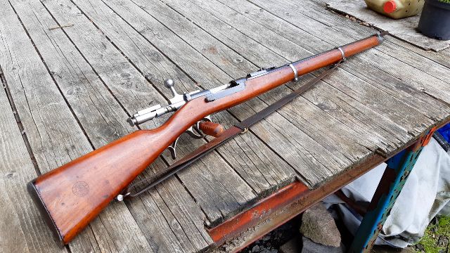

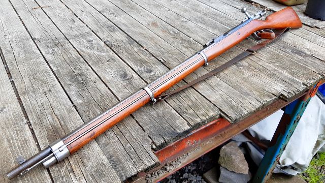

...like this Felix Escoffier 451 rifle. Absolutely wonderful piece of kit, sporting all of the "Whitworth trios" findings while, of course, "keeping it French". Thus 1 turn in 21 inches.. of course.. LOL. None the less, 45 caliber and what have you. In the pic good friend Patric going at it.

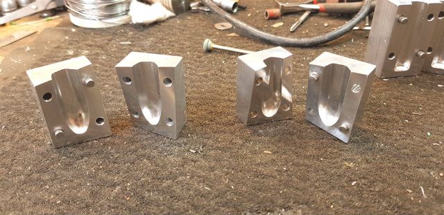

Like for instance these for said Whitworth rifle. Thus... albeit we could cut molds out the fabled i wanted to ask others what´s their preference :help:
Point in case being that i´ve been told these Enfields can be VERY picky on fudder, and that´s why i asked.

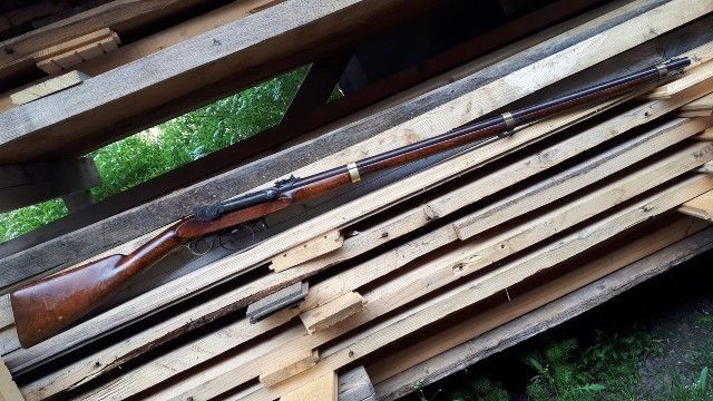

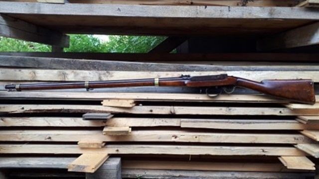

If there´s one of them i cherish from around here it´s the m/1851 chamber loader for the Swedish navy.
An absolute cannon of a rifle, in approx 16mm caliber and will take an EASY 120 grains beneath that 620grain pill. REAL high build Q and due that, to a degree at least i suppose, reasonable accuracy too.
Here friend Stefan going at it at the range. This thing, when loaded up to the brim, kicks like a friggin mule. But have to say, still rather accurate. If my info is correct developed to shoot far across open water.
Yeah, and yes. We cut the mold for that one too.. :D

To give you an idea. I wanted a Kropatschek 8mm in 8*60 it being the "last dying scream" of blackpowder. So i dug a nice one up down in France that i imported up here (in other words within the EU)
A nice one as it´s a permit gun to me. It being an 8mm "10 shot" (takes 8 in the tube, one on the lifter and one chambered) and it´s using a metallic gas tight cartridge = permit.
That means that it takes up space on my equivalent of what the Brits call an FAC. Firearms card. The permit is for life though, once through the process involved you´re good. Made in 1886. This though a revised version making that she runs "both ways". Ie; blackpowder and smokeless both. To me though it´s about blackpowder (and duplex to an extent).
Irony, for lack of better words, is that most your side of the pond ain´t even aware of the Kropatschek, which was really a mile stone in rifle development (..which the French in turn "transformed" into the 8mm Lebel - worlds first smokeless gun en masse, and so the story goes..)
BCPR is alive around here too though, while for the most part on a smaller scale. Popular guns that aside are often the various US made carbines of the civil war, many were exported over here for for instance the Franco/Preussian war of 1870-71 and are thus around ample. Ditto for revolvers, i believe the French bought like 30k Remington revolvers for said conflict alone out of US storage.
So yes. The originals are used way more often around here than in the US i´d say, no matter if handgun or long gun. In many European states in turn the USE of these guns are under permit, to us up here in Viking land.. not so much. So.. we take care of them and we shoot them every chance we get.

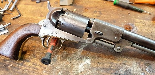

Knowing i´m straying here, an original Colt 1860 Army n me at the range. 30 grains of Wasag underneath a J&D pill. Yep. It being in good working order it can sure stretch to this day, and rings steel at 50m with ease.
That gun is exempt to me.
Lovely gun though. Photo courtesy friend Patric Rosberg.
Got this P-53 recently and would like to tap in on what bullet to use. Idea is 100 meter shooting for numbers mainly, but will stretch to 300 on occasion (compete) too. Was adviced by Brett to go Hay 568 bullet, and presume that´ll be a good call. What say the rest of you?
Speaking as an American where we do not recognize the authority of the crown, it is perfectly conceivable to get the Enfield shooting extremely well with "Burton" style minies. In the US, there is a competition shooting organization called the North South Skirmish Association. We compete with rifled muskets and other American Civil War arms, and that includes artillery. Our competition is all shot from the offhand position and blends accuracy AND speed, so extensive "bench rest" techniques can be very counterproductive as can "historic" ammunition. But back to the "style" of minie, there are a number of styles of minies that have been devised over the years and some shoot better than others depending on a number of variables. . . .
The .568 bullet and cartridge was used by Rifle Volunteers in NRA(UK) competition in the 19thC. However, here in the UK 'historical' ammunition doesn't feature in competition today, despite a rise in recent years of interest in the Pritchett bullet and cartridge.
I shoot an RCBS Minie with a shallow base cavity which suits my original Short Rifle with 1 in 48 twist. I'm using a larger charge than will often be seen suggested; 80 grains of Swiss No. 4 (1.5Fg) - but most of my shooing is not at short range. Besides short range shooting (50m offhand / 100m prone) the MLAGB have competition for Enfield rifles at 200, 300, 500 & 600 yards; 200 is prone and offhand, other distances prone - the military sling is the only support permitted. This year I was 2nd at 200yd prone, 4th at 300yd, and won 200yd offhand, plus 500 & 600yd prone.
For anyone not familiar with shooting the Enfield, then Bill Curtis' short treatise on Managing the Enfield may be of interest, covering the rifle, equipment, ammunition, shooting, sighting, cleaning and bedding.
David

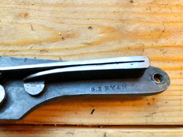

As myself and others have said in other threads, be careful with these 'export' Enfields. It looks a fairly standard 'Type 3', but without 'doughnut' screws on the bands. They are not government inspected and many are not to the same standard as the issue rifles. Most were made in Birmingham, like this one - Deakin the barrelmaker is Birmingham based as the proof marks show - G.E.Ryan sounds very Irish, but the Irish gunmakers often had English subsidiaries and works. However, none bear government (Enfield) inspectors marks. The parts are sometimes not interchangeable. Any serial numbers on the barrel are usually done for the contract and are rarely recorded. The 'Tower' on the plate was common for parts assembled from different makers, with no V.R under the Crown, but the date is likely to be correct and, as such, was likely destined for America originally.
From reports, the shooting can be quite erratic, but that is usually from old and used (and abused?) examples. Even government inspected arms - most of which have seen some service - shoot erratically today. (The issue ones are quite rare as most Type 3 and 4 were converted to Snider breechloaders) I would hope this one doesn't. Good shooting!.
