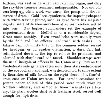

From James Shouler, in the 1880s, a simple description:
His mention of the general disuse of sashes in the field by officers is also mentioned in the excellent book by Thomas Publications, "Union Army Uniforms at Gettysburg." If I remember correctly, Gen. Hancock informed the painters of the Gettysburg cyclorama that sashes were not worn on the march or in battle, etc.
