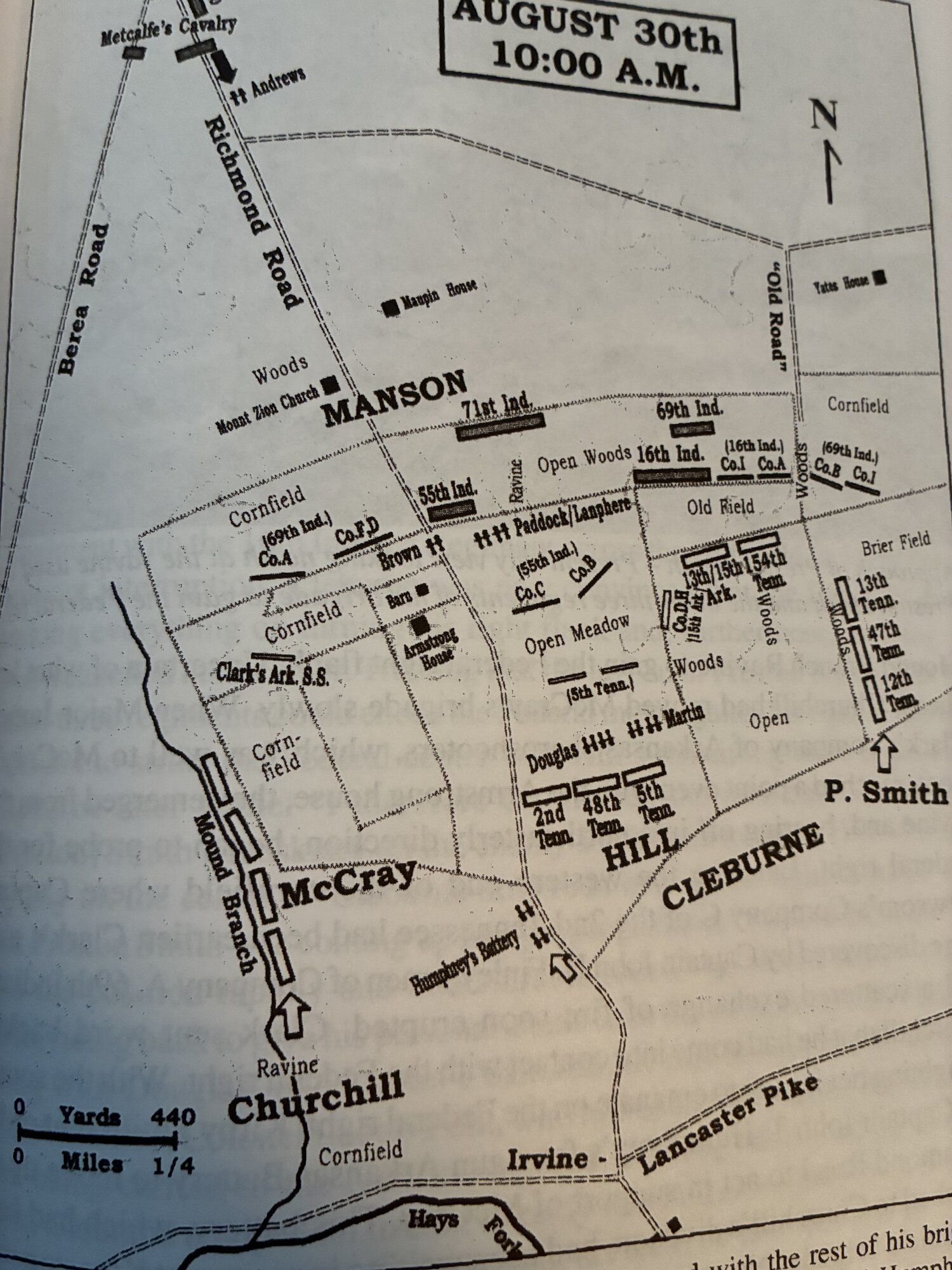

Photo is of Churchill's draw at Richmond, Ky. Showing a stream ravine located in the second line of trees.
Thomas Churchill used the reverse slope of this ravine/ draw to conceal the movement of his division of Texans.
They popped up on the Federal right flank- and the rout was on.
